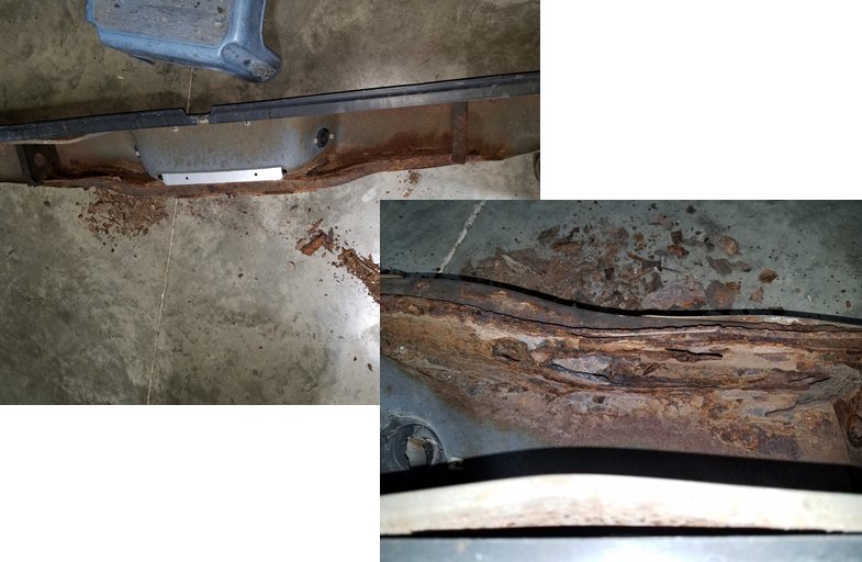

    If I had a garage, I'd totally take that home and put it away for when I got a new job and some excess money to build it up as a perfect little Baja explorer with a commercial shell on the back.
    It's got rust. Don't do it.
    Eh, same problem as the tent on the Flippac - it's not a 4 season tent. Snow will make it collapse, you'll lose a bunch of heat without a good heater, etc.

    how bad is it?
    there were not much for pics of it

    Every Tacoma has some small rust that’s 20 years old

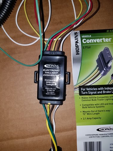

    A few days ago I posted about my Amazon Warehouse Reese Class III hitch score ($98.00). Today, got the wire harness installed. Bought an Autozone conversion kit type for $24.00
    Overcomes LED and independent brake/turn signal bulb issues.
    Dammit, bumper's gonna need some touchup paint before I re-install it. :D

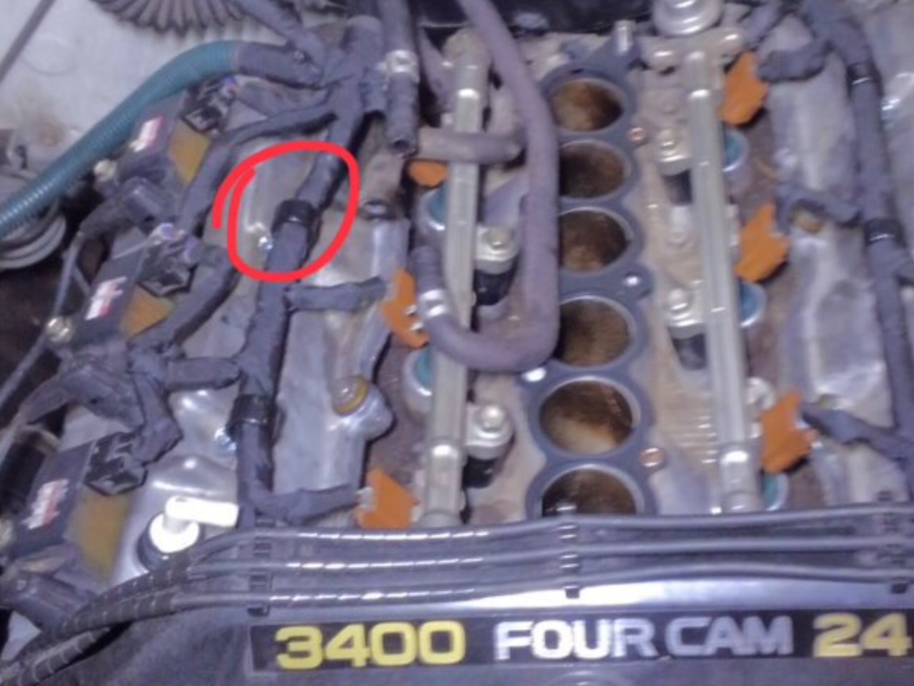

    When you reinstall the throttle body in order for the throttle body bolts to tighten,the new metal wire loom tab probably will need to be hammered down or
    a pair of vise grips to flatten it just a little because it might actually hit the Lower part of the throttle body. You will understand when you get there. FYI.

    Yeah I hit it with a plastic hammer to knock them into a better position. :)

    That back passenger side wireloom clip in particularly will be a small issue hitting the throttle body under side, but will need a little bending flat to make the extra clearance to fit.
