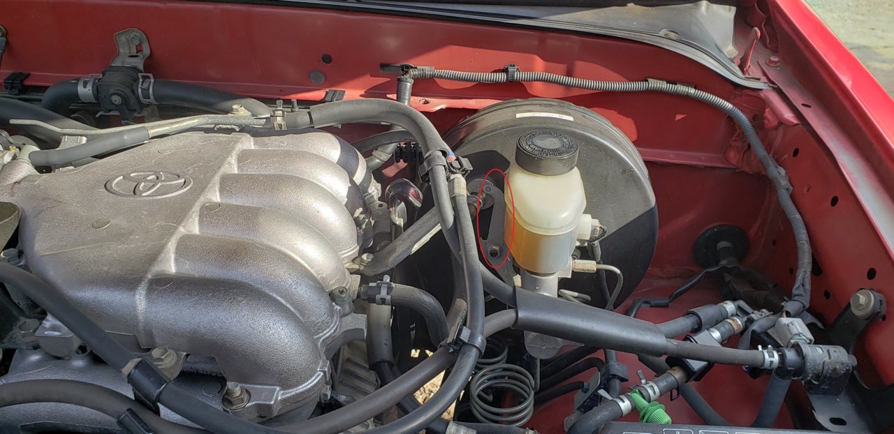

  1. Jan 20, 2020 at 11:44 AM
    JBTacoma
    JBTacoma Well-Known Member
    Feb 16, 2015
    #148844
    11,118
    Jeff

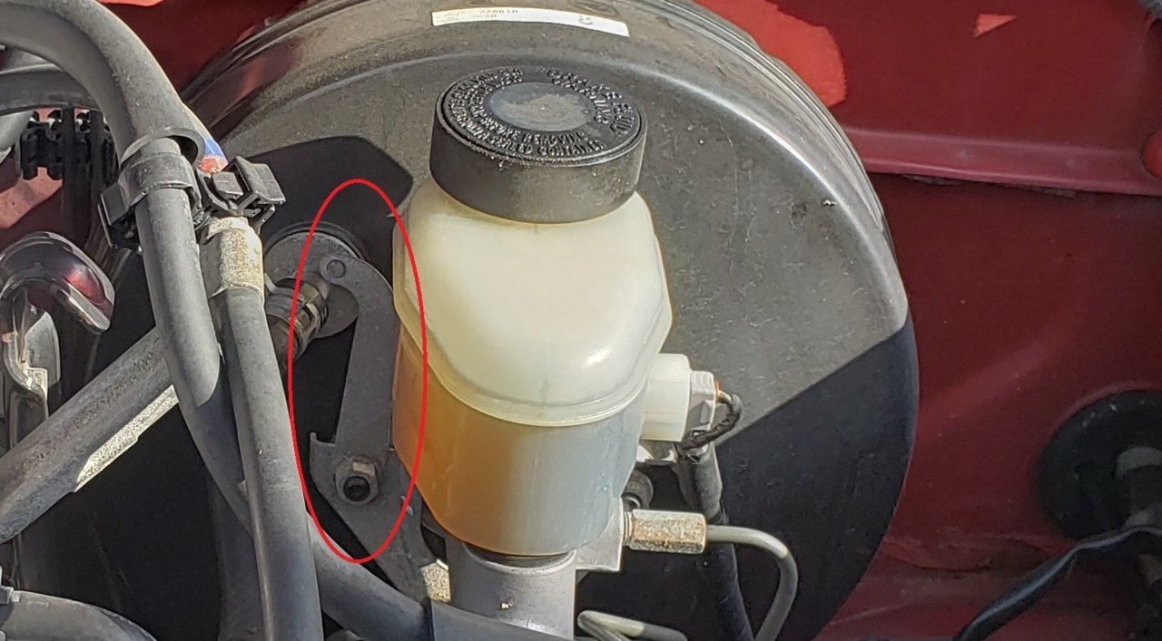

  2. Jan 20, 2020 at 11:53 AM
    Phessor
    Phessor Well-Known Member
    Feb 15, 2014
    #123156
    3,600
    Hmmm, I think I need one of these. I have had issues with mine leaking there in the past.
    Who makes it?
