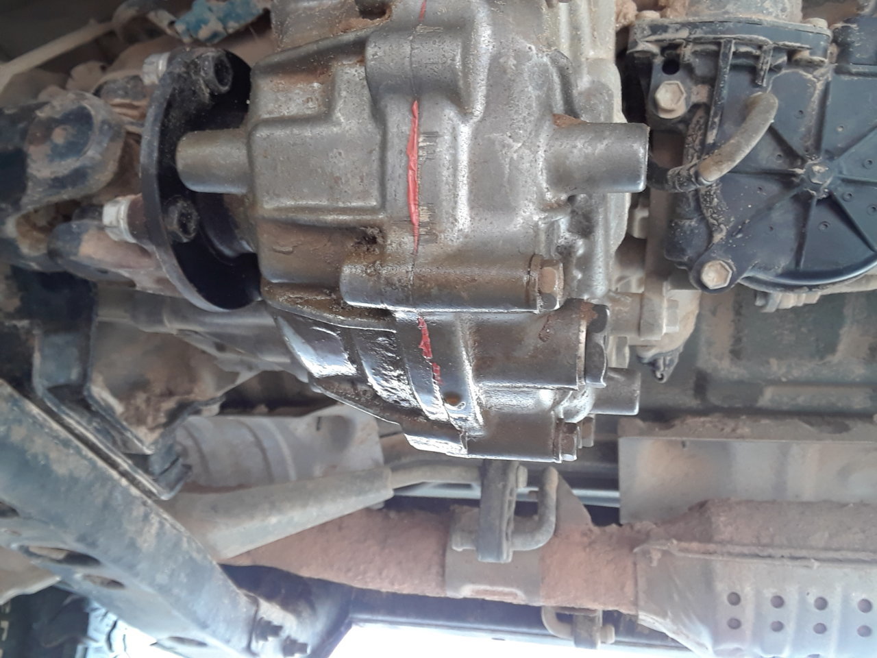

    What do you mean "flow"? I mean, we saw the crazy bright white on the towers from the mirrors...
    Yep, that's gear oil from the transfer case.
    The seal you'll want to replace is Transfer Case - Front Drive Shaft Inner Oil Seal (90311-41012). You'll also need new stake nut, since once you stake it (and unstake it), Toyota recommends new - Transfer Case - Front Drive Shaft Stake Nut (90179-22016). I've only found these at the dealer, but they are only a few bucks.

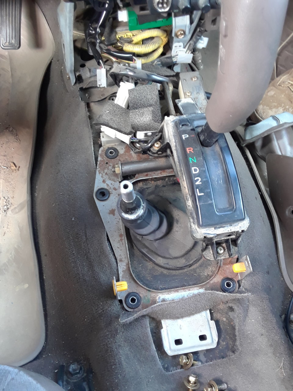

    I'm wondering what caused it since the front output shaft rarely moves. I'm thinking breathers got plugged, so I took apart my center console today. Breather was caked in mud.

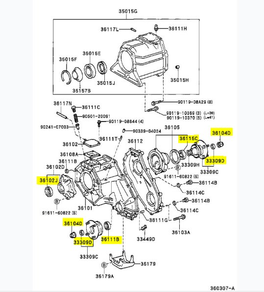

    Seems a few people are having transfer case leak problems... I have a Tcase seep as well. Just ordered all the seals and stake nuts today.
    I posted this in my 4x swap thread... but maybe it'll help here too.
    During my 4x swap my intention was to replace the input and output seals on the Transfer Case before I installed it. My local Toyota Dealership didn't do me any favors when I went to them to order the seals. They got me duplicates of one of the seals and the other seal they gave me was wrong all together. So, I decided to roll the dice and just go with the Tcase as is, and install it.
    Since the swap, my Tcase has started seeping oil. I'm not 100% sure if it's the seals or if it's the fact that I didn't allow the gasket sealer to cure enough before I torqued the case back together (when I had it apart to do the work to install the twin sticks).
    Since the gasket sealer is a question, I'm going to have to pull the Tcase to re-seal it. If I'm going to have to pull the Tcase, I'm going to go ahead and replace all the input and output seals. I sat down yesterday and figured out which seals I'm going to need... and was able to actually find the part numbers.
    https://youtu.be/8YuY6rv1hkE
    Here's a good video from @Timmah! that gives a bit of info about what's involved in one of these seals.
    Here's the parts diagram I went off of.
    Here is the page I got the parts numbers off of. This page allows you to go to the parts diagram and click on the part you need. When you click on the part, it takes you down to the part number. You can add the part to your cart and order it from this page.
    https://parts.toyota.com/a/Toyota_1...SFER-CASE--EXTENSION-HOUSING/674460-3609.html
    I found McGeorge Toyota was cheaper though. So I'll be ordering from them.
    https://toyotaparts.mcgeorgetoyota.com/
    Parts numbers are as follows
    Input seal = 36102J - Part Number 90311-40007
    Front output seal = 36111B - Part Number 90311-41012
    Front shaft seal = 33309D - Part Number 90312-23001
    Front stake nut = 36104D - Part Number 90179-22016
    Rear output seal = 36115C - Part Number 90311-41007 (Replaced by 90311-41020)
    Rear shaft seal = 33309D - Part Number 90312-23001
    Rear stake nut = 36104D - Part Number 90179-22016

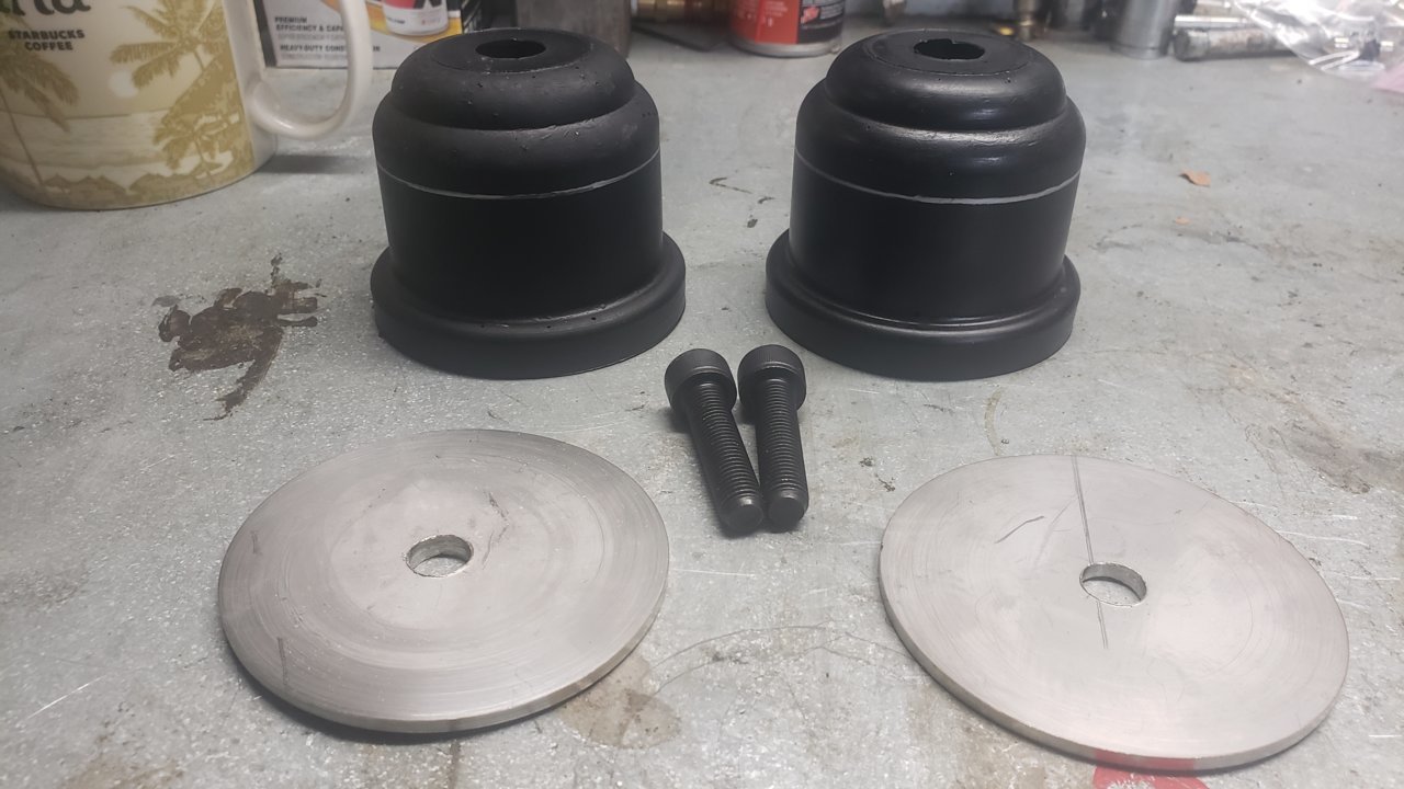

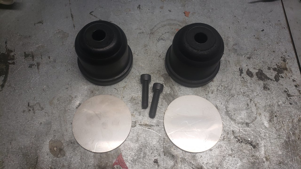

    Did some tinkering on @RobertsT4R today after work. Not big progress, but progress none the less.
    Cut some @Wheeler's Off-Road Inc super bumps down to 1.75 inch (tall). Mounted them on some 1/8th (thick) stainless steel plates.
    I've been running this set up on my truck for over 6 months and it seems to be running (and holding up) perfect. The bumps have stayed in good shape. I have just enough travel before bump, and they haven't cracked like full sized super bumps tend to do on our 1st gens.
