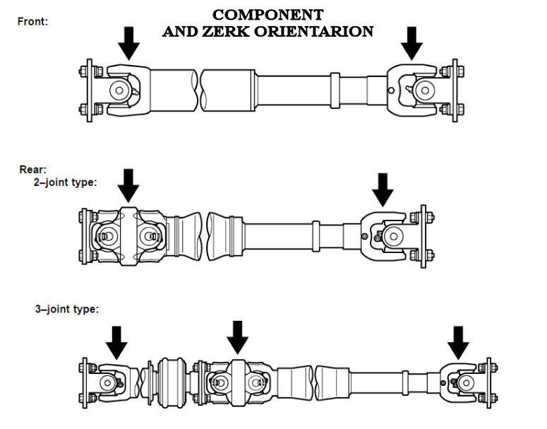

    I was told you want the yoke end things Lined up, like #3 I guess
    I’ve never paint penned :anonymous:

    Yea you want all the unjointed to be timed to one another or you end up with bind.
    In all reality the first and last u joint are the most critical to this
