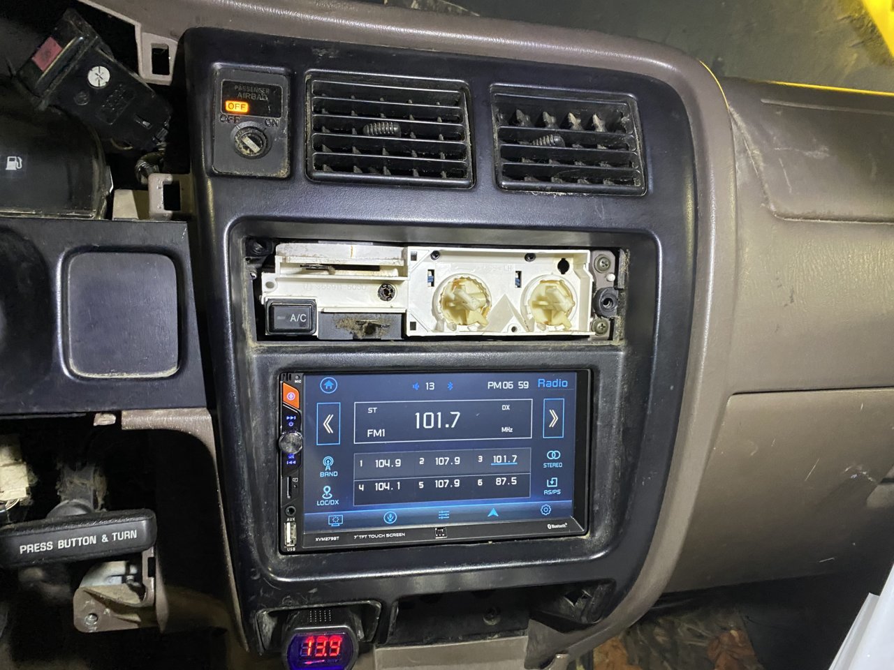

    Put the hood back on after chasing down a wiring short in the engine harness. 210 miles trouble free!! Starts every time, runs pretty good. Got 20.2 mpg on last fill up.
    have to figure out a rough idle issue, along with low power at lower rpm’s.
    I have new plugs to put in it, and plan to put a new set of plug wires, along with a new valve cover gasket. Gonna clean the valve cover up really good and may even paint it.
    Other issue I am chasing down is why the stereo doesn’t always come on like it is supposed to. It’s a Dual brand touch screen from Walmart. Sometimes it works perfect, other times I have to unplug/replug it to get it to work right.
    I really like the stereo cause it sounds good and was only $70 and fits excellent.
    I still have to install the amp and will be building a box for 2 15’s or 18’s in the coming months. I would like to have the 18’s. Won’t take a lot of power to have a good bass hit with those compared to 10’s or 12’s.
    oh, I also have to fish out one of the heat and air control bulb plugs. It fell behind and I can’t quite get ahold of it.
    anyone know what size bulbs it takes?
    hope everyone has a good day/weekend.
