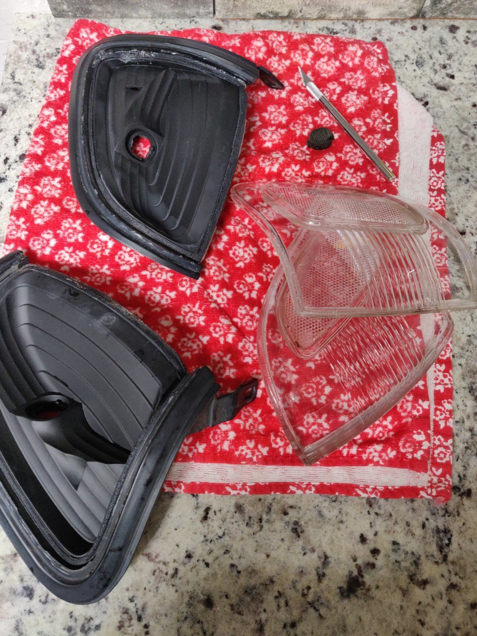

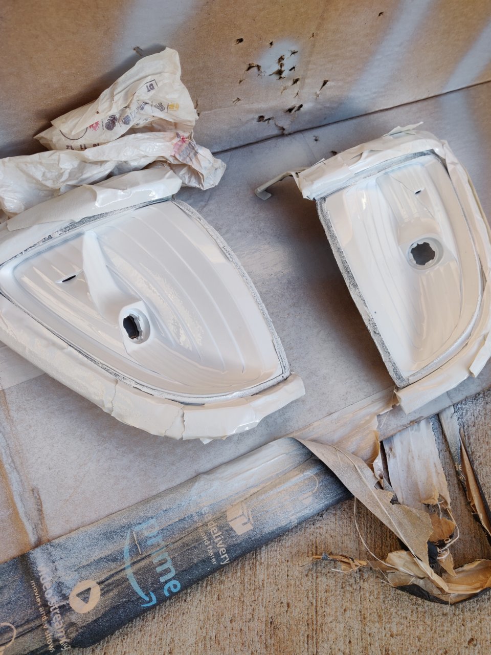

    Tearing apart and repainting corners to white cause i got bored :alien:

    Nice!
    What did you do for prep and what paint did you use? I need to repaint mine because the white paint I used a year or two ago is finally starting to flake off of the chrome around the lens.

    For prep i ran it under the sink :D.
    Just used some 2x white krylon i found at walmart, we'll see how it holds up, im not too concerned. If you are painting over chrome i would for sure try to do some light sanding on the chrome to help the paint adhere a little better!

    Did you just bake those like headlights to get them apart? I remember reading that some start melting at lower temperatures.

    The original sealant was so shitty that all i had to do was pull on the lenses with my hands and they came right off. These are ebay specials so guess im not surprised :rofl:gonna reseal with some retro rubber

    Pretty badass man. I tried it one time but i cracked them. I said fuck it

    Hit it with some steel wool pad to scuff the chrome plating. Use a self etching primer and then the paint. Let dry between steps at least 30-60 minutes. Should come out pretty nice and last a good while. Remember to put a dab of grease on the base of the bulb to prevent corrosion and help the socket last longer.

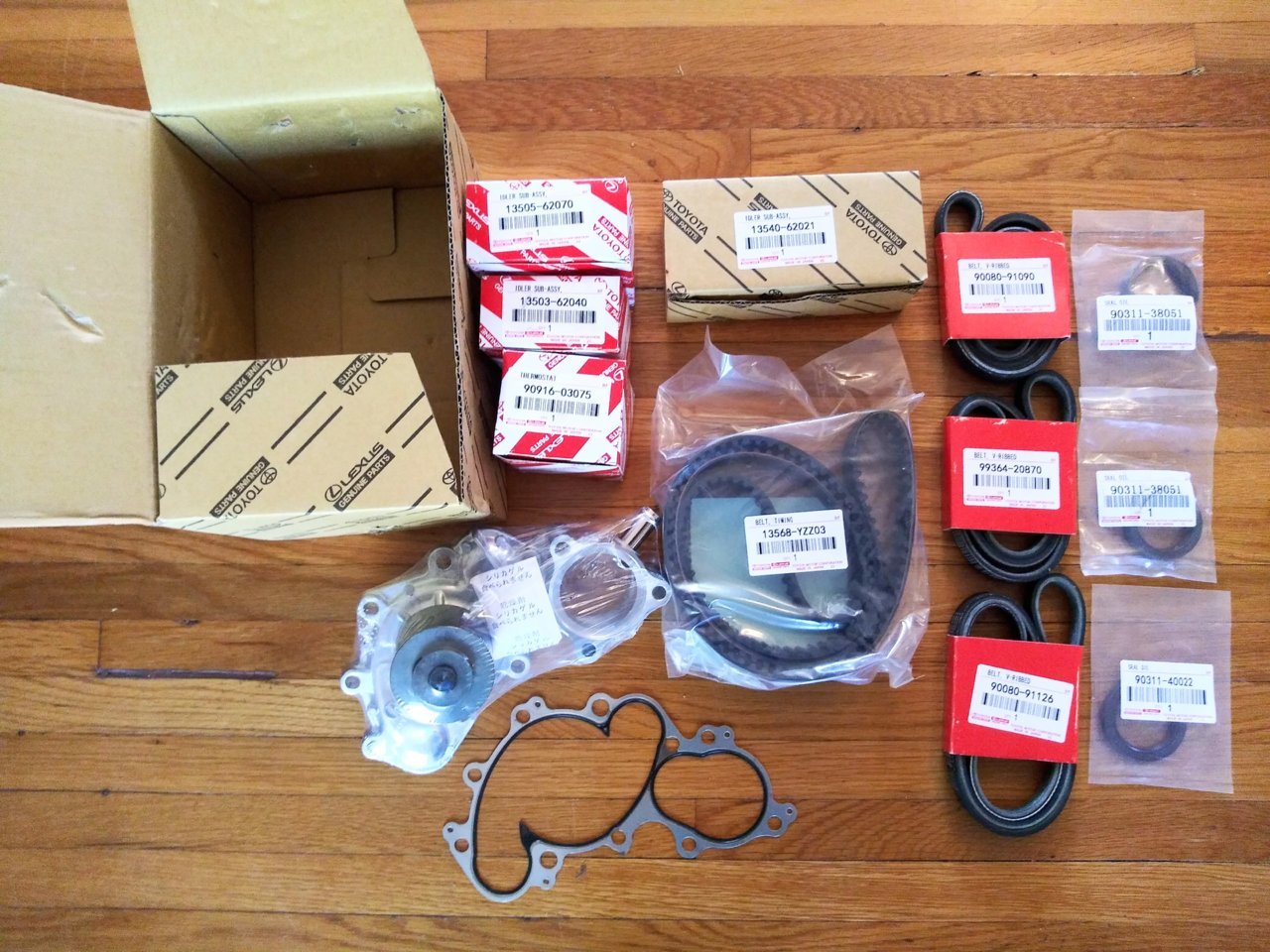

    Looks good! Nice kit. Looks exactly like the one that I ordered and installed.

    Thanks, yea I was a little wary cause its ebay and all...nearly bought the aircabinman one because it's tried and true, but this one popped up locally for considerably less $$$. Put it on my credit card so I could dispute the charge in case they sent me a bunch of cheap aftermarket parts instead, but it turned out to be a solid deal on an OEM Toyota timing belt kit

    At the time I bought mine, I actually paid more for the kit than aircabinman because it looked like more parts were labeled Toyota so I had a better instinctive feeling about it. Also, I didn't really know much about aircabinman. Meanwhile, aircabinman has gone up to be one of the higher priced sellers. We all know he is enjoying a lot of free advertising from TW.
    It think it is good we have some variation in suppliers and pricing. It keeps the parts scene competitive -- as it should be.

    Definitely. Yeah a couple years ago the aircabinman kit was considerably cheaper than it is now, but especially on ebay people are inclined to pay more if they're confident in the seller and his history. Which I get and would've done but in this case it worked out with the less expensive kit.

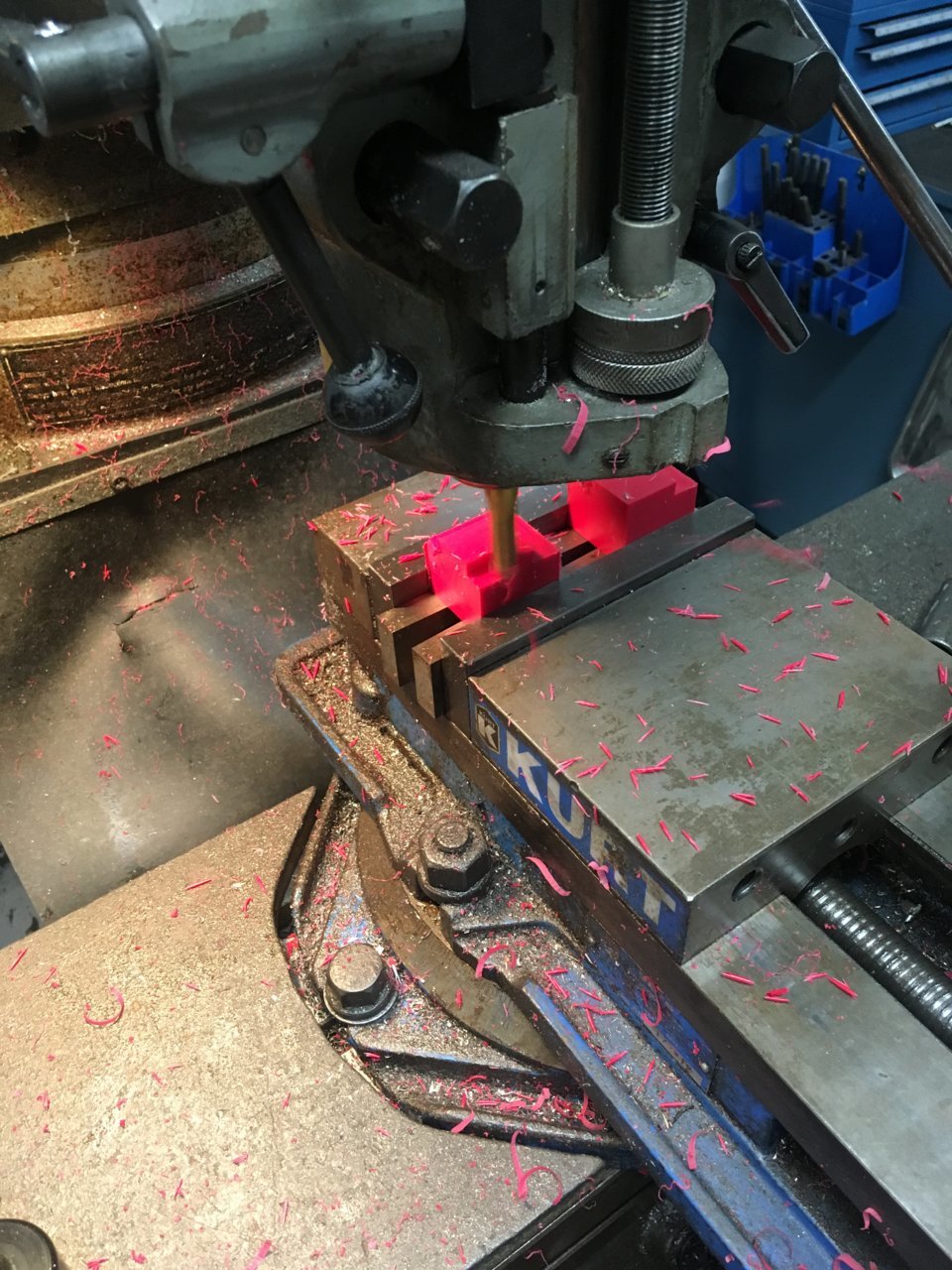

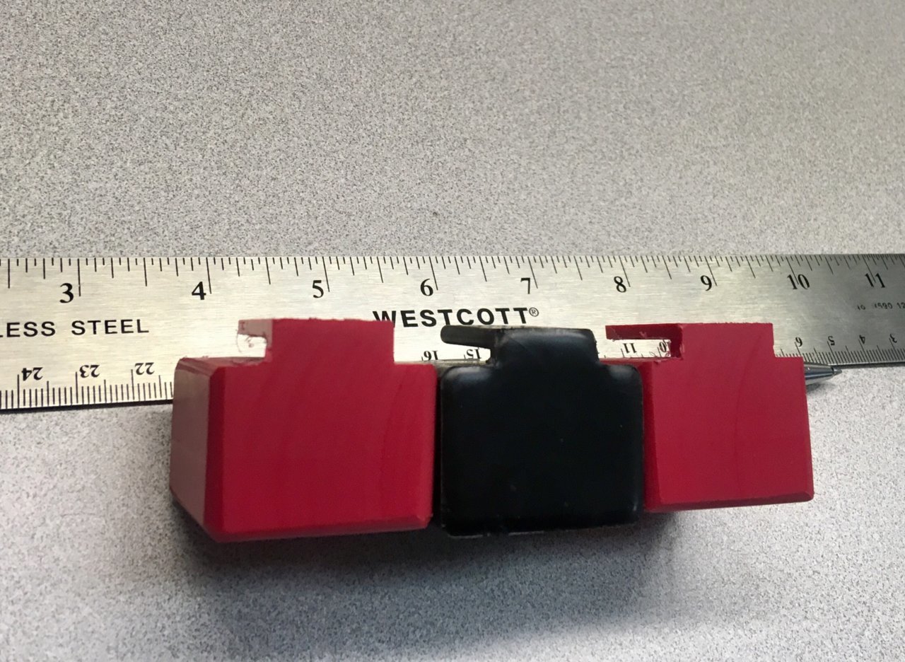

    I lost a body mount, so A new one was started out of Delrin.
