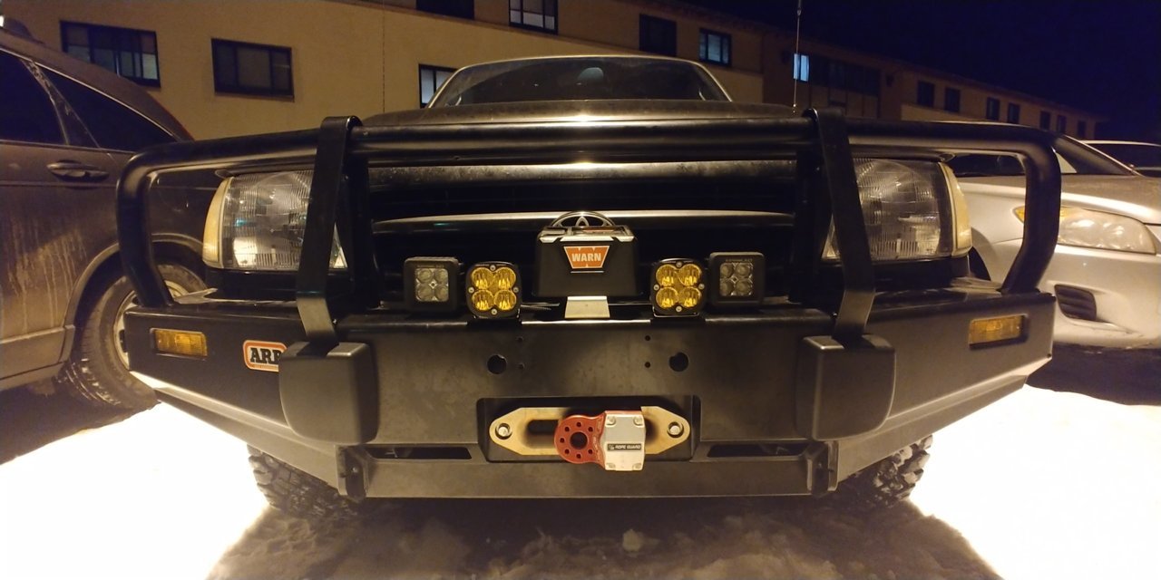

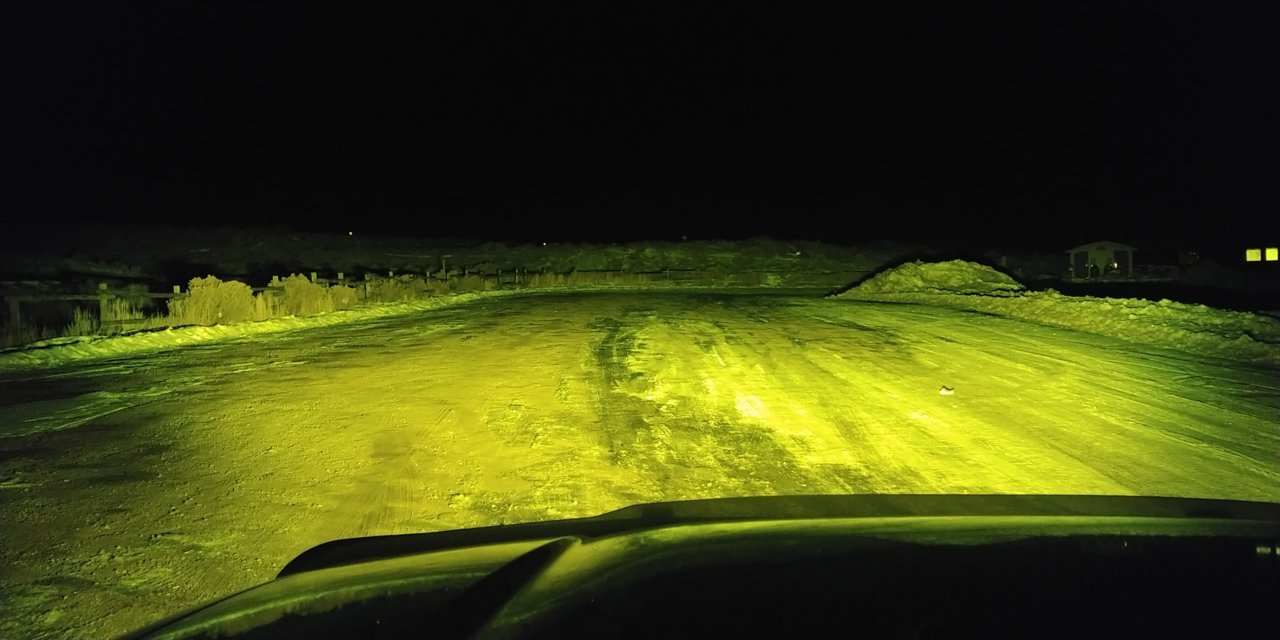

    Spend a couple hours out in the cold getting my new lights on. These are going to be perfect for the snow that we have for half the year.

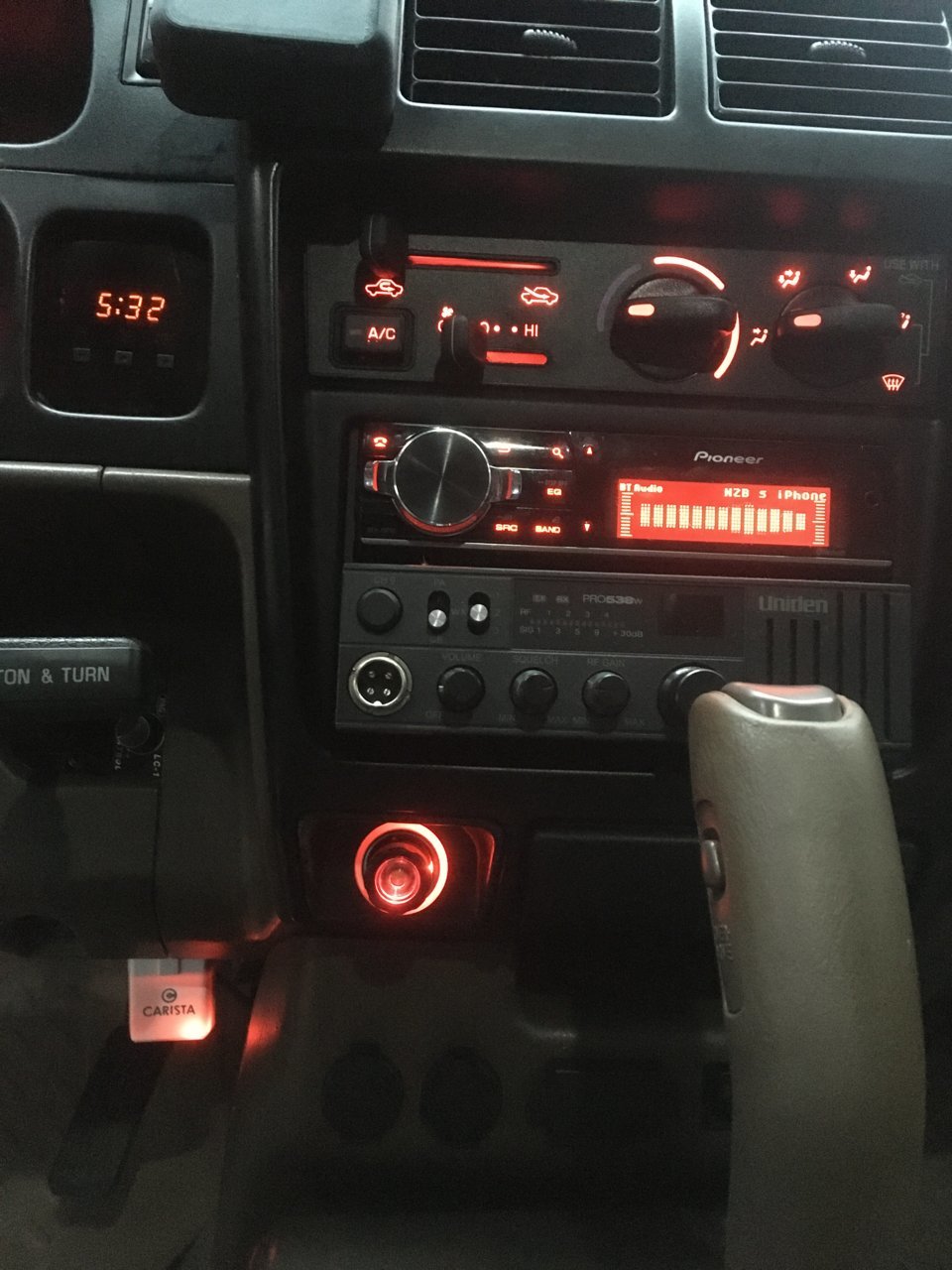

    Installed a lighted cig outlet from a rav4

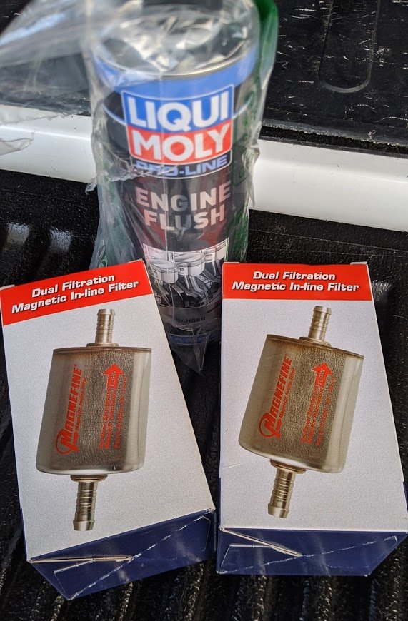

    Oh, and this stuff showed up late so it'll wait for next service.
    oDKmdHM0Iu4hF41sbevm2r7Q9eleFt67V7eDRjfe_c9391ee9e62c42c0d87cb333d8c59fc5a0dcc6ea.jpg
    Will do the trans filter when I install the Hayden and drain/fill trans fluid. Sometime after I work up the energy to remove the ARB bumper. :pccoffee:

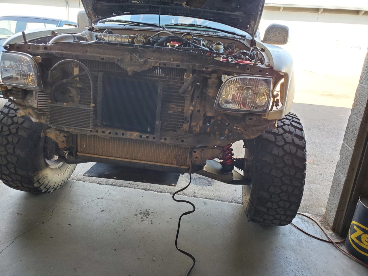

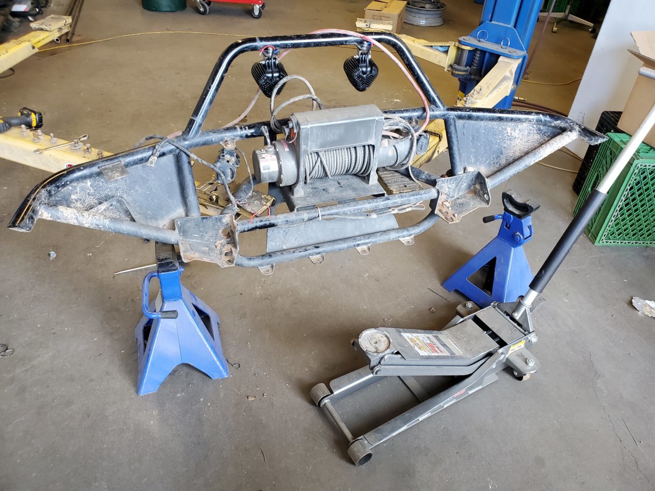

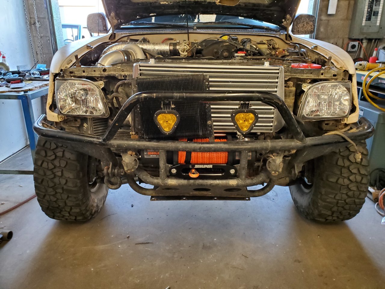

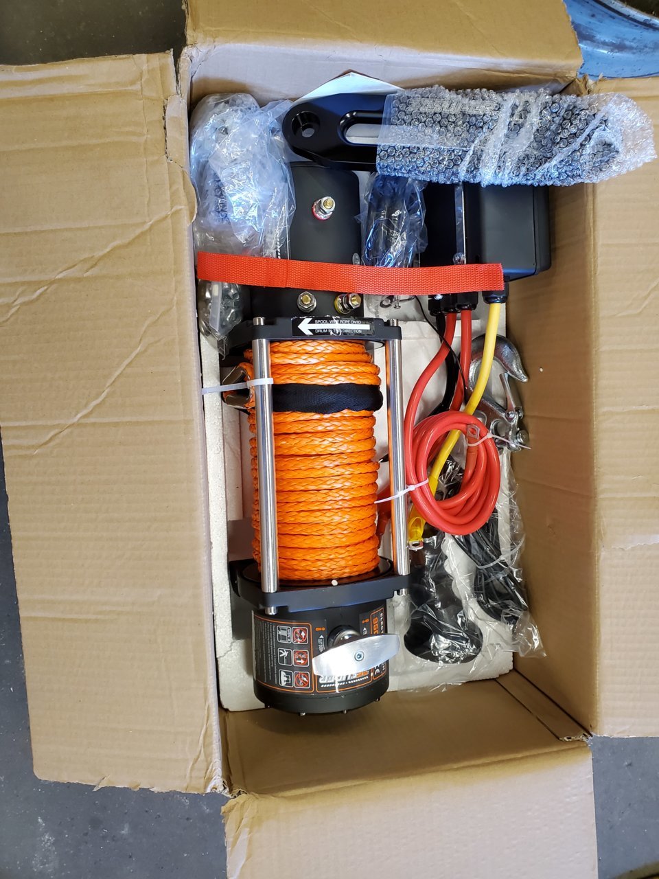

    20200125_123654.jpg 20200125_122439.jpg 20200125_122443.jpg 20200125_172748.jpg Today I got around to starting to add a Fmic. My old Warn winch was too tall and took up too much room so I did a side mount Ic in the wheel well. This worked pretty good and knocked down charge temps 40 plus degrees. Never got snagged by the wheel, but definitely a concern.
    So I recently orderd a Fmic off Amazon for less than 100 and a Zesuper 9500lb low profile winch for less than 280.
    Took off the bumper and swapped winches no problem, the synthetic rope and low profile setup is definitely lighter than my old cable system (yes!). Started to put it back together and noticed some cracks in the core support, broken Ac bracket and were reminded the cab mounts were shot. Now is the time, so this turned into a cab mount swap with Energy Suspension bushings I got for last Christmas.
    That took longer than expected, had to plasma cut one if the rear cab bolts off, ended up burning some of my hair off (ha!).
    Not many pics, but the cab mounts are done, winch and bumper back on. Now I need to find room for PS and Transmission cooler, cut a couple inches off IC, make a slim profile handle for winch, and make piping.

    I saw the Zesuper winches on Amazon recently...tempting price. Never heard of them though, are they decent? I guess you must think so since you bought one lol. I'm looking at getting a winch and weighing my options

    I honestly dont know, I really hope it's good tho. Box came with everything needed to install, couldn't beat the price.

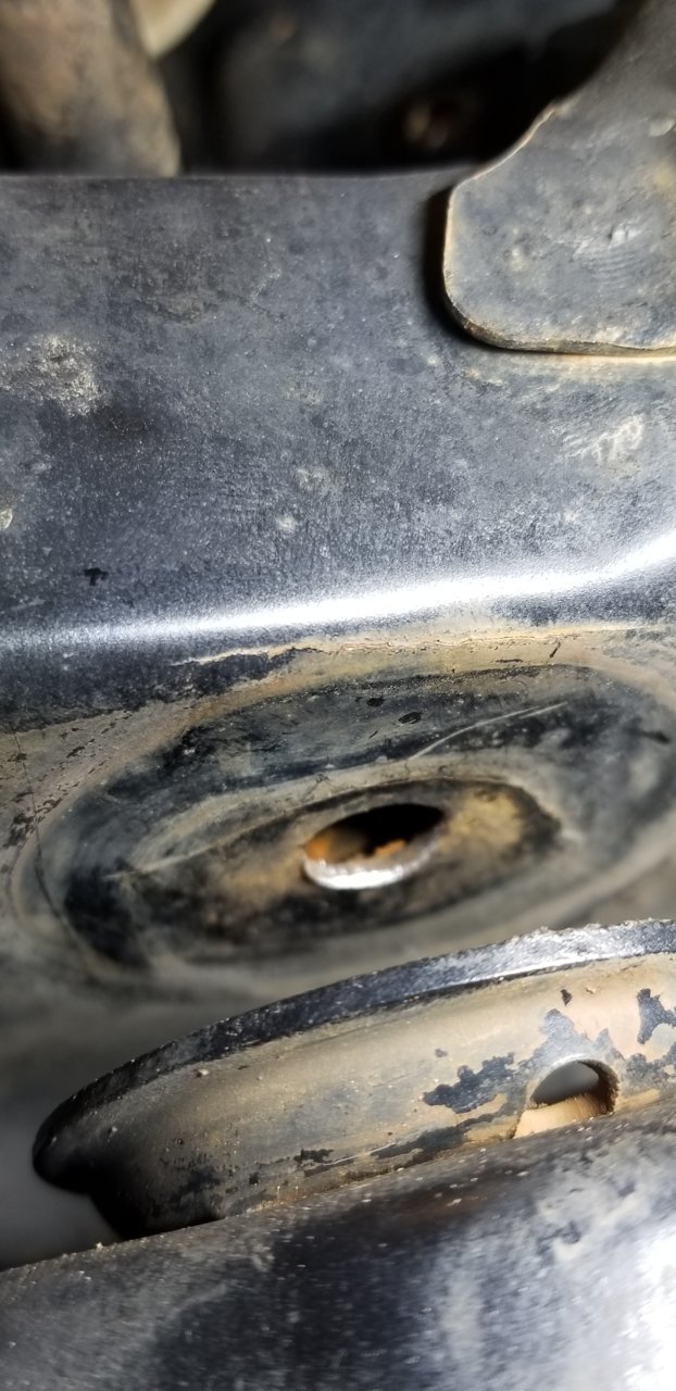

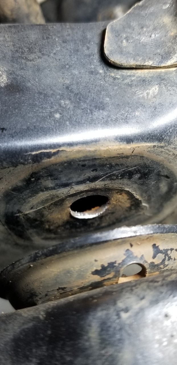

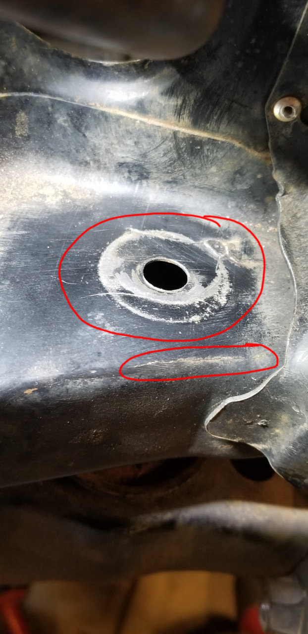

    Pulled off my bumper and winch to track down a clicking coming my front driver side core support body mount. Pulled it all apart to find the core support is cracked to shit there.
    It's about a 6 month old core support too lol. Didn't last too long.
    Gonna have to get creative to reinforce that area. As much as i'd like to make my own core support from scratch, I don't wanna get that crazy for now.
    https://www.youtube.com/watch?v=ctBT0rLCdng

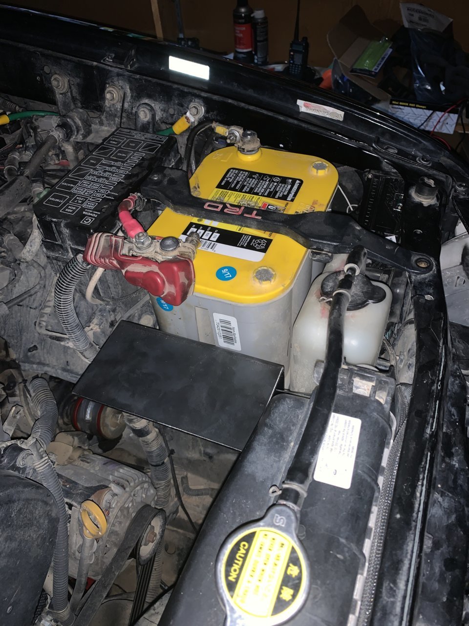

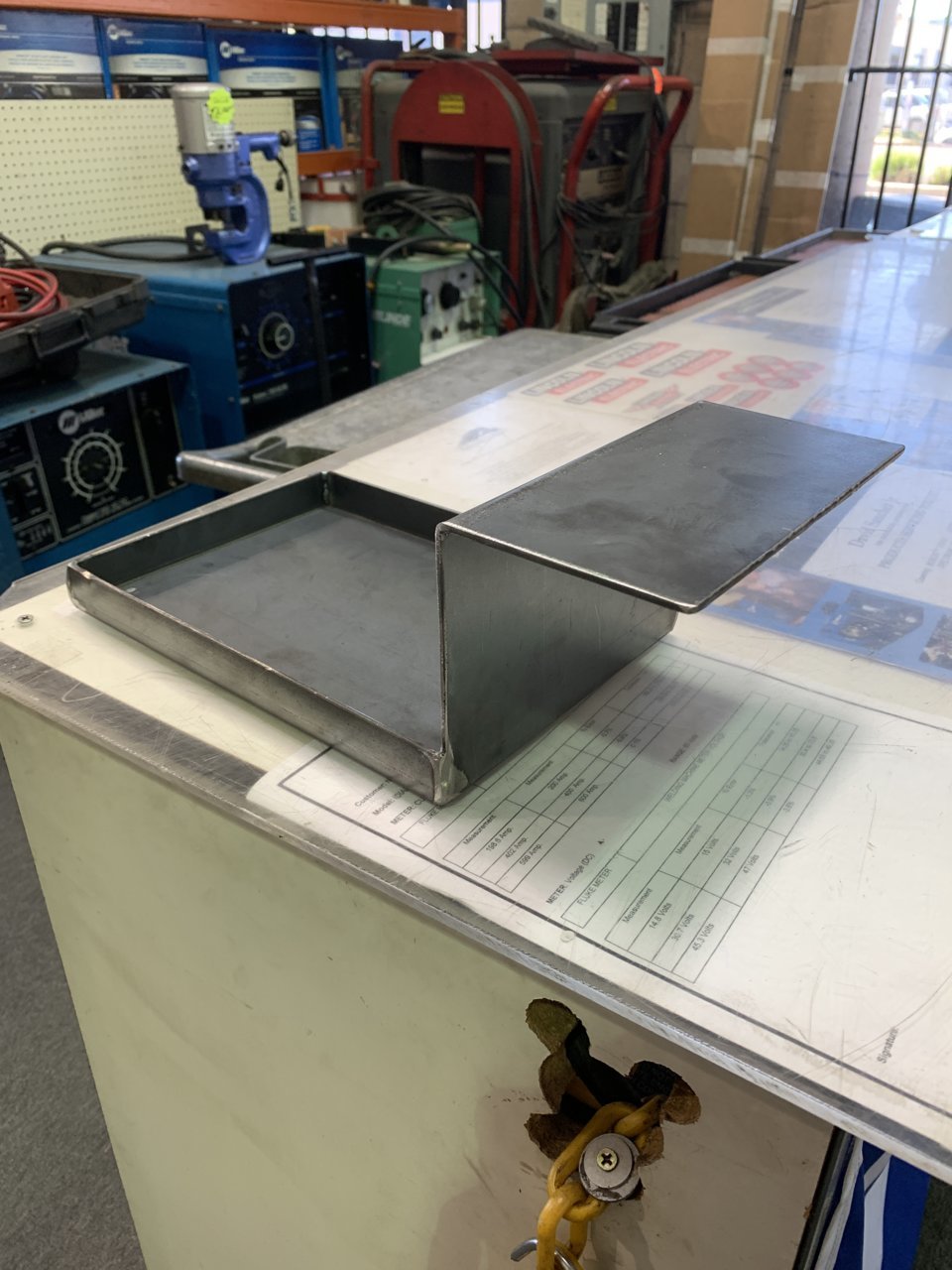

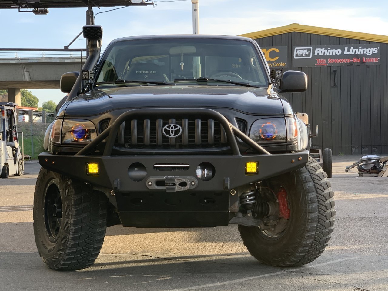

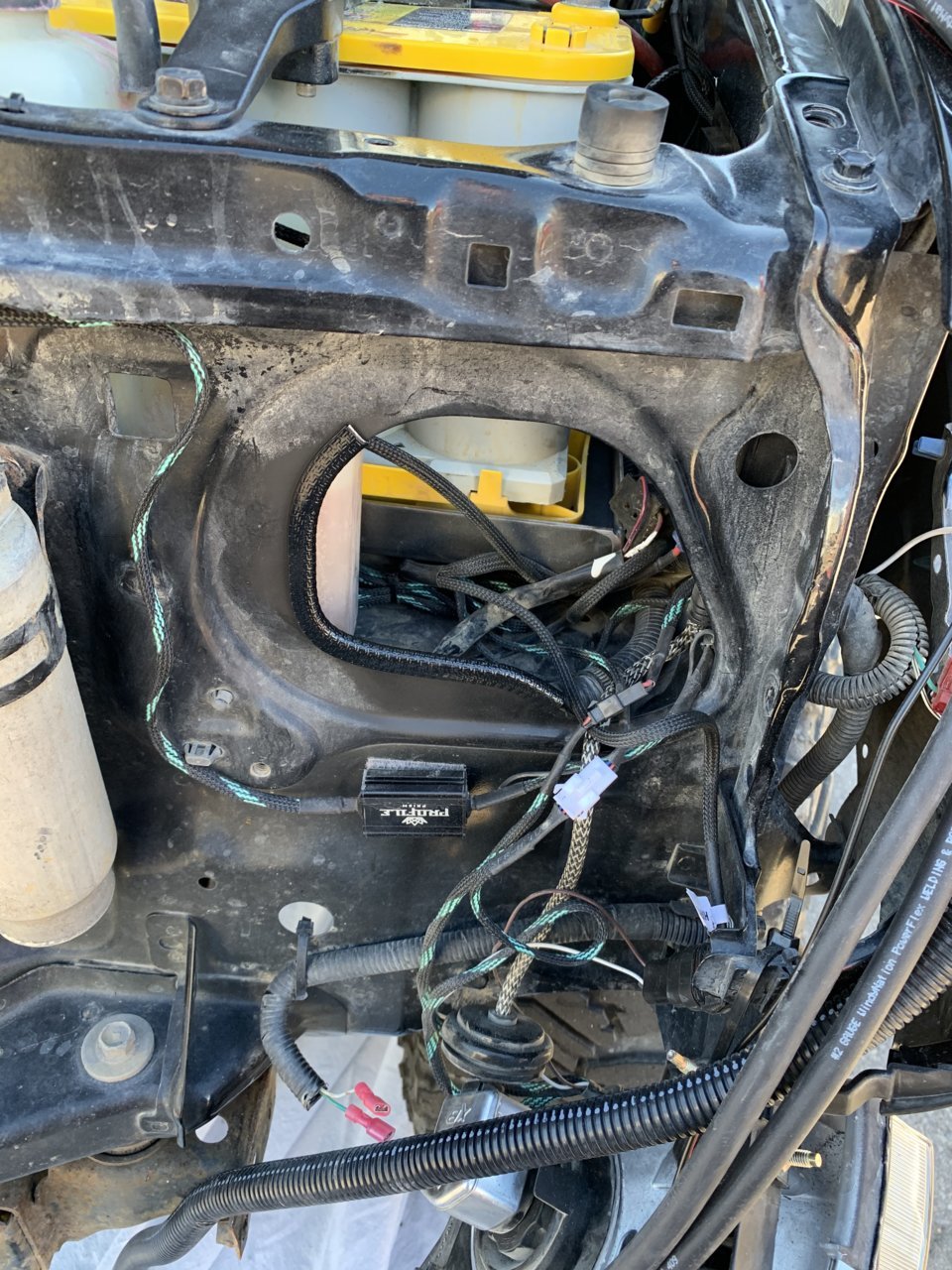

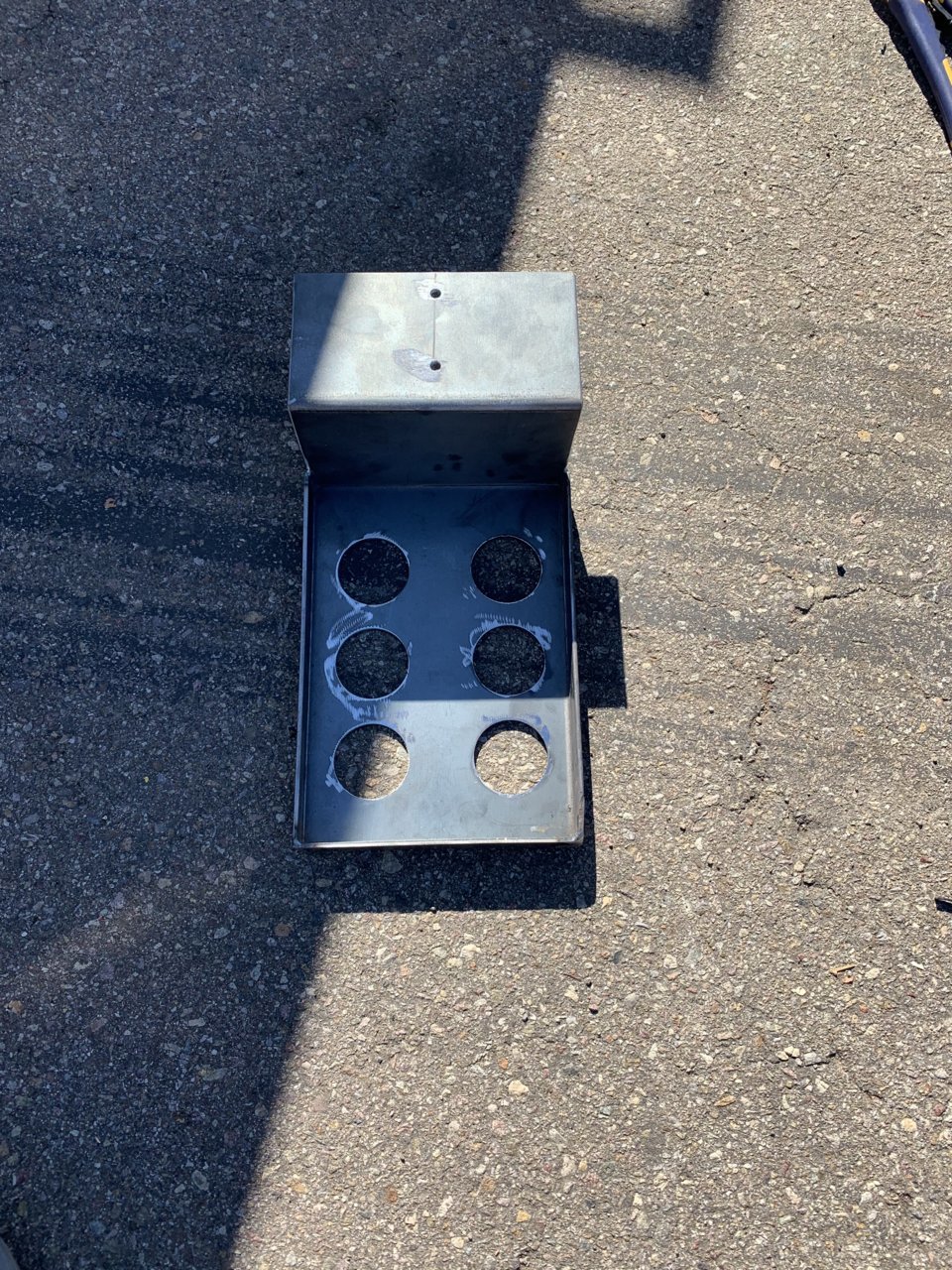

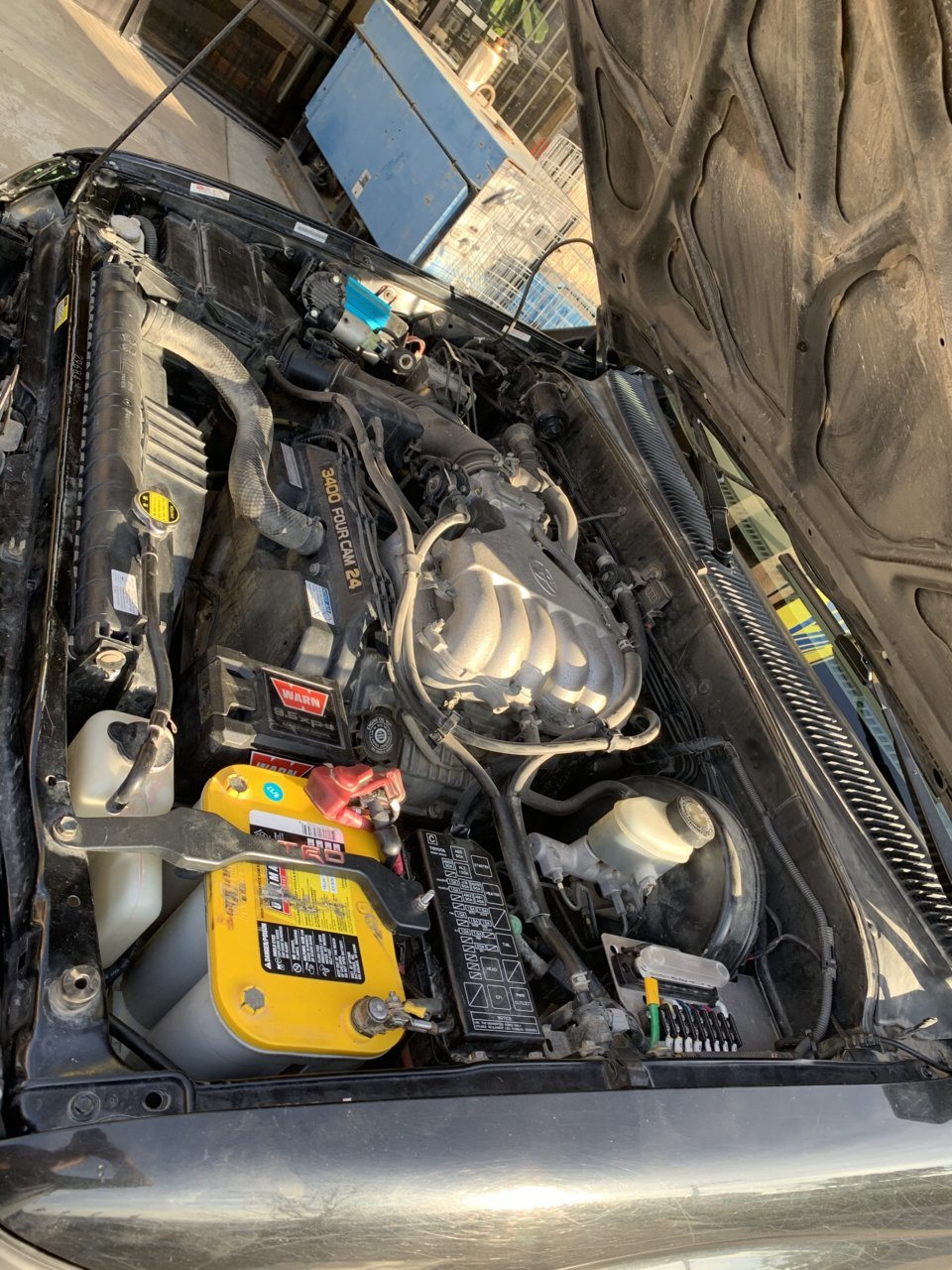

    Finally got everything in order to finish my bumper swap. I had been pointed towards an hvac guy who had a bender and he made me a battery cage that doubles as my winch controller mount. Still needs to be painted but it allowed me to finally put my winch on the bumper and add my fogs that took forever to show up. Had to widen the headlight opening to allow the wire to go through it and put some trim on it to keep the wires from rubbing. Pretty happy with the instal and can put this project to bed.
    CF2E70C0-662E-48F7-A260-8F0F93866F49.jpg 4160F4F2-7D50-488B-9E54-CFB85C5B2E40.jpg 6EFAA5E6-1D5E-4D36-BD6F-7194E89C398C.jpg 123AC48C-5591-455B-8F88-5828DC3B39A4.jpg 58AF118F-B98A-4567-9326-361D0346283E.jpg B4D7E73C-F030-4A6D-A265-6C01EE85FDED.jpg

    Looks awesome! Nice job! Curious... remember the size you used?
