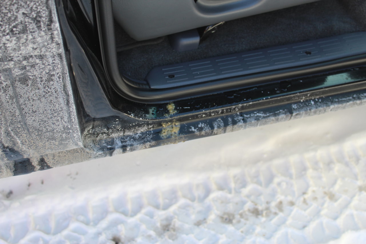

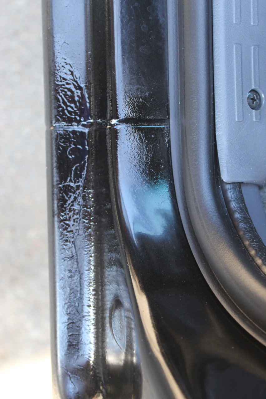

    i should give this Canadian product another shot in this spot, i was not sure it was holding up after a heavy rain seemed to wash it on out through the door drain holes soon after application
    i now have 5 gallons of 'Salts Gone' rinse so i do not have to hand scrub the scum off the paint, which will remove this stuff very easily (soap and sponge)
    its hard to tell though on black paint if its holding steady since its a clear see-thru gel and it does attract dirt on top of that

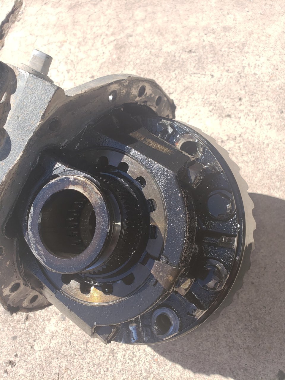

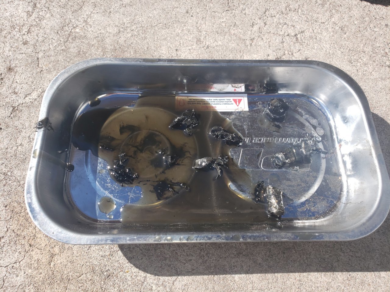

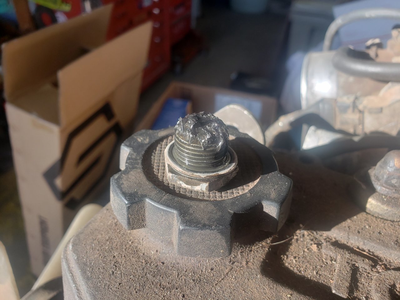

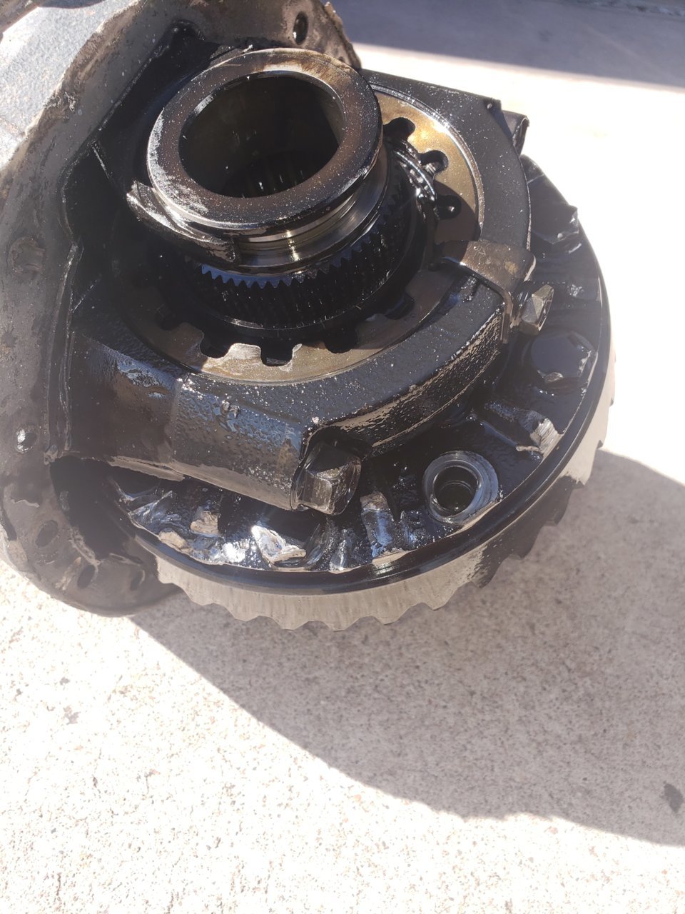

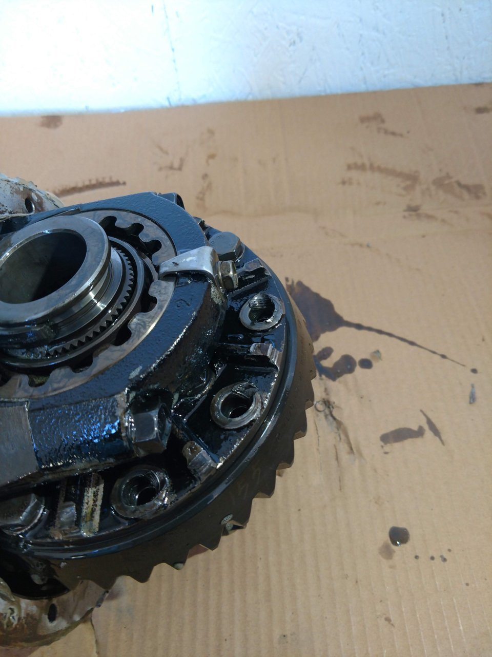

    Had to get hauled home last Friday for a clunk in my rear axle. Took it apart today and found two ring gear bolts had worked their way out and chewed up the carrier.
    A new E-Locker assembly has been acquired and the 4:88 gears have been ordered.

    not to sound like a smart ass, but you seem handy enough.
    did you think of removing the rear DS and just placing her in 4WD? Could drive home on the front shaft alone as if it was FWD, no?

    No. Not with those bolts like that. The ring gear would still be spinning even without the driveshaft.
    He could've pulled the 3rd, pulled the carrier, unbolt the ring gear, reassemble, and then drive it home in FWD, but that's not exactly an easy task.

    damn that sucks. Reminds me of the old issues with ECGS assembled thirds. I recall a few people stating that their bolts had backed out too.
