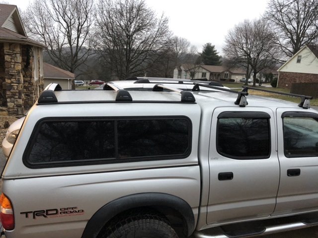

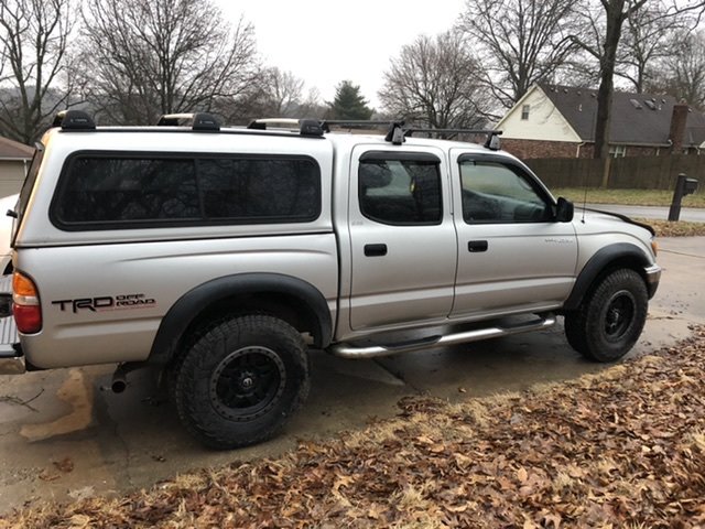

    Drilled through my campershell today to add tracks and bars! High stress stuff for me. I’m exhausted. Hopefully it works right. Seems to go “smooth” enough.

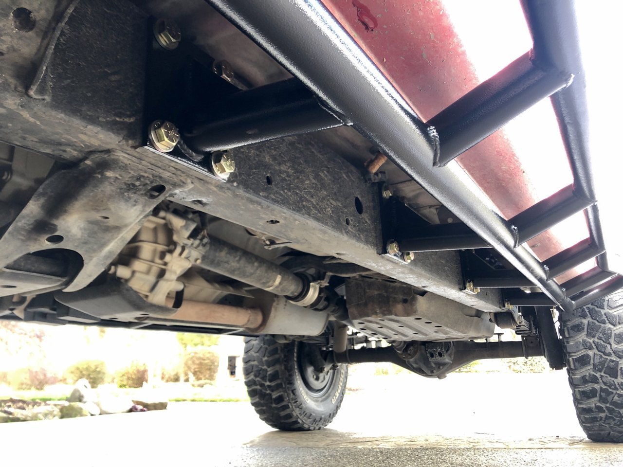

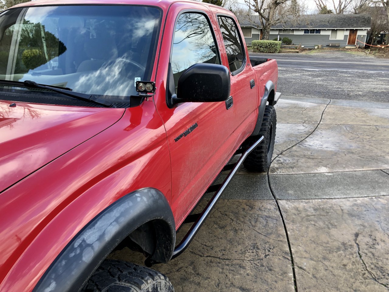

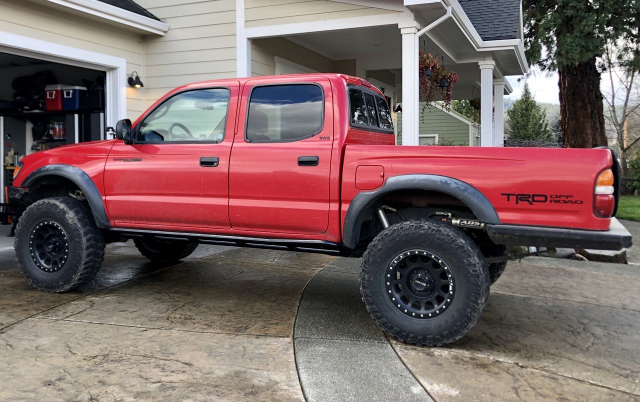

    How much time did it take to bolt them on. I just finished mine but cant decide to bolt on or weld them. Seems like bolting would take forever

    15 mins per side without an impact

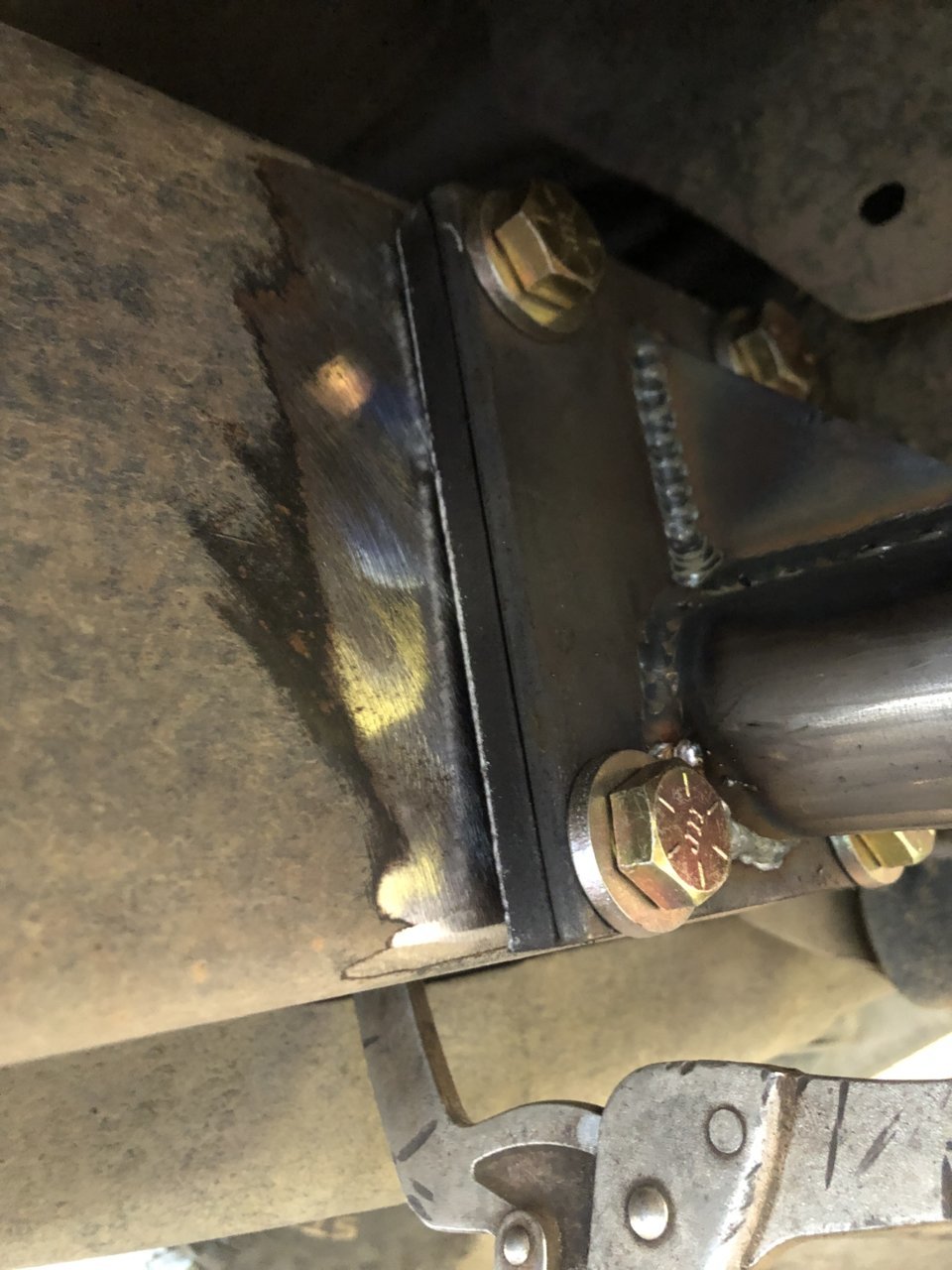

    Damn thats pretty quick. They are long bolts running threw the box frame right?

    Certainly faster than cutting off welded ones and re-welding if you ever needed to take them off.
    The bolts do not go through the frame, they bolt into a tapped 3/8'' plate that's welded to the frame.

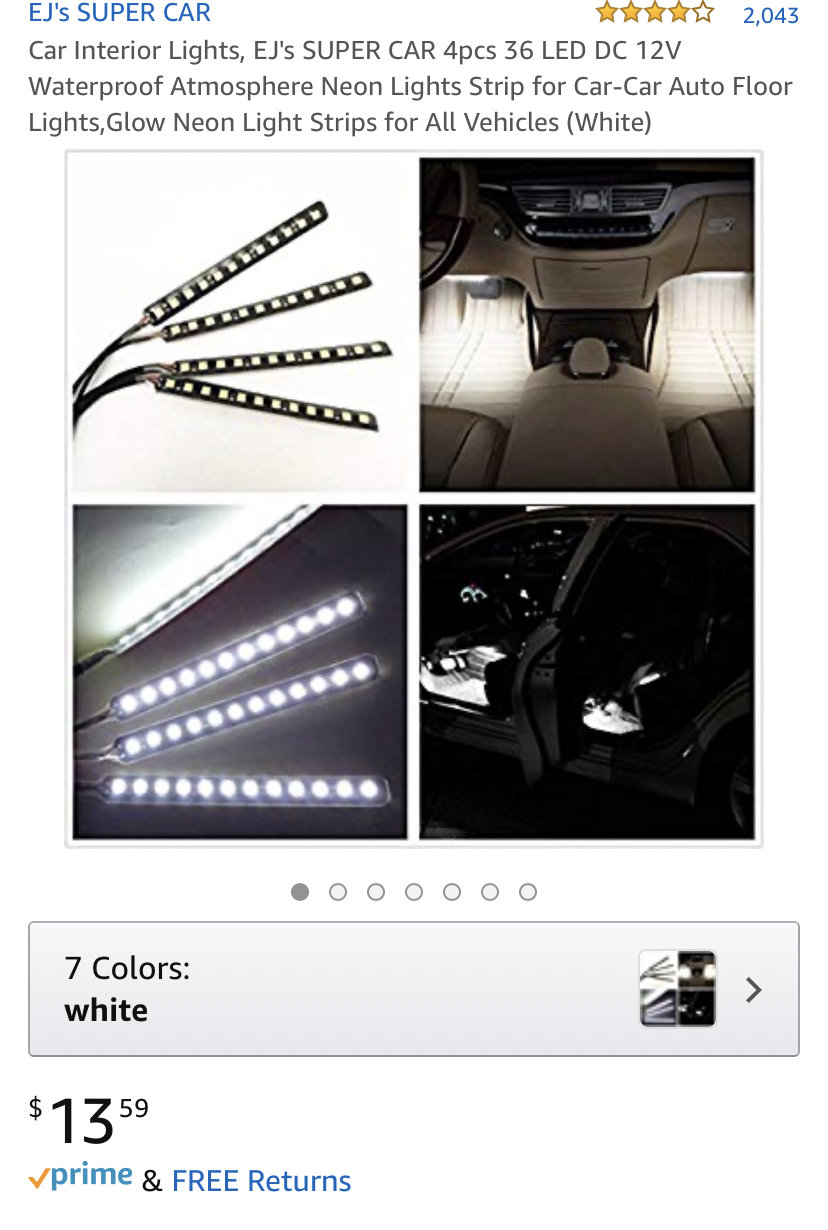

    Interested in your floor lights. LED?

    That's a great idea. Might have to copy this method

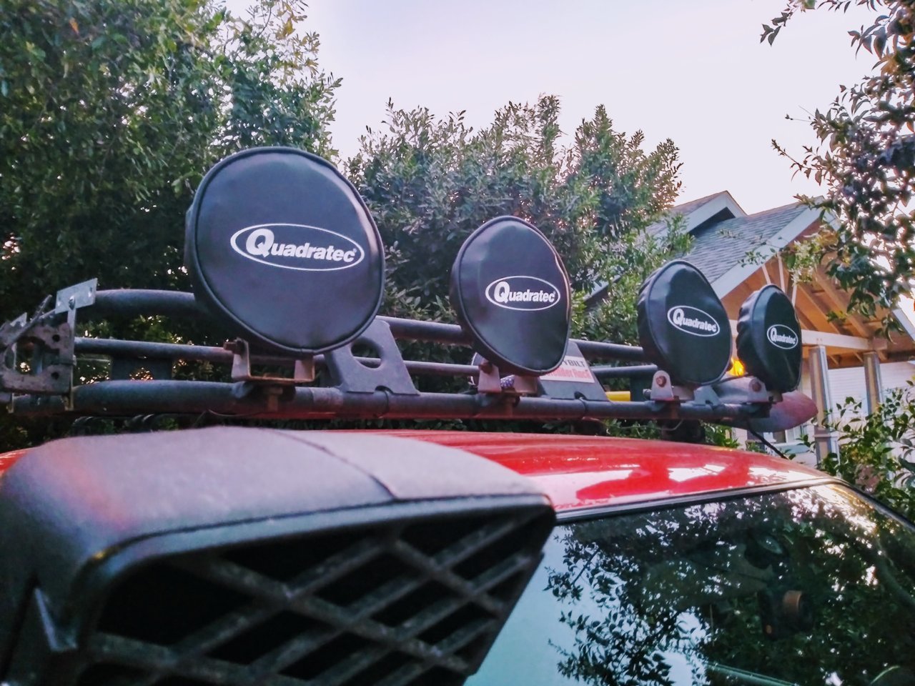

    Finally made my roof mounted lights 'legal'...found some soft covers online that didn't cost an arm and a leg like every other brand I found previously. $10 per pair from Quadratech
    https://www.quadratec.com/products/97109_131X_PG.htm
    Haven't gotten pulled over with them uncovered but know plenty of guys around here that have, figured it best not to push my luck anymore

    I bought this set, it comes with a DC 12v plug. I ran lights to the drivers and passengers side and lights under both seats for the back.
