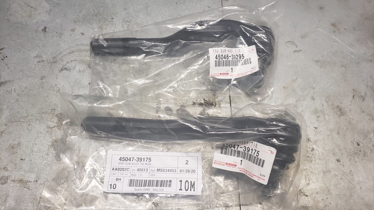

    I have got to say... I'm seriously impressed with McGeorge Toyota right now! :thumbsup:
    Screenshot_20200205-171610_Gmail.jpg Screenshot_20200205-171638_Gmail.jpg 20200205_171720.jpg
    Ordered OTREs 2 days ago... they are already here. And the price was the best I found anywhere.

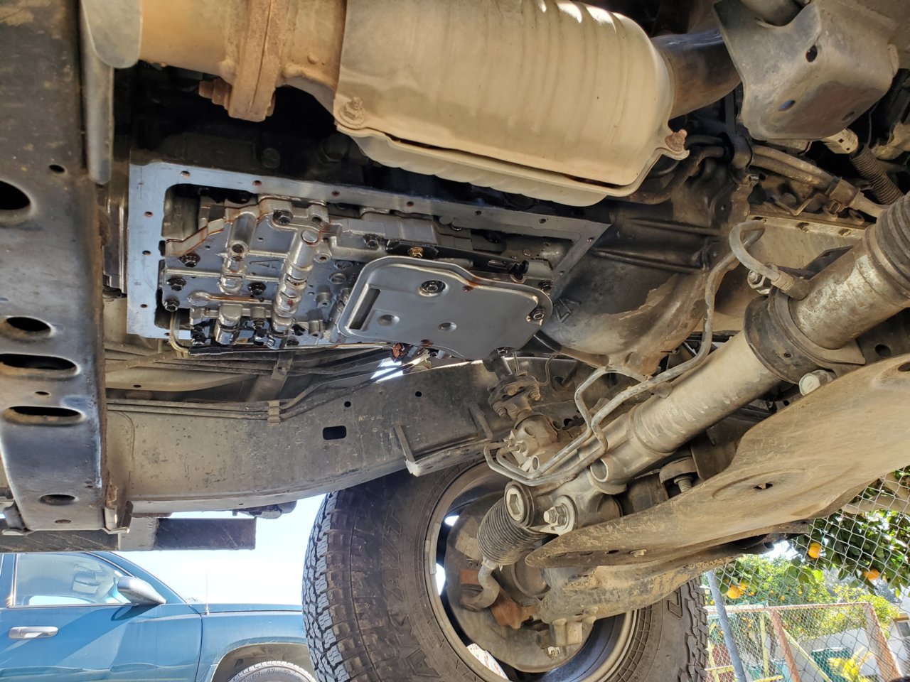

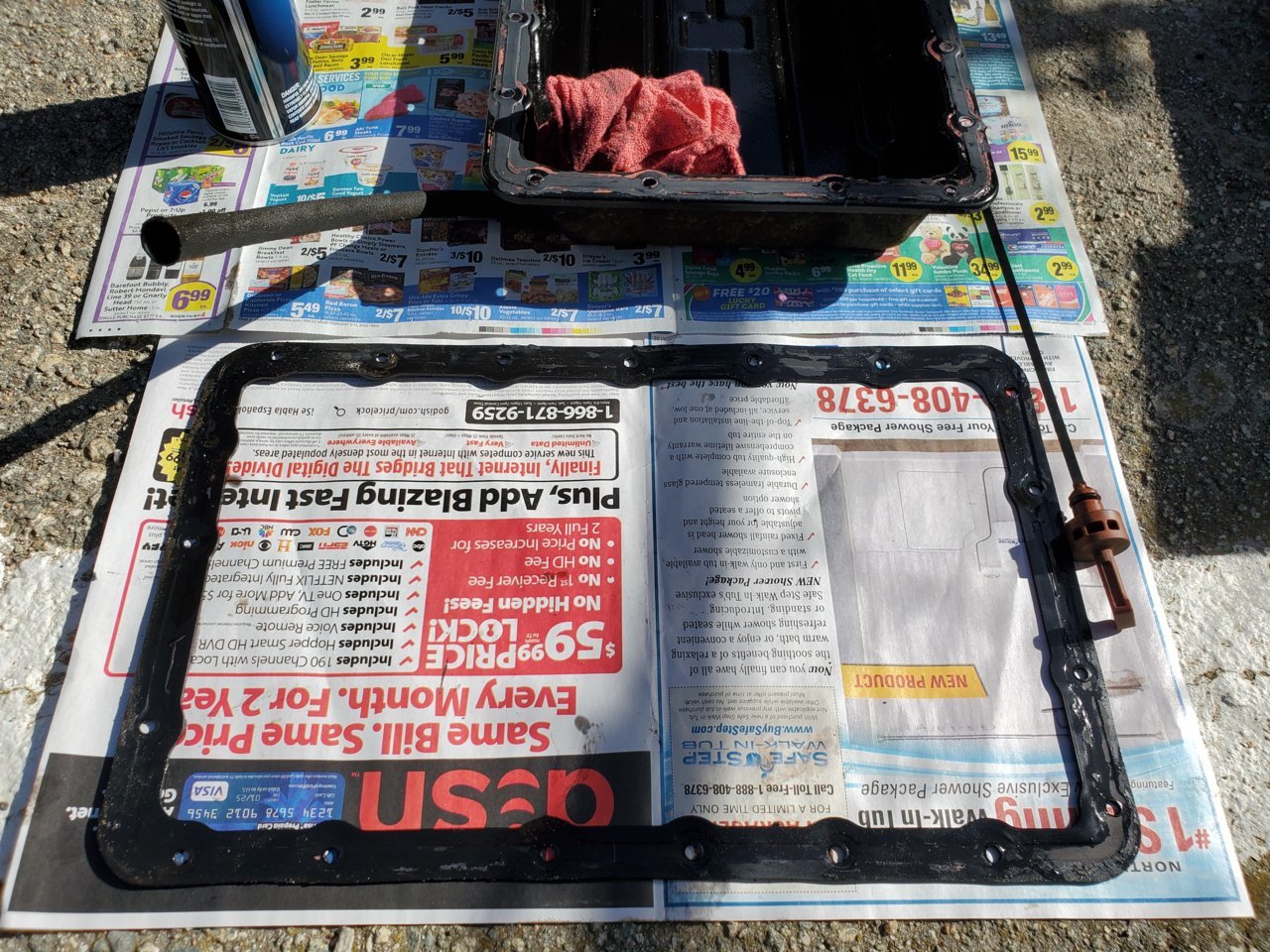

    Replaced the 2 month old gasket on my transmission pan with a Toyota FIPG -
    The gasket that gave me grief. It held up through several off road trips but for some reason it recently started to seep -

    Time estimate on how long that took to replace the FIPB?
    Difficulty level? 1 = easy, 5 = take it to a shop
  18. Feb 6, 2020 at 12:03 PM
    Kwikvette
    Feb 27, 2019
    #284735
    82,743
    Fresno County
    4 run, 2 don't
    Eh 1 and 2...read below
    Gather up a few shop rags, a new can of brake cleaner, a scraper tool (the double sided one from Ace with a blunt edge and a sharp edge), plastic prying tool, 6 quarts of Toyota ATF, Toyota FIPG 00295-01281, disposable gloves, a 3/8" drive 6" extension, 3/8" drive 10mm socket, 3/8" drive 12mm socket, and 3/8" drive 14mm socket. For efficiency, I use a Milwaukee M12 ratcheting power tool.
    Pull dipstick tube (relieves pressure), and place square shaped pan underneath your transmission, and undo the 14mm bolt to drain. There's a crush washer, should've mentioned this earlier so you can buy a replacement.
    Slightly loosen the 12mm bolt that holds your transmission dipstick tube in place. Not necessary but it helped when I reinstalled my transmission pan.
    Anyway, with the drain you should pull about 4 quarts.
    Replace 14mm bolt.
    Undo the 19x10mm bolts; the pan will be stuck especially if it's on its original FIPG. Use your plastic pry bar to separate the pan. Careful though as there is still some fluid inside your pan.
    Another thing to keep in mind is, the dipstick tube meets your pan halfway down as the tube is comprised of two parts.
    All of the above is a 1
    Scrape all the mating surfaces of the gasket material; this is really the only hard part about the whole thing as the stuff flakes like crazy. This is where the scraper tool and brake cleaner come in handy.
    Let's not forget your transmission filter that you can clean out and reuse. Also held by 10mm bolts.
    Reverse for install and top off as needed.
    When using the FIPG, you have a small window before the stuff starts to settle so work quickly and make use of the tool that helps to squeeze the tube.
    If you don't include the time it takes to completely clean your pan, or the transferring of old fluids to empty bottles, I'd say an hour or so?
