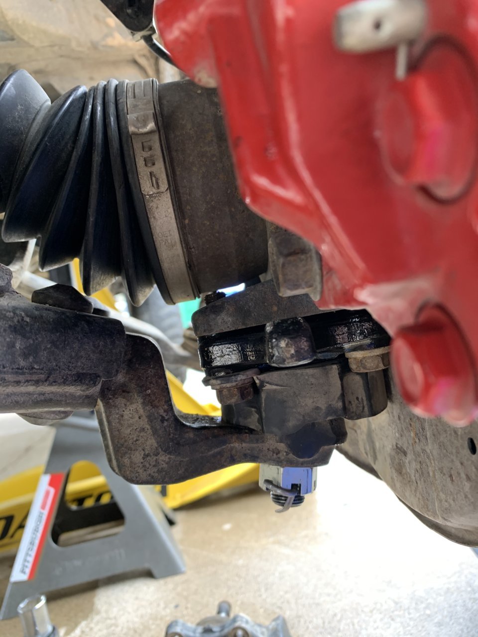

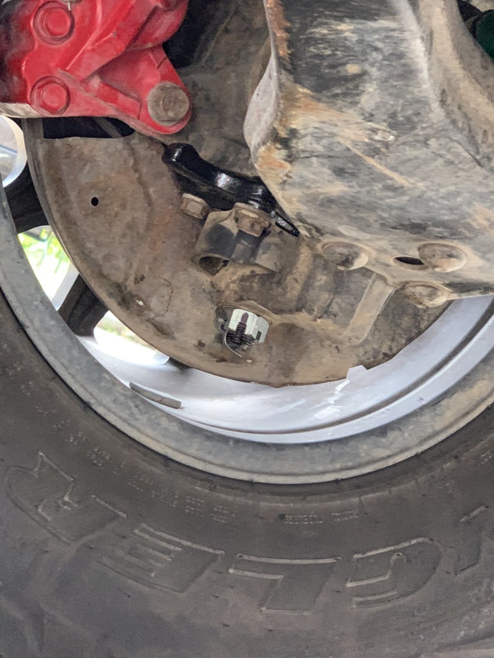

    02 Tacoma, fixed with curse words.
    I always just put red loctite on mine and used a torque wrench and didnt worry about it. Red because I used blue once and I randomly found a bolt lose.

    Thats what I did two years ago and they didnt move at all, butI figure might as well put new ones on. I will definitely still use red loctite.

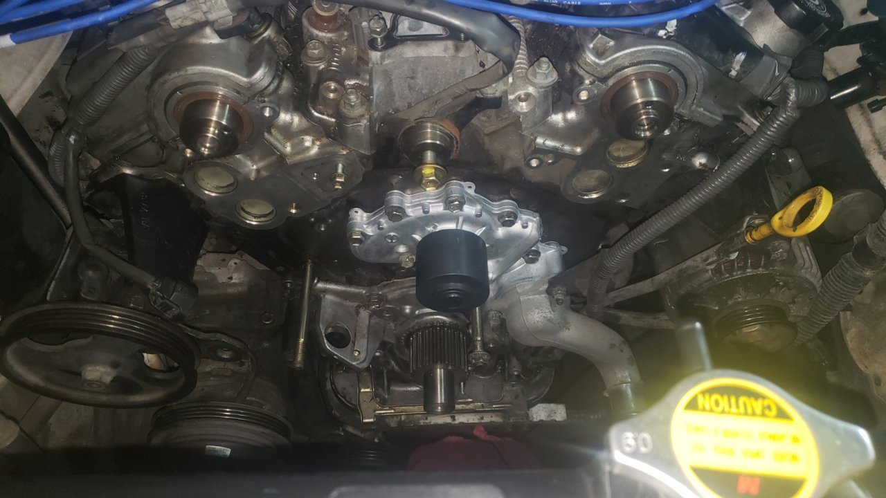

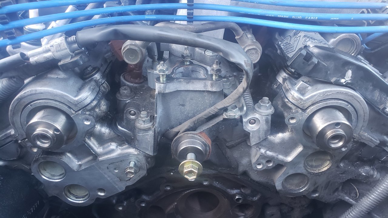

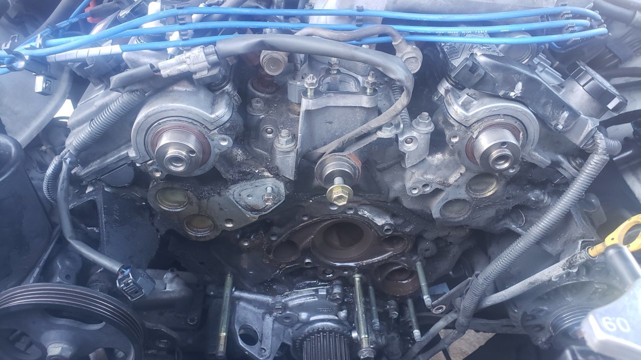

    Little more progress being made... camshaft pulley tool arrived last night. So we pulled them today, got the final cover off, removed the cam seals and replaced. Removed water pump, and now @RobertsT4R is out there cleaning everything he can get to with all the covers removed.

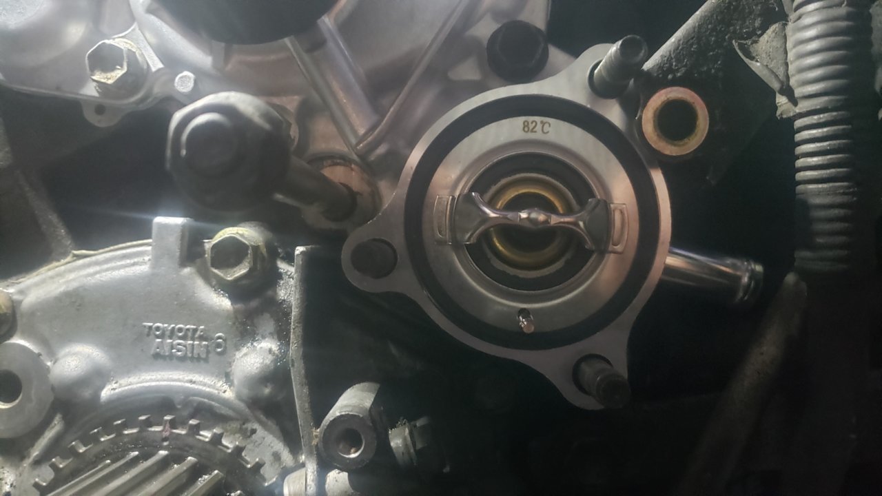

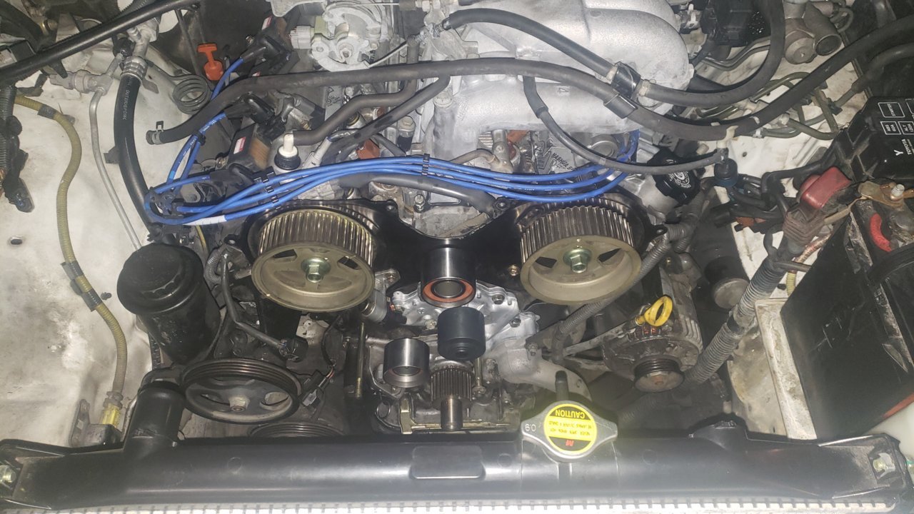

    More progress has been made.
    Water pump, thermostat, timing cover #3, cam pulleys, Ider pulley #1 and #2... and hydraulic tensioner are installed (hydraulic tensioner was a pain in the f'n ass, as always)

    Be sure to twist them wires really, really tight so you know they will hold good. :D
    I use blue but I also mark them with a paint pen so I can see at a glance whether they have moved/loosend. Never have. Third set using this method.

    Yeah the paint pen method is the best, i finally found all my art supplies from college and went through and marked my bolts. Way easier than torquing em down all over again. I figured drill some holes and add wires like ryan suggested too lol

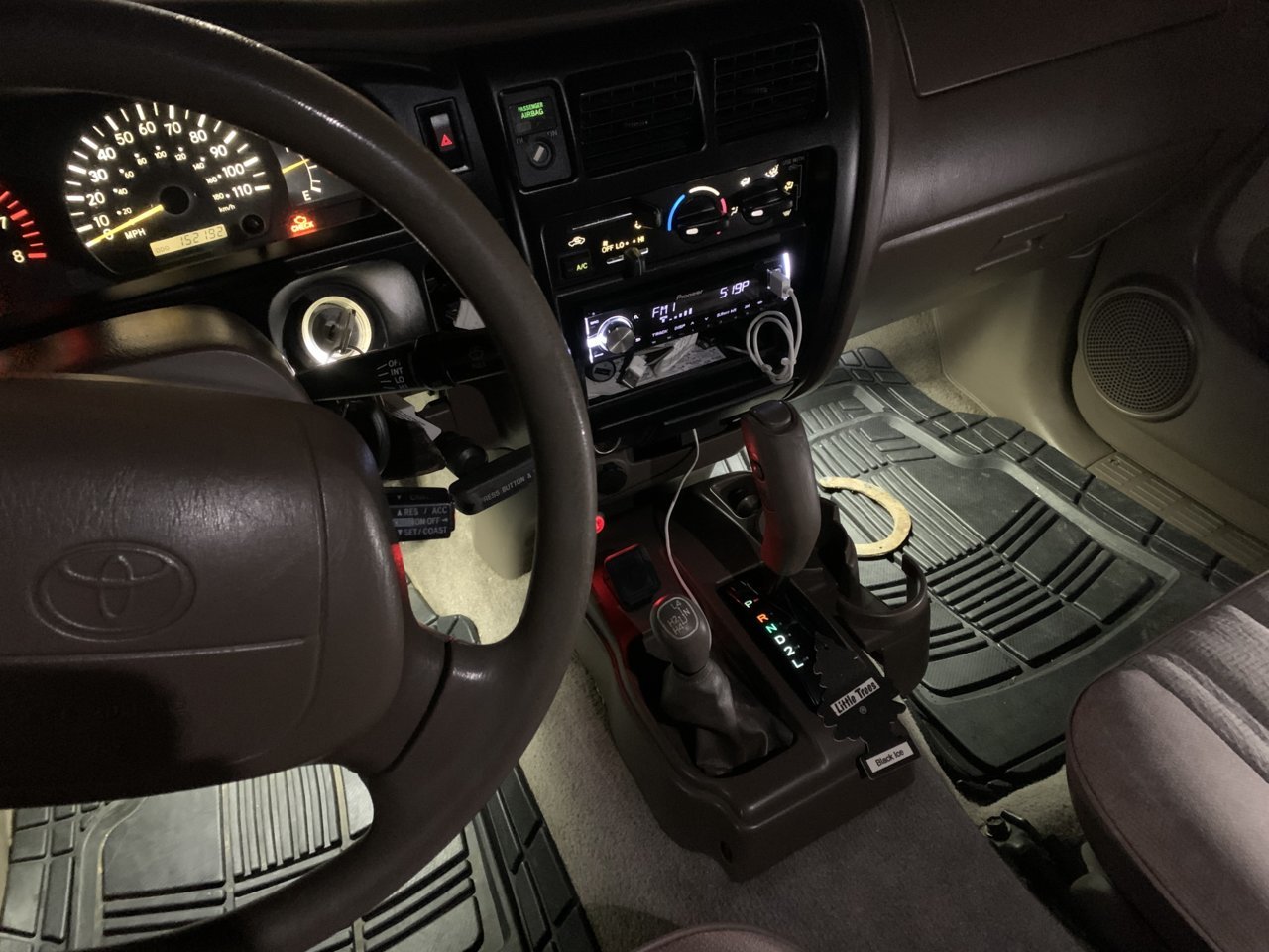

    Those LED Floor Lights still working for you? Mine crapped out after about 5 minutes...

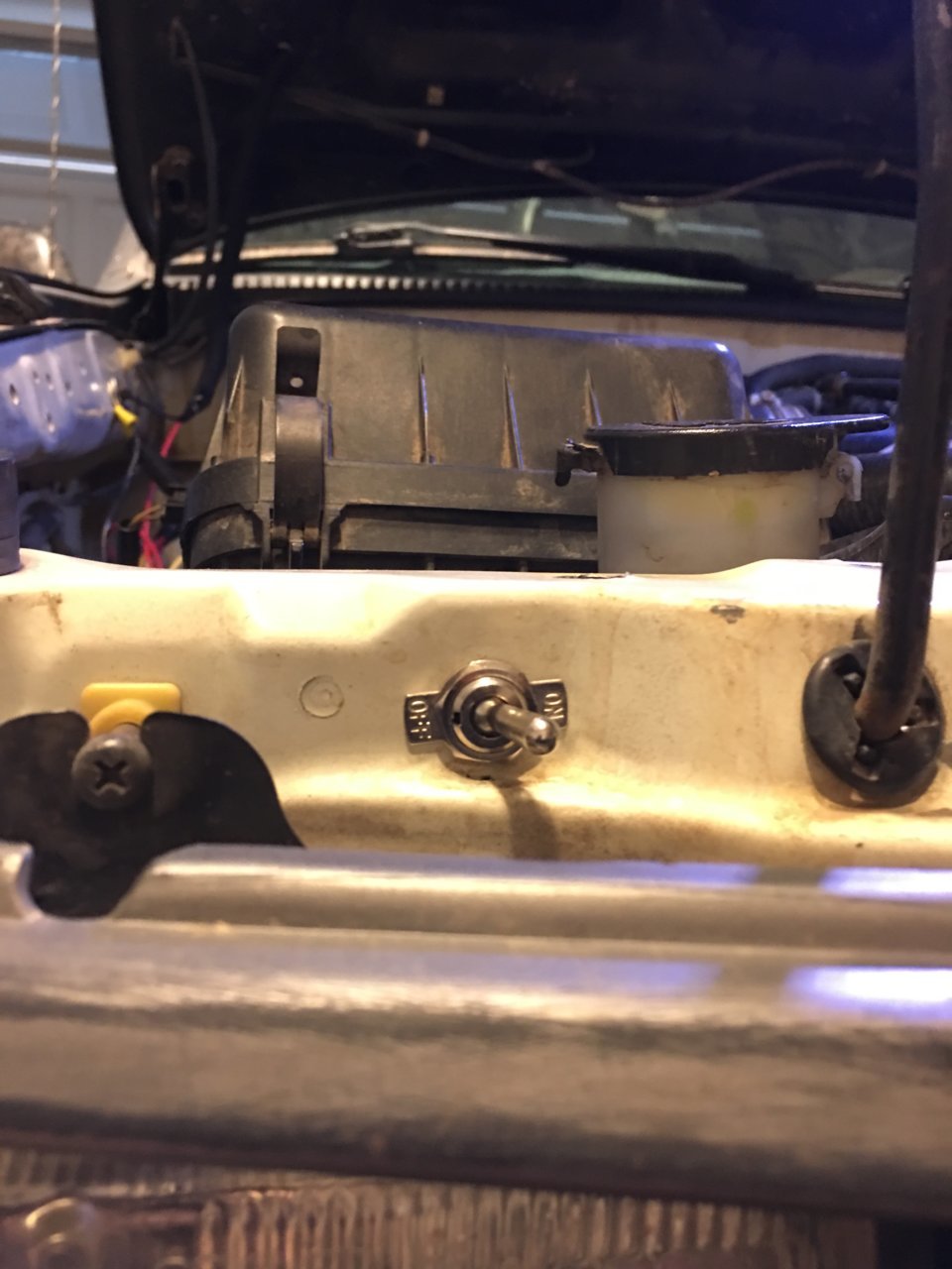

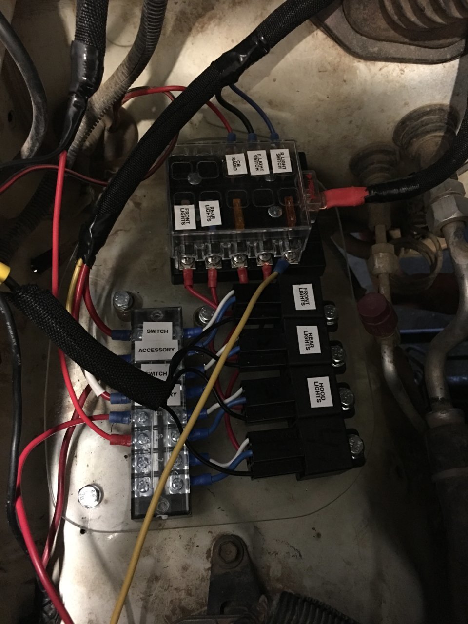

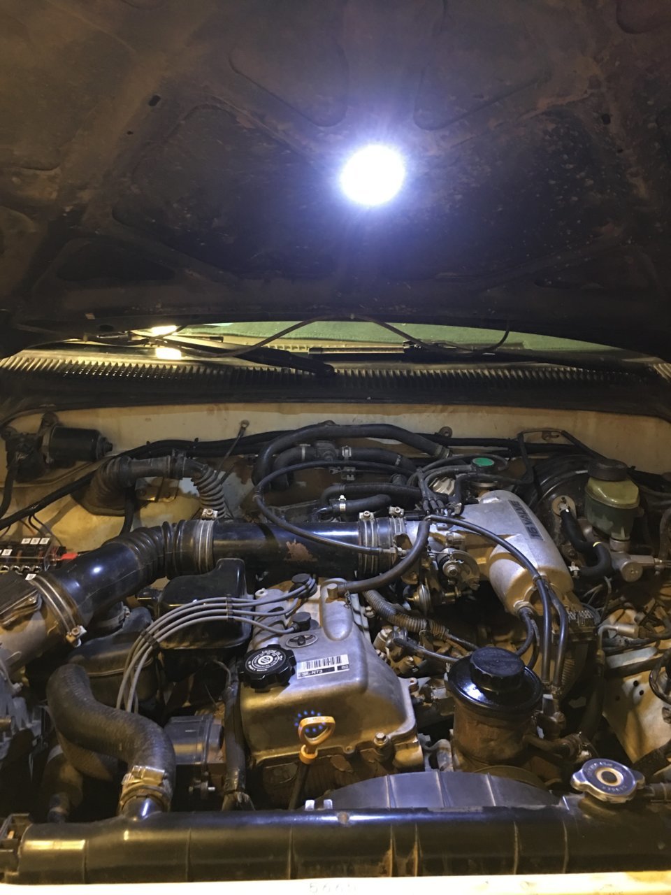

    Installed a light under my hood today. I found an existing hole, above the passenger head light, to put the switch in. Hooked all up to my DIY fuse relay box. 416E6FDD-D1D5-4B14-9DBE-D89E0001A495.jpg8DBC9C91-AC9A-42D9-A0EE-113A96C08C00.jpg96305C5E-5063-46B6-9C2E-0202DF96632E.jpg
