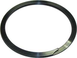

    Looks like you got it with the picks and some pliers. What parts do you need to order? Just new snap rings? I replace the spiral locks with normal internal snap rings.

    The conventional snap ring is way more reusable and less of a PITA than the spiral locks that rust out a lot quicker than the chromate plated c clips I provide.
    https://www.303shockservices.com/product-page/2-5-coilover-lower-mount-replacement-bearing-kit
    Either way you are basically buying the same parts and you're at least doing the maintenance that most neglect and eventually take out the rod end. :thumbsup:

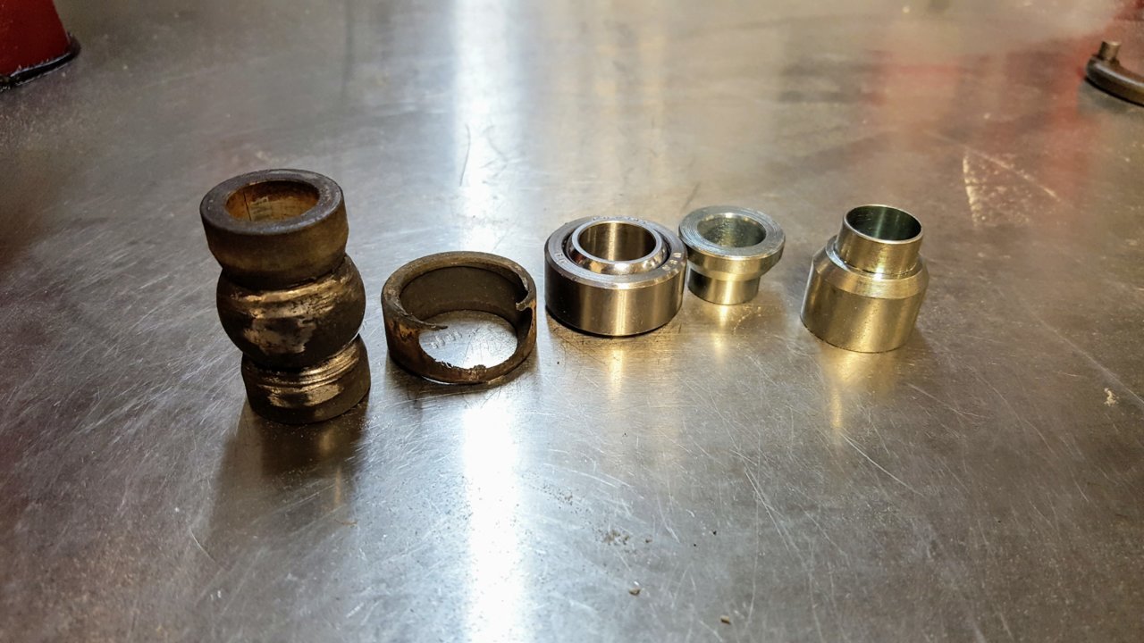

    Here is an even worst one I have repaired before.

    They definitely made a racket long before the ball got into the aluminum. And really when they are easy to move by hand or start squeaking it's time to replace them before it gets to much slop to wears out other expensive parts.
    EDIT: Tips, I clean the bore with a rag, brake clean ect, install 1 side and press in the uniball until it hits the snap ring and put the other ring in. I don't normally grease the rod end bore but a light film wouldn't hurt. Definitely anti seize the bearing reducers and the bolts when you install them.
