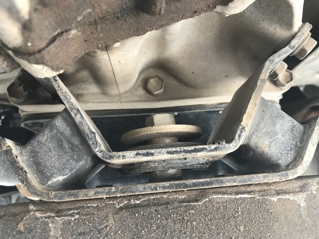

    Any opinions on autotrans mounts? I’m in need of a new one I believe

    Did you loosen the bolt? Mount doesn’t look problematic, just lose
    I could be wrong just my 2¢

    Kinda looks like the left side is cracked, but I'm not sure either.

    The mount looks exactly like mine did before I changed it. I could physically move the trans up and down with one hand. The rubber is just aged. Weight of the transmission is taking its toll. I did not notice any difference after replacing mine. It just seems sturdier than before. My 2 cents. The center bolt is just there in case the rubber completely gives out and breaks.

    I’m thinking it’s cracked all the way through

    I guess I’ll go give it a shake tomorrow.
    I’m getting vibs at certain points under acceleration, ujoints are fine, CB seems fine.

    Options are real limited on the auto trans mounts... like, basically limited to just OEM as a best option. No one makes an upgraded mount for auto trans... I looked for a good 6 months while I was collecting parts for my swap.

    Good to know, wonder how much one of those costs. Probably just grab an autozone part I guess.
