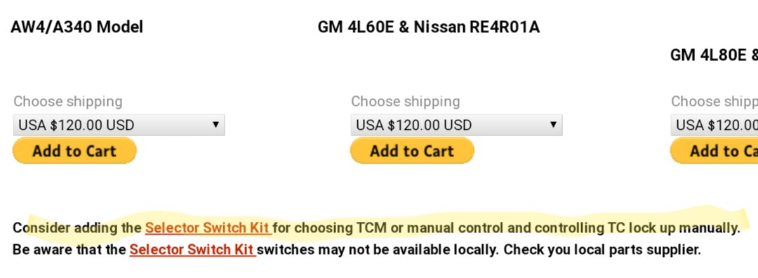

    WTF??? I have never seen this. You have s link? Can anyone confirm this shit isn't black magic?
    I'm cool with grey magic, just don't want to have to do any blood sacrifices for it... and want to make sure it'll work.

    Bruh i linked it for you already

    Its only 150 for the controller and auto/manual selector switches than add another 100 for a shift kit which these transmissions really need
    Itll be about 300 bucks to get a nicer auto... still no 5 speed but hey
