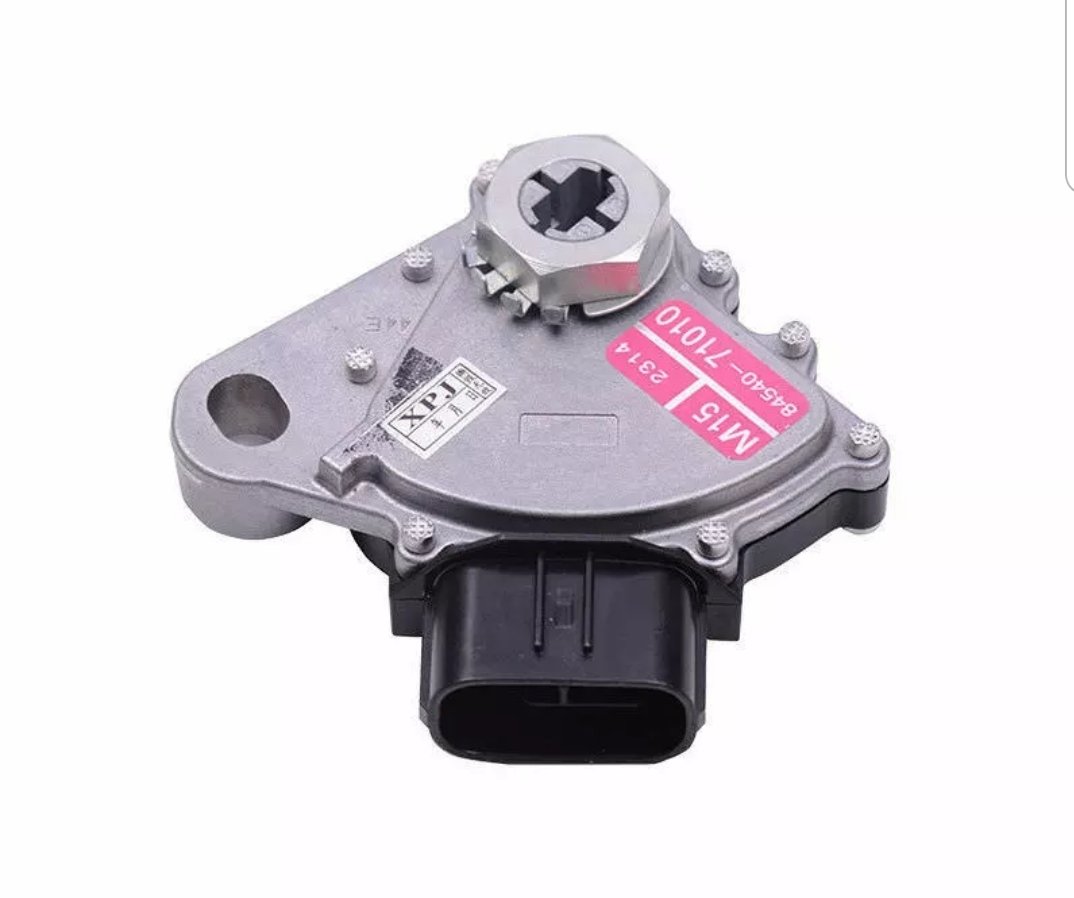

    What would cause the truck not to start in Park when it fires up no problem in Neutral?

    Neutral safety switch.

    This would be my first check for sure.

    This.
    I had the same issue after I dunked mine in deep water. I was able to just clean the contacts.

    So we're talking the doo dad on the side of the trans... That looks something like this?

    Yup

    Alrighty-then... Guess I'll be looking at that tomorrow.

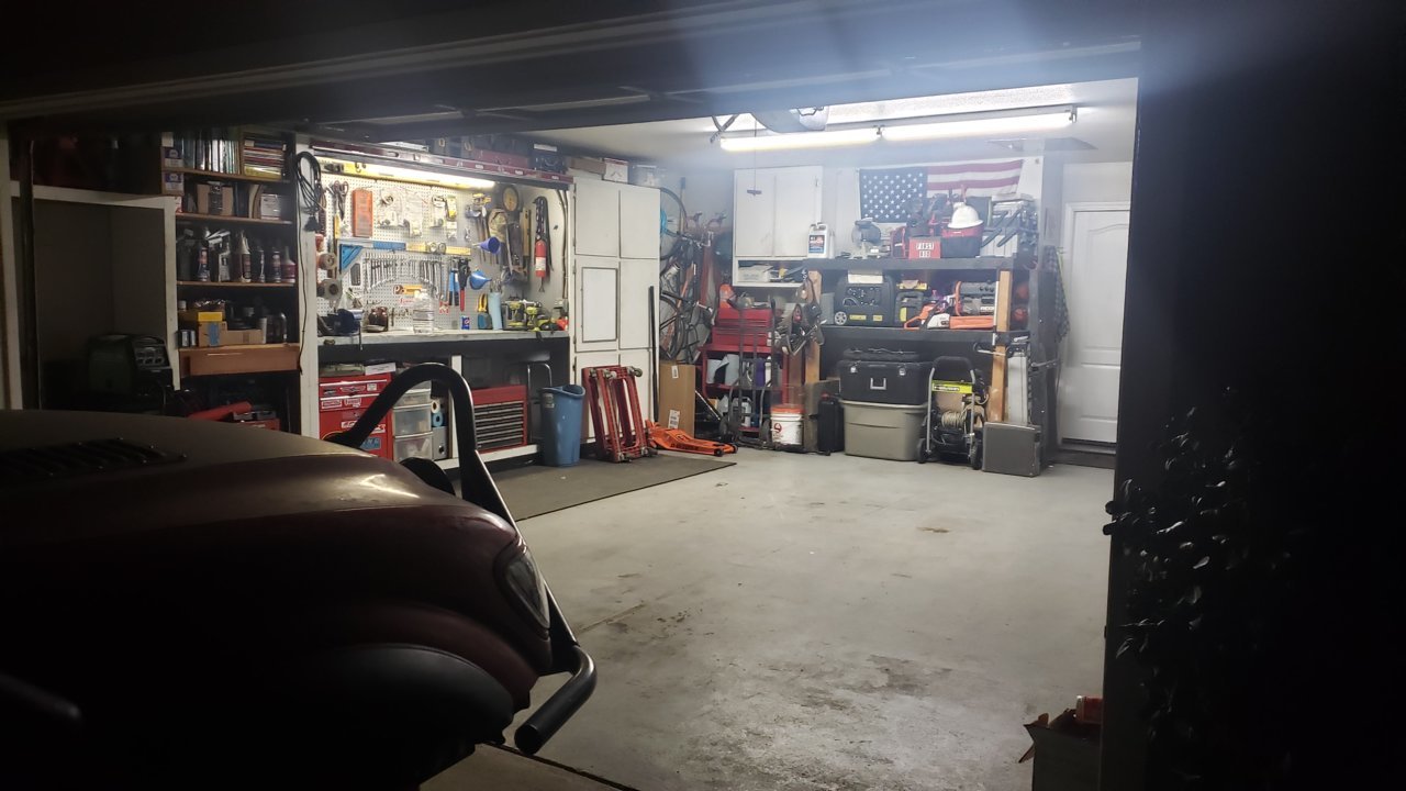

    In other news... I finally got my garage back :thumbsup:
    @RobertsT4R is running, and driving well. (Except it only starts in Neutral... lol)

    When you say you cleaned the contacts... Did you use something like an electronics contact cleaner?

    Yes. Took the plug off sprayed/scrubbed the gunk out. I might've removed the whole assembly and cleaned it, but it's been a few years.
