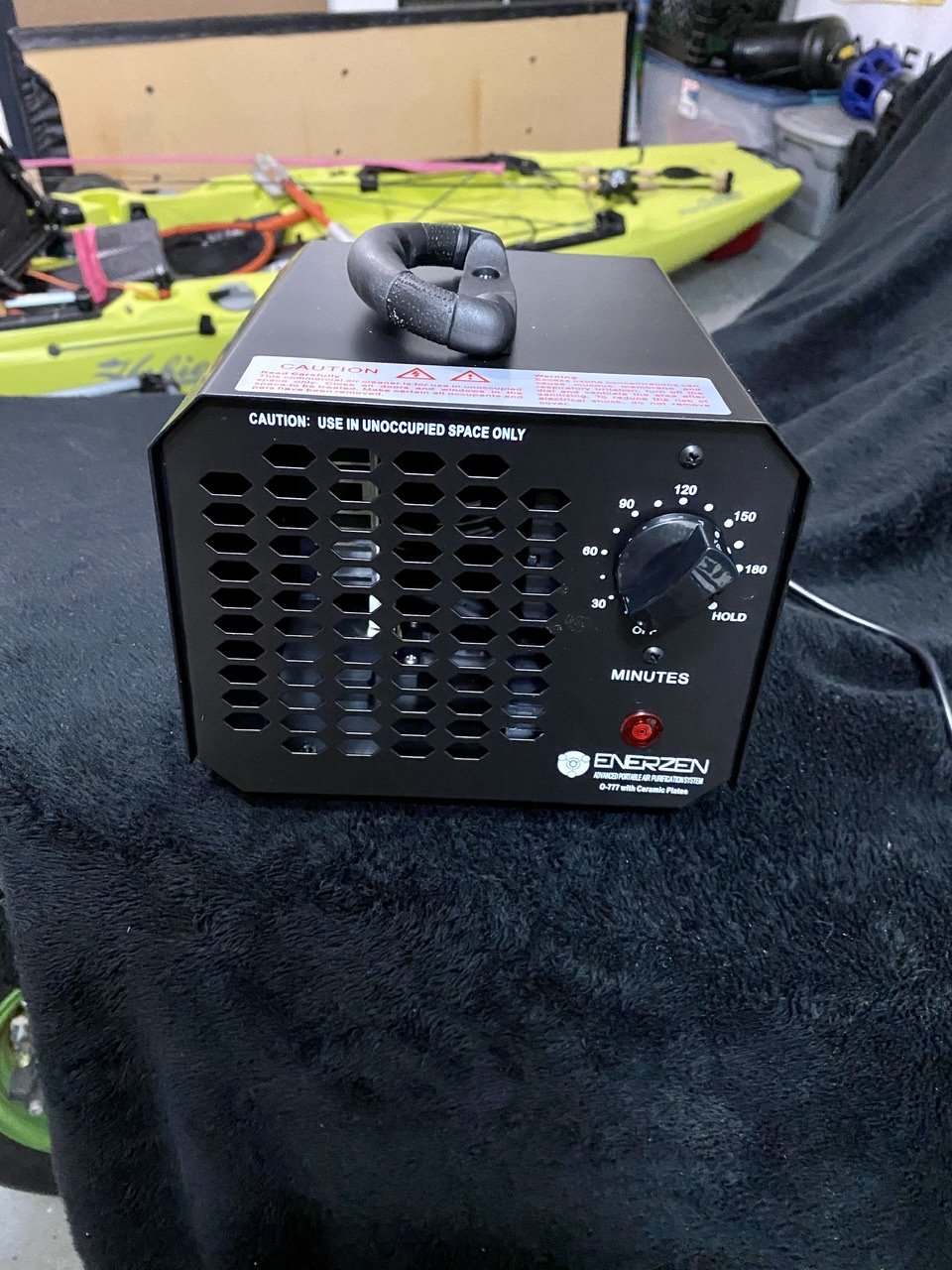

    Ran this bad boy for 30 minutes in the truck and the odor smell is virtually gone

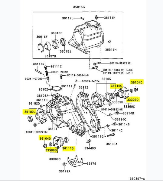

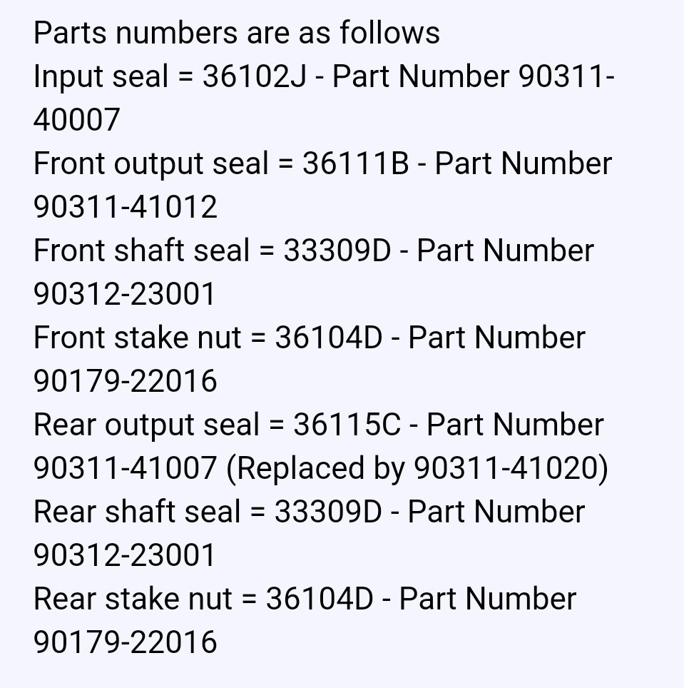

    Just 3 tons of fun!!!
    You rear main seal part # is correct.
    Here are the part numbers for the seals on the T-case.

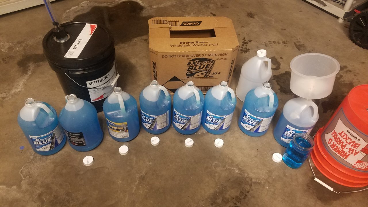

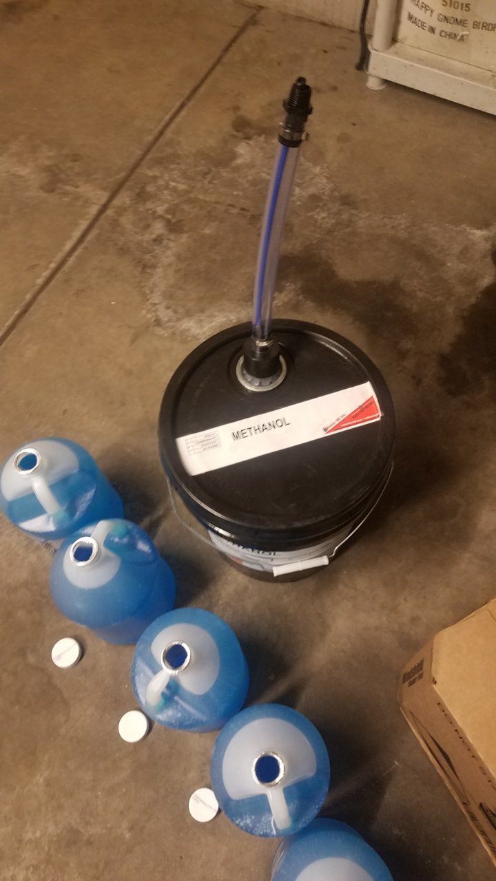

    Keeping the supercharger happy today,
    Spent 10 minutes making me up some boost juice.
    5 gallons of methanol was 40.00
    I take one quart of wiper fluid out and put in one quart of pure methanol in.
    So thats around 50 percent methanol mix.
    So 5 gallons on methanol will mix to make
    20 gallons of boost juice mix using -20 wiper fluid
    So we have 5 gallons of methonal, 20 gallons wiper fluid that mixes to make 25 gallons of boost juice now at 50/50
    That’s 25 gallons total and total cost is 40.00 methonal, wiper fluid is 2.00 bottle.
    2.00 x20=40.00+40.00 methonal is 80.00
    80.00/25 gallons is =3.20
    So if u make your own boost juice this way it will cost 3.20 a gallon.

    Thanks man. That was helpful for 1 seal I was missing. I have all of the other ones already on order.
    Do you have any info on the front diff and a340F seals from that list I wrote out above?
    -a340f output
    -Seals for front diff where CV slides in
    2002Tacoma4x4 likes this.

    Diff seals are -
    Differential/axle seal (left)
    Part # 90311-47027
    Axle tube seal (right)
    Part # 90311-47013
