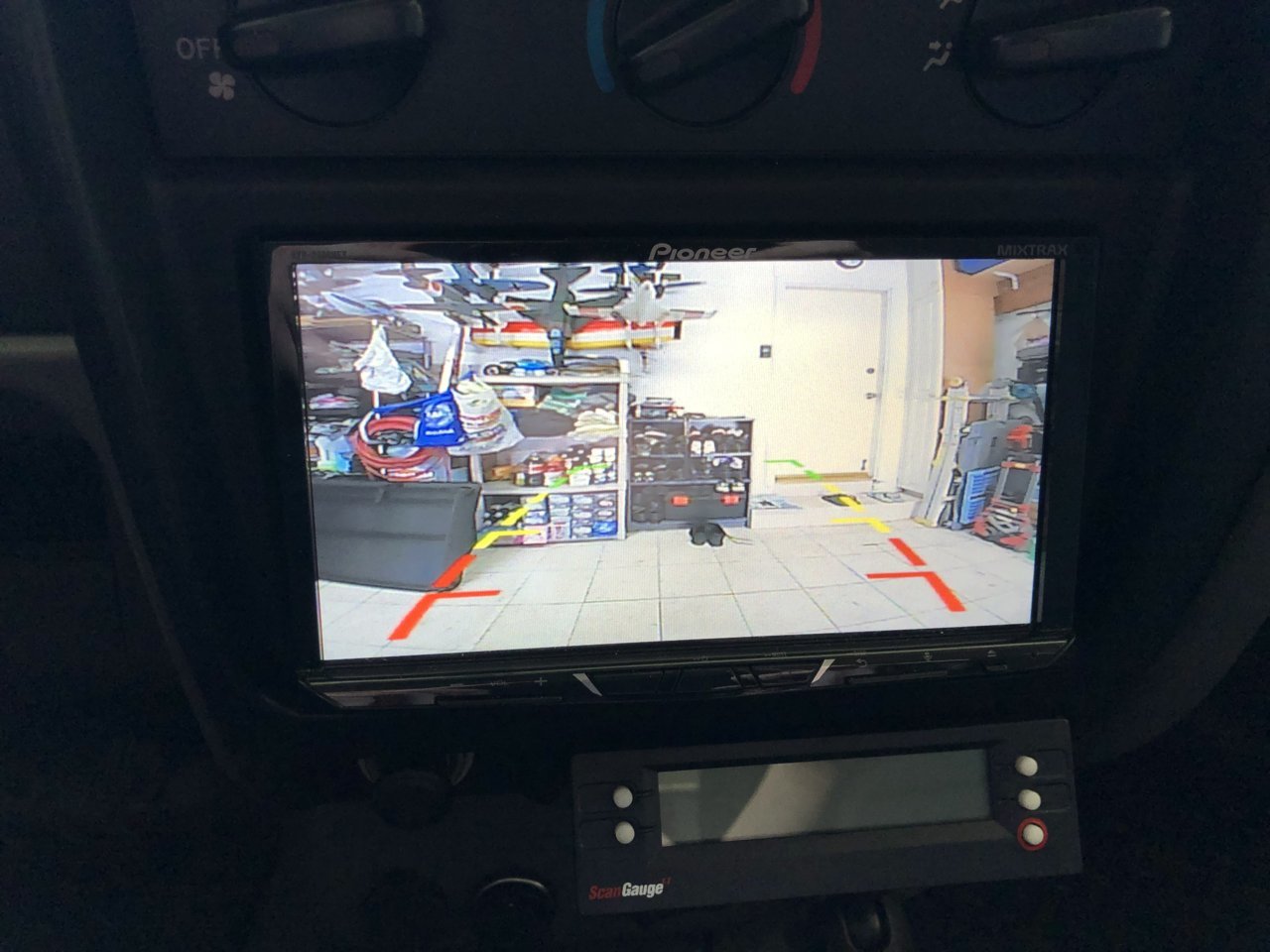

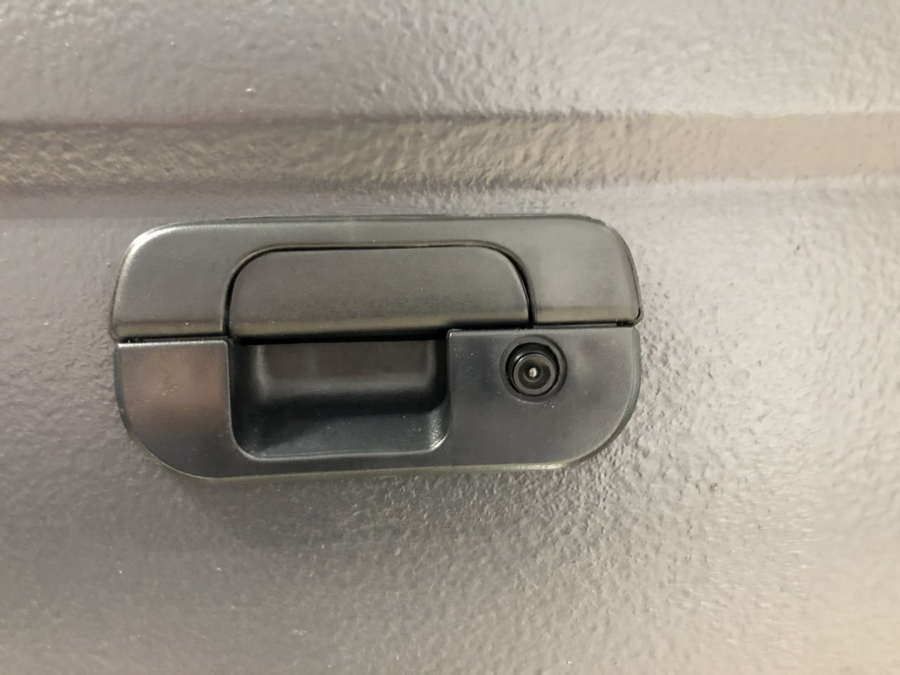

    Installed a backup camera today. Since I have a cap, I no longer need the Pop n' Lock, so I took out the lock and replaced it with a backup camera from Amazon.

    I might do that. theres actually a wire coming off the head unit labeled for reverse .

    Same as mine. It takes a +12v input. I'm running the camera off of the reverse light bulb. The camera includes an RCA cable with an extra wire in it. I used that wire tied into the bulb wire and ran it straight to the back of the headunit.
