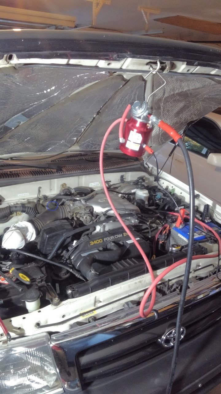

    Hell yeah that vac leak can have that effect. Nice find man. How'd you like that smoke machine? You happy with it? If so, tell us the brand or a link or something. Been wanting to add one to the tools for a few years but have always figured a work around. It would've saved me a bit of time, a lot actually lol:D

    Yeah, well if it sealed the leak it would be worth it. I wonder if the plastic nipple comes with a new air tube. I think I'll try grey RTV first and see if that solves my issue.

    The link for the item is here. Works as advertised and is very nice quality. I almost sprung for the $300 unit that comes with a float gauge that tells you how severe the leak is, but I just couldn't justify the cost.

    The thing looks great! Not bad at all for a 120 bucks wow, I'm kind of excited to use it lol

    The tube and nipple aren't cracked, they just don't form a tight seal in the hole in the air tube. The intake tube is only 5 years old, so I'm not sure why that plastic nipple is giving me this problem. I went ahead and gooped it up, we'll see if it holds. I suspect I have a larger intake leak somewhere down below the manifold.

    Yeah it worked great! It's better than any of the homemade solutions I saw on YouTube, so was worth the 100 bucks to me to not have to use a cigar, or whatever.
    The mineral oil smells bad when it is vaporized, though - be prepared to air out the garage after.

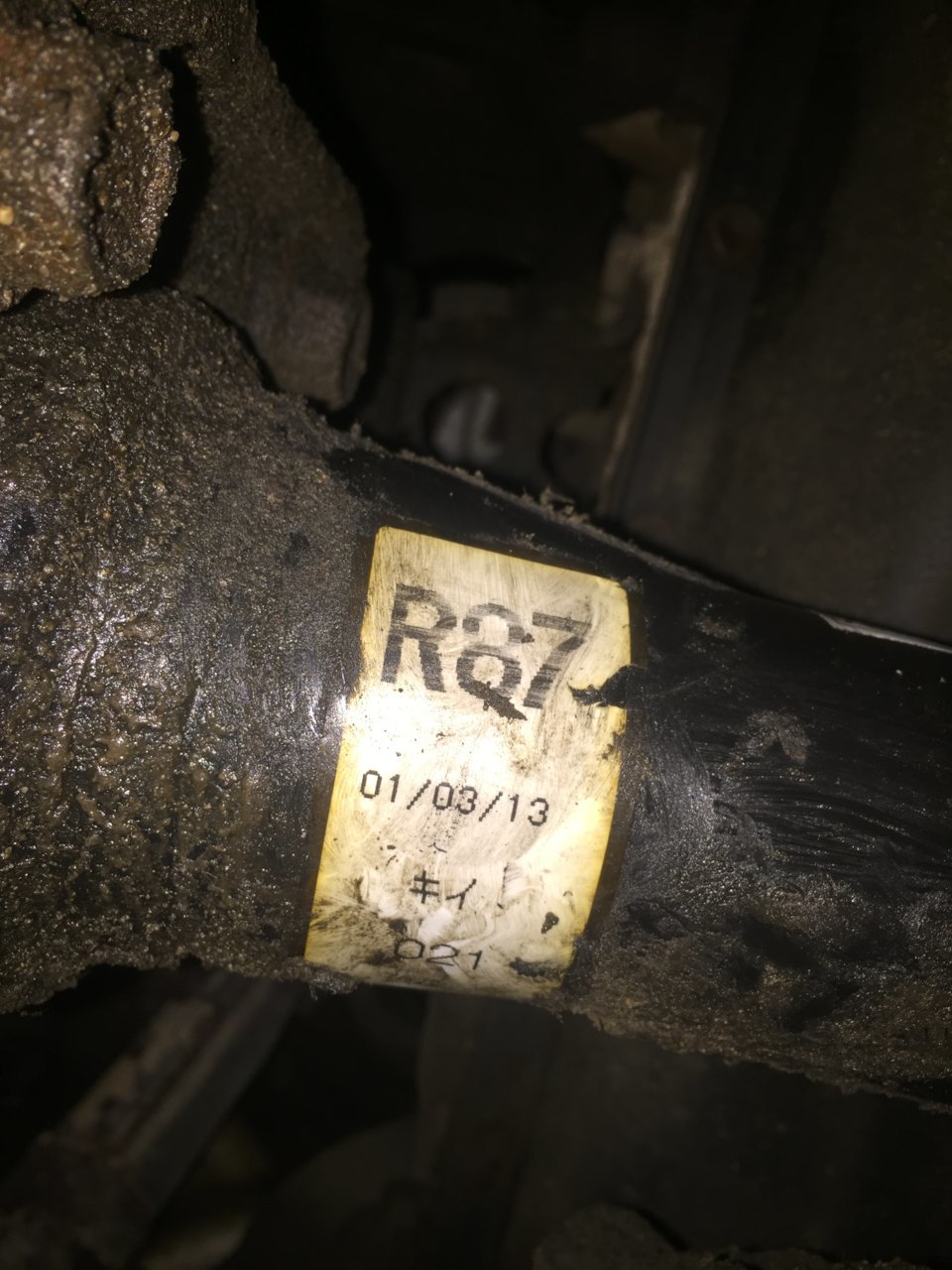

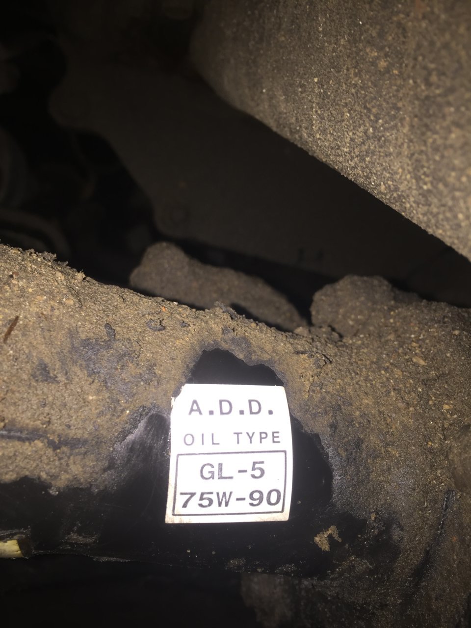

    Found some cool factory stickers while cleaning up my front diff before a fluid change

    Look for the embossed "TOYODA" logo on the steering rack, assuming you still have an OEM. Pretty neat! I thought I had a counterfeit first time I saw that...

    its one thing seeing toyoda on a toyota.
    take a power steering pump off a 2007 dodge charger and low and behold it also has a Toyoda steering pump
