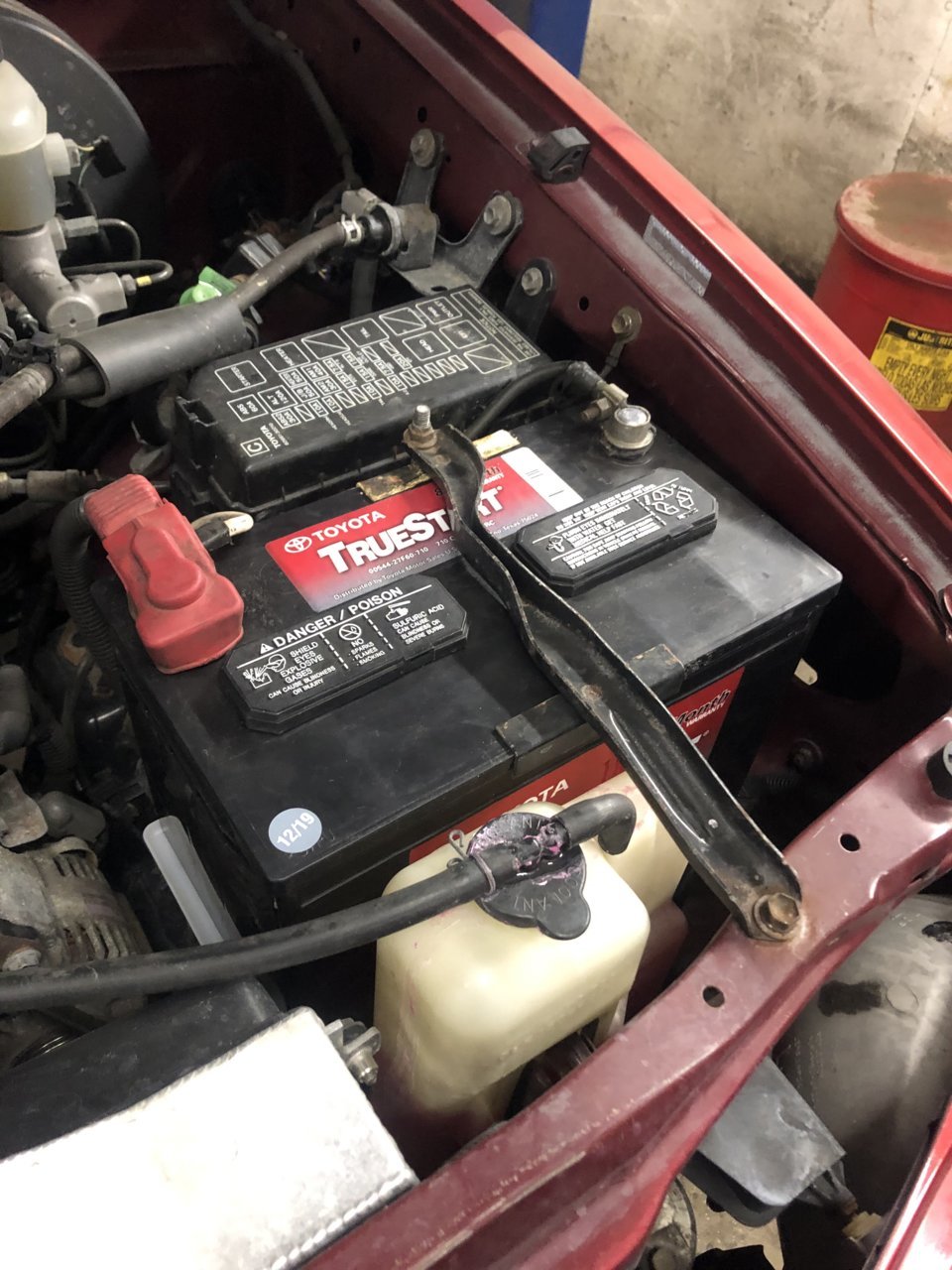

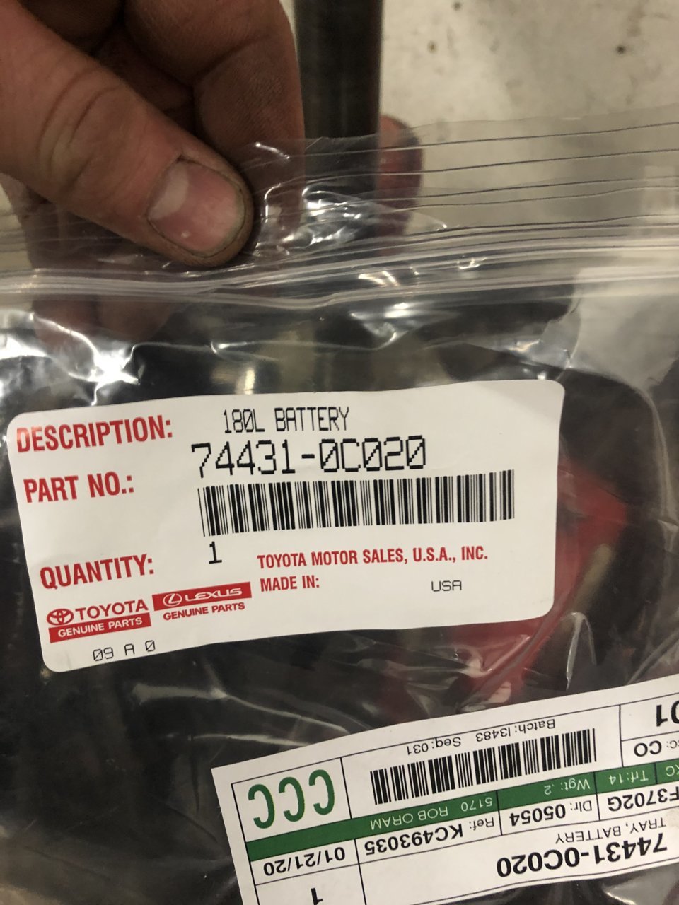

    here you go, I just put a 27 in my Tacoma, the larger tray from Toyota fits right in. I used the stock hold down.
    91AB8571-1BE7-48B3-8509-E96EB152CABB.jpg DD5DFED7-F3DF-4C28-B69A-B5485CCFA589.jpg
