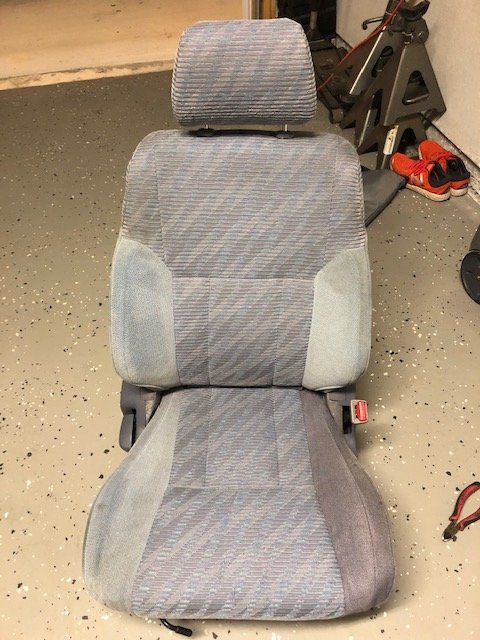

    those look 'fairly close' to tacoma SR5 sportbuckets, very nice!!

    Thanks! They remind me of the seats i had in my '92 Sr5, but the OEM ones i had in the '92 pickup were even nicer than the 4Runner seats. Just thankful to have some lumbar support and side bolsters again.
    GQ7227[QUOTED] and cruiserguy like this.

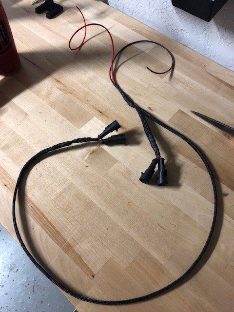

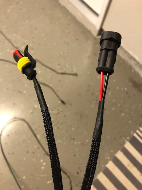

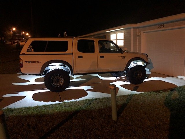

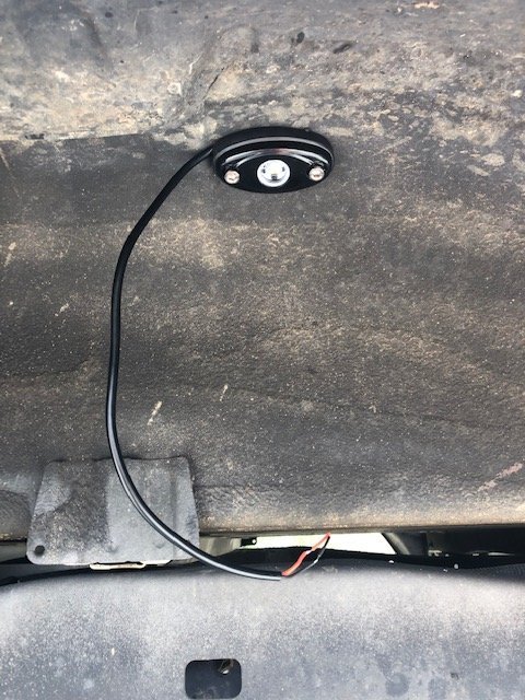

    Finished up some LED s for the front. Installed them over the weekend and got them wired this evening. They are just enough for me as far as extra light without replacing my OEM headlights. I know, they aren't retina blasters, but the really do a good job of supplementing since I don't offroad this truck. Counting the relay setup I have less than $25.00 in this these. I have had them on my other truck for almost a year. Still going strong.
    However, the ones I just bought don't have a good bracket like my originals. Had to make them. Sorry, forgot to take pics last weekend. Just simple "L" brackets.
    Lights: https://www.amazon.com/gp/product/B00G620ZVU/ref=ppx_yo_dt_b_asin_title_o05_s00?ie=UTF8&psc=1
    Switch: https://www.amazon.com/gp/product/B07931ZKC1/ref=ppx_yo_dt_b_asin_title_o01_s00?ie=UTF8&psc=1
    I found an unused option plug behind my left cowl trim (kick panel) and tapped a 12V unkeyed supply. Second pin from the bottom, left side was continuous 12V. There was also an unused weld nut that made a good ground for the light ring.
    I put the fused relay in behind the left headlight and zip tied it to the HL wire harness.
    Due to some reinforcement behind the blank, took some dremel action to get the lock ring to fit in this slot. Just maybe 3-4mm too small. To make the main hole, I just drilled 1/8" holes around the perimeter of the circle, then used the dremel to connect the holes.
    Edit:
    Just walked out and took pics. Obviously they need adjusting, and the intensity of my outside light, make the shot kinda bad. But, you can get an idea of the brightness.
    Also, light ring is pretty bright
