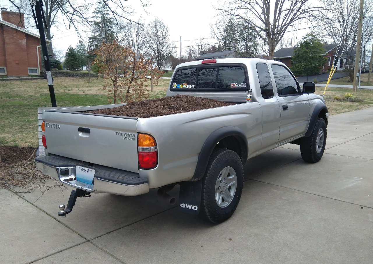

    Painted the mud flaps a couple days ago. Today I gave the leaf springs a workout. Picked up a load of mulch at the local supply yard.

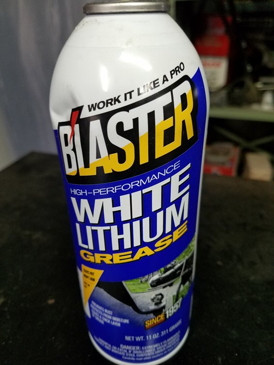

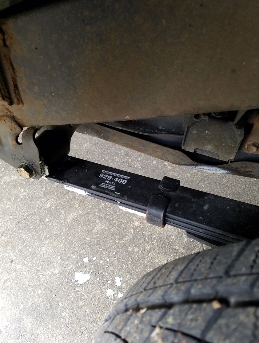

    Replaced a leaf spring some months ago. O'Reilley's brand. Started squeaking pretty soon thereafter. Found it today. Front end of the leafs where they overlap. I had assumed it was the shackle bushing area, but I was wrong. Probably going to be a monthly maintenance item.
    BTW, the spring was about $180, and I only replaced the left side (original broken). Ride height match right side perfectly. Of course, big advantage was no shipping costs.
    PB Blaster lithium silenced it immediately.

    Are there pads between the leafs? If not they’re not too hard to add.

    No, and that's a good point. I slipped some rubber between the ones on my other truck. Thanks for reminding me!

    Beware the white lithium grease is a false hope. Overtime it attracts dirt and makes them squeak worse.
