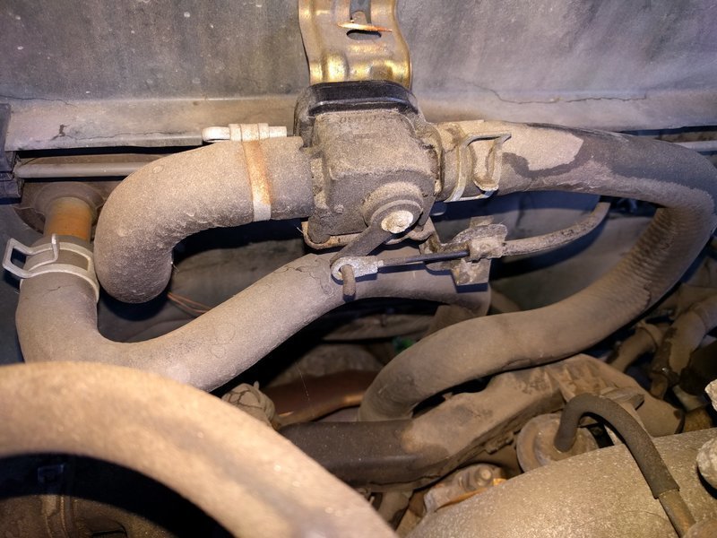

    Stole this picture from the google... I'm trying to remove these hoses from my parts truck without damaging them. I have it all broken down except for the engine side of the hose that goes to the valve.
    Heres my question: How in the hell can I get this thing off of here without ruining it? It's pretty seized up. I've tried a pick tool, twisting with channel locks, and just twisting and pulling the hose. The hoses on my actual truck came off much easier. I would cut it off but the dang thing is fairly expensive.
    Do you guys know any tricks?

    Well, when you put it back on, spray the end of the inside with silicone spray, that'll make it easier to get off next time. :laughing:
    Twisting and prying it apart gently with a rounded off flat blade screwdriver is kind of my go-to for getting them apart.
