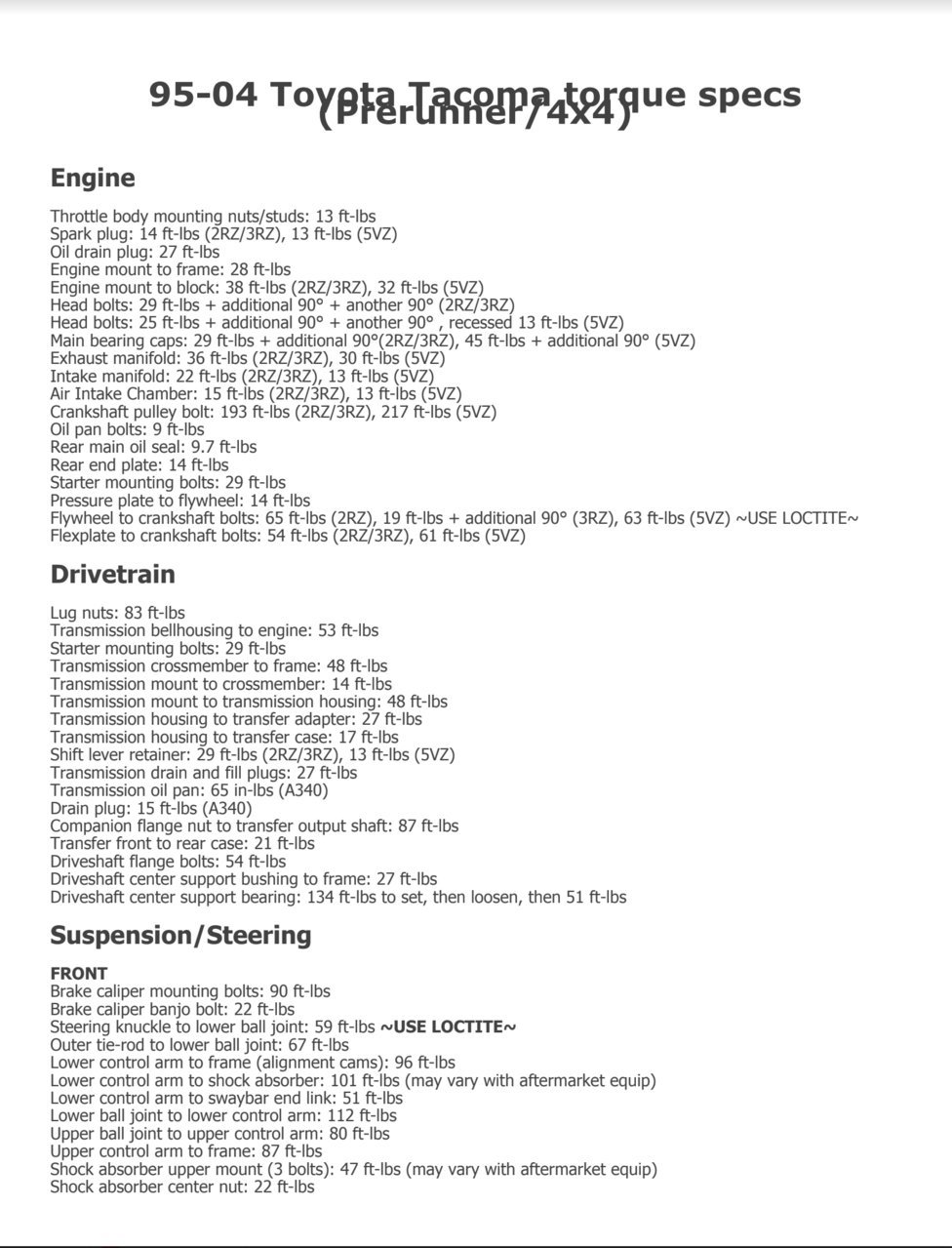

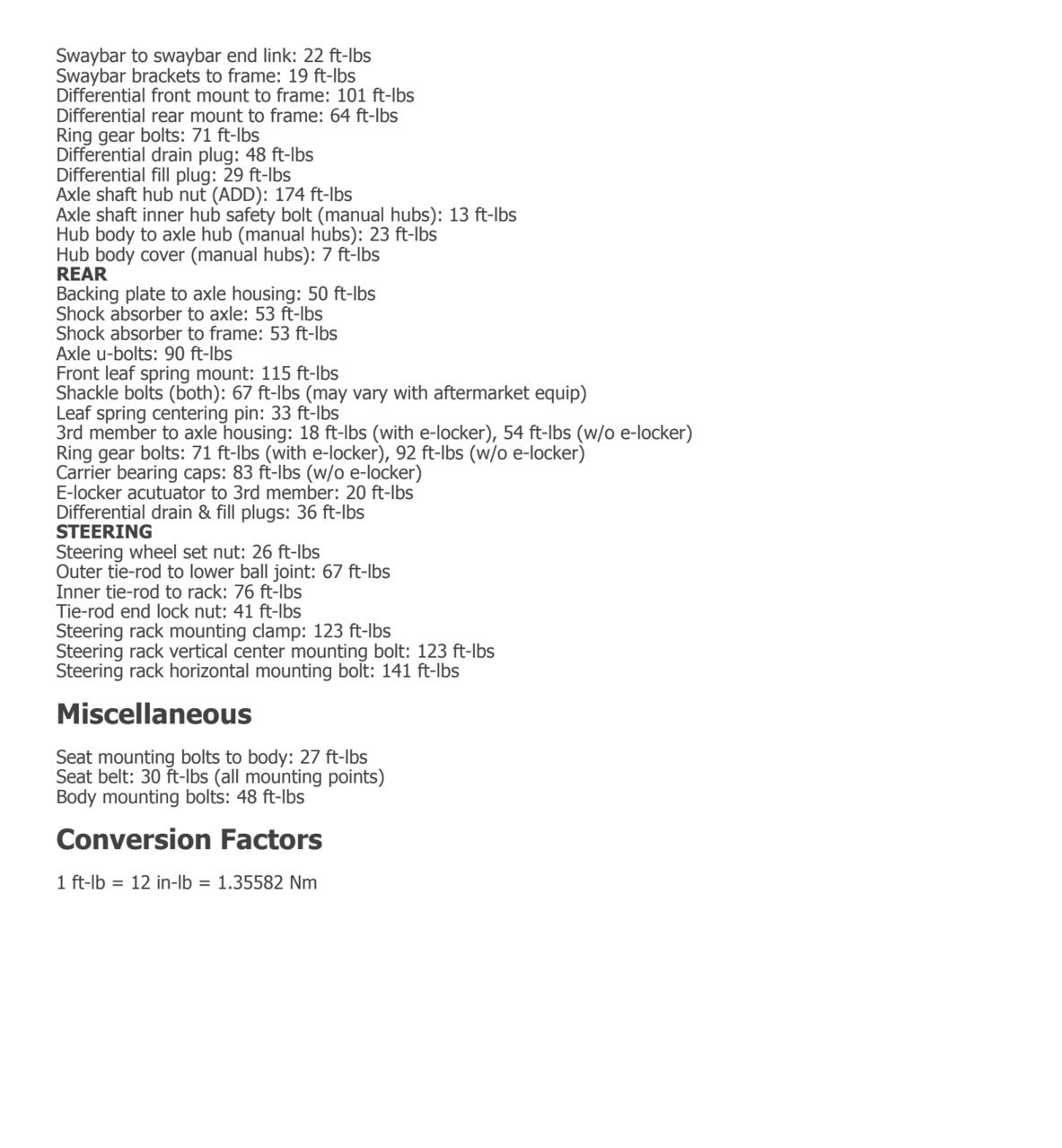

    Also, are there torque specs for the 17mm bolts holding the shock bodies on?
    Thank you for you illuminating replies.
    Running Board Man likes this.
  6. Mar 17, 2020 at 3:50 PM
    eon_blue
    Mar 4, 2016
    #180213
    70,117
    Azusa, CA
    53 ft/lbs
