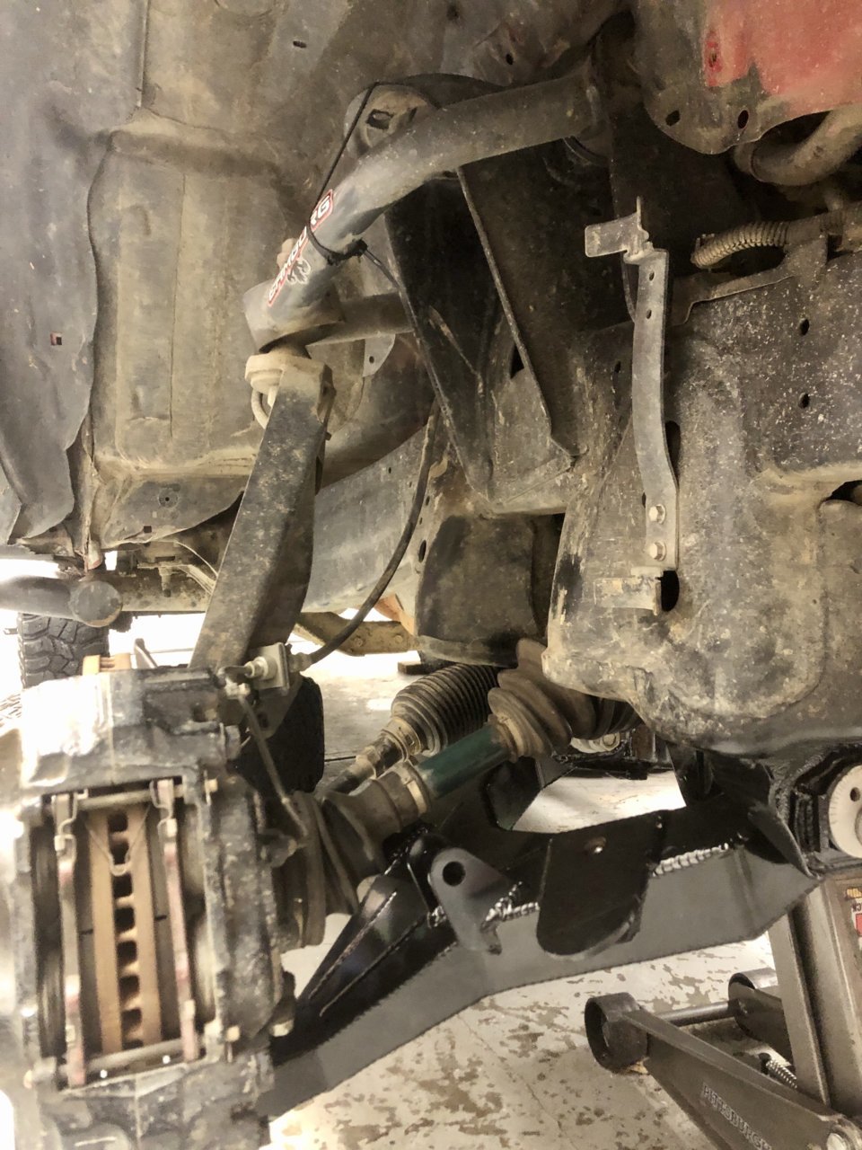

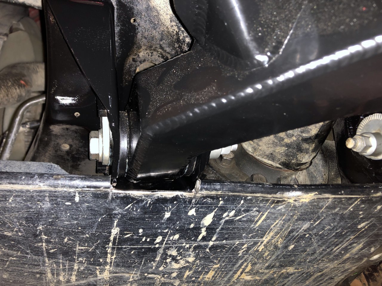

    Drop bracket lift and booger welds
    Is that Lion's back when it was still open?!
    Really love your glass, what kind?
    Do the solo's easily allow the addition of bump cans?

    I ordered mine with that option. I've yet to add hydrobumps but it looks like it should be easy enough. Also ordered mine with limit strap mounts but been lazy on that one too.
    [​IMG]Solo 15 by Matthew Jakobowski, on Flickr
    FWIW, I've been running these over a year now with no LBJ backing off issues. Installed February 2019

    Could you tell/feel any difference from the stock arms?

    Also nothing. I thought about gringing the steering stop tab off the LBJ but never got around to it. This means the steering stop tab on my LBJ makes contact with the LCA at full lock but I'm not at full lock enough to do anything about it.

    This was a concern of mine as well before purchasing. I didn't do a thing about it. The steering rack is internally limited right after where the factory steering stops would normally hit. You'll gain a hair more turning radius as long as your wheels are wide enough that they don't contact the frame. I just try not to ever slam the steering wheel to full lock to protect the rack from any damage.

    Your steering stops hit your LCA? I haven't noticed this, I'll have to check to see if mine do.
