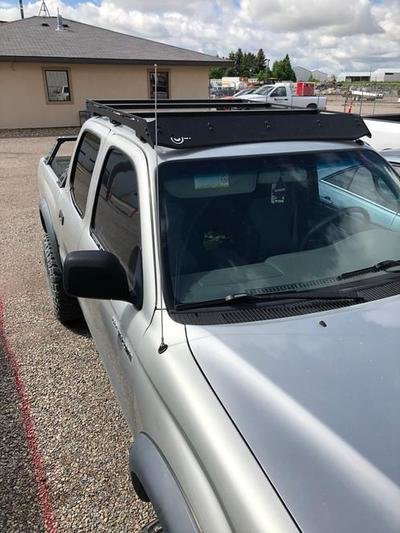

    I recently ordered a Prinsu cab rack during the flash sale... anyone got pics of one on a first get DC?
    edit: and by "during" i mean... at The. Last. Minute.
    Ace115 likes this.
  18. Mar 19, 2020 at 7:24 PM
    Ace115
    Ace115 Well-Known Member
    Jul 2, 2016
    #191086
    1,553
    Andrew
    Tucson AZ
    '03 DBL CAB 4X4
    I saw a pic floating around and I’m sure it coulda been the angle it was taken from but I wasn’t much of a fan and only saw that one pic. I’ll see if I can find it, wasn’t on my truck.
    Regardless post yours up so we can get another view of it.
    edit: I think this one might be from their site but not sure. I feel like the rack might be too far back but idk.
    Yetimetchkangmi likes this.
  19. Mar 19, 2020 at 7:54 PM
    Kreative.Native
    Kreative.Native Member
    Apr 24, 2017
    #217238
    24
    Anthony
    Tennessee
    98 Reg Cab 2.7 4WD
    Check out Steelman_built on IG he had one on his silver DC with plenty of pics
    BeLance89[QUOTED] likes this.
