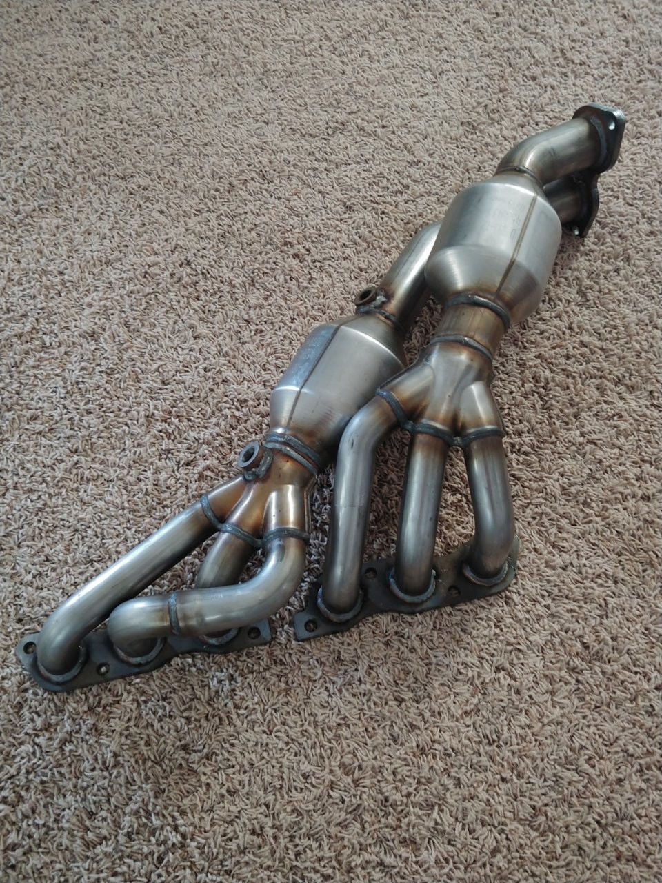

    Sort of unrelated but equally annoying. I got this manifold for my is300 and it rattles. The cats are fine but they left a cutout from one of the O2 bungs I'm the pipe :/

    lol is it trapped in there? no way to dump it out?

    I'm literally fighting with it right now. I dug out my endoscope and I'm pretty sure I see what's in there but I can't seem to get it to dump out. Gonna grab the vacuum
    cruiserguy likes this.

    Got it!
    Appears to just be a MIG dingleberry
    Can see the edge of the seam it was poking through on, my boss would have my ass if I let those kinds of loose wire ends slip by on a customers item. Oh well, all's well that ends well, still a nice Magnaflow product and their cats are decently sized unlike some of the cheaper ones from Walker or Pacesetter

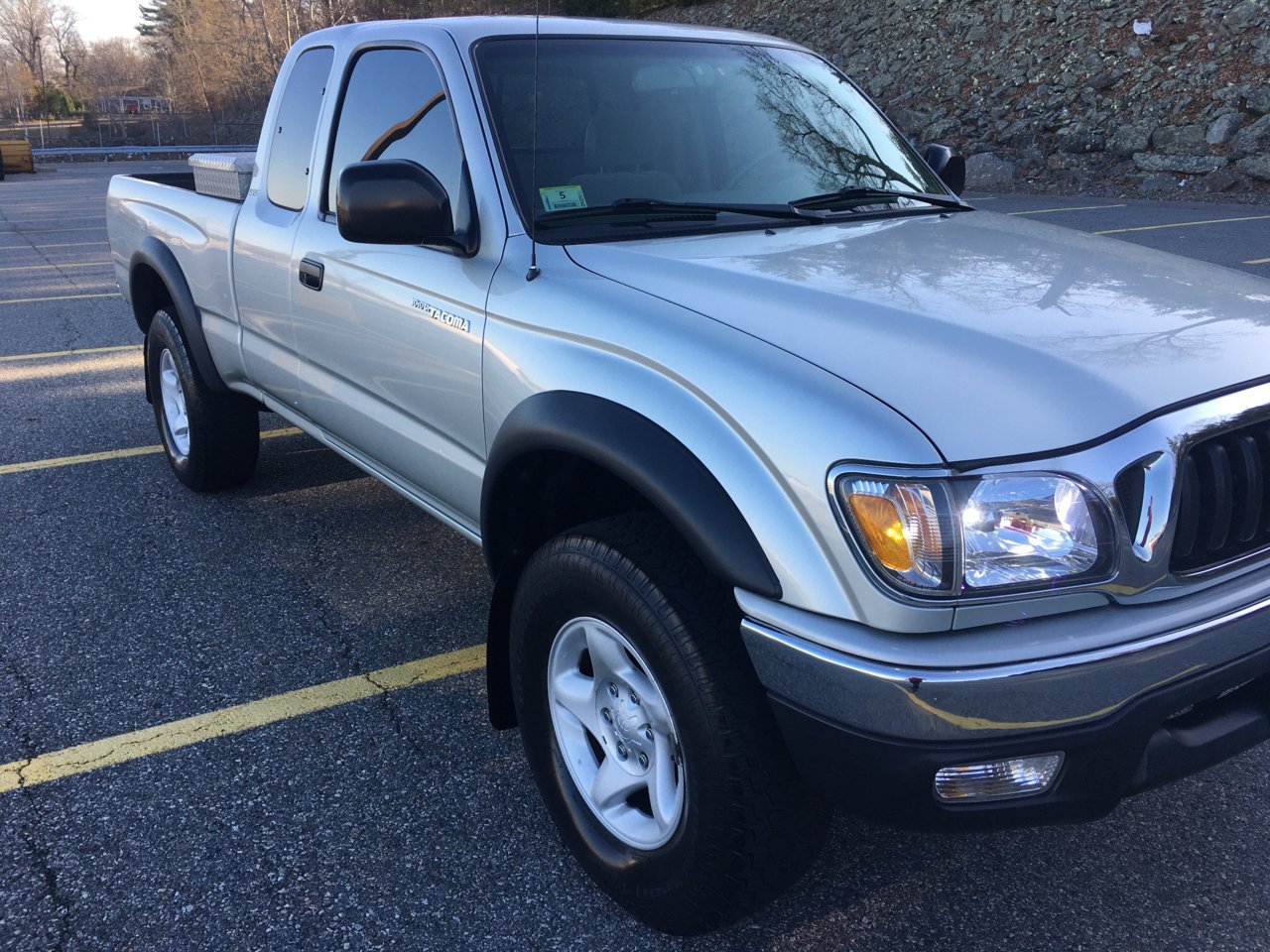

    Just washed Her up and liquid wax
