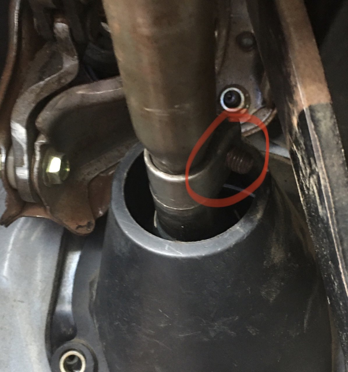

    Found the source of my steering problems almost immediately.
    The retaining bolt for this spline coupler was completely gone. And the splines were barely hanging on.
    Kinda scary, could have completely lost steering if it popped off completely. New bolt and some loctite and no more crunchy steering.
    @betterbuckleup Not sure if this is the same issues you’re having. But this is an easy check
