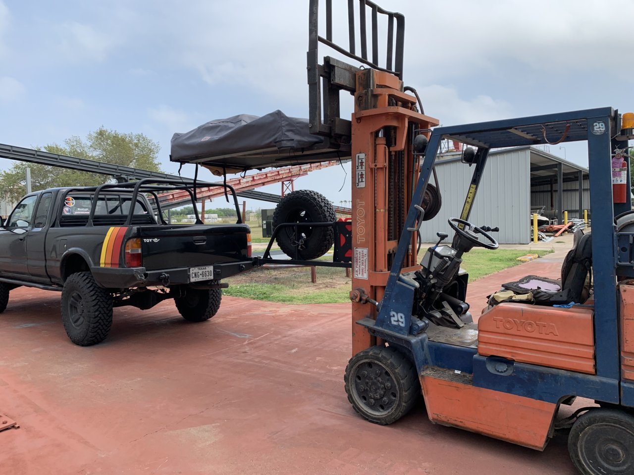

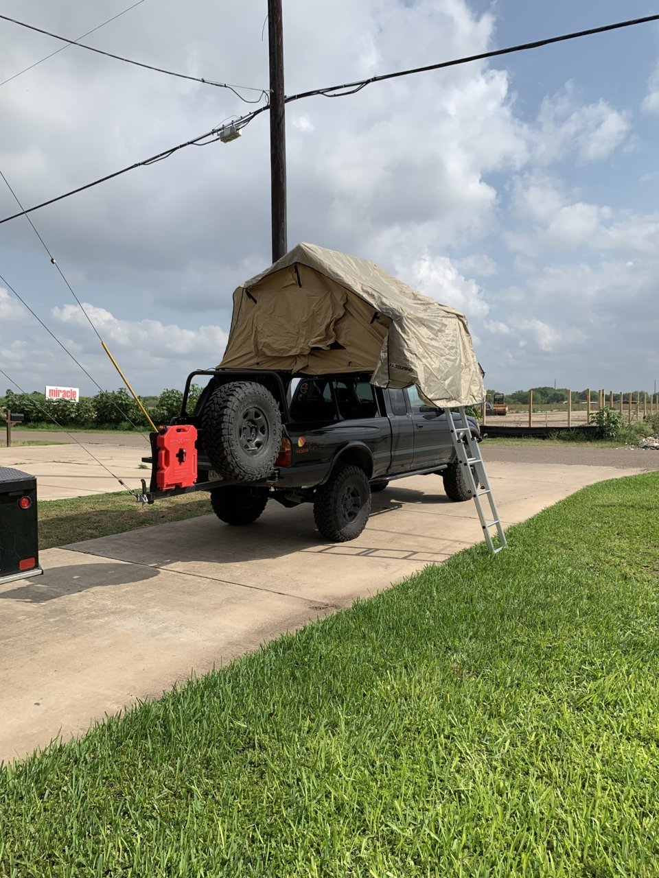

    This is my first real post, but I just installed my ARB Simpson III RTT. I don't know which Toyota is older, the truck or the forklift. Either way, they both still work great. lol

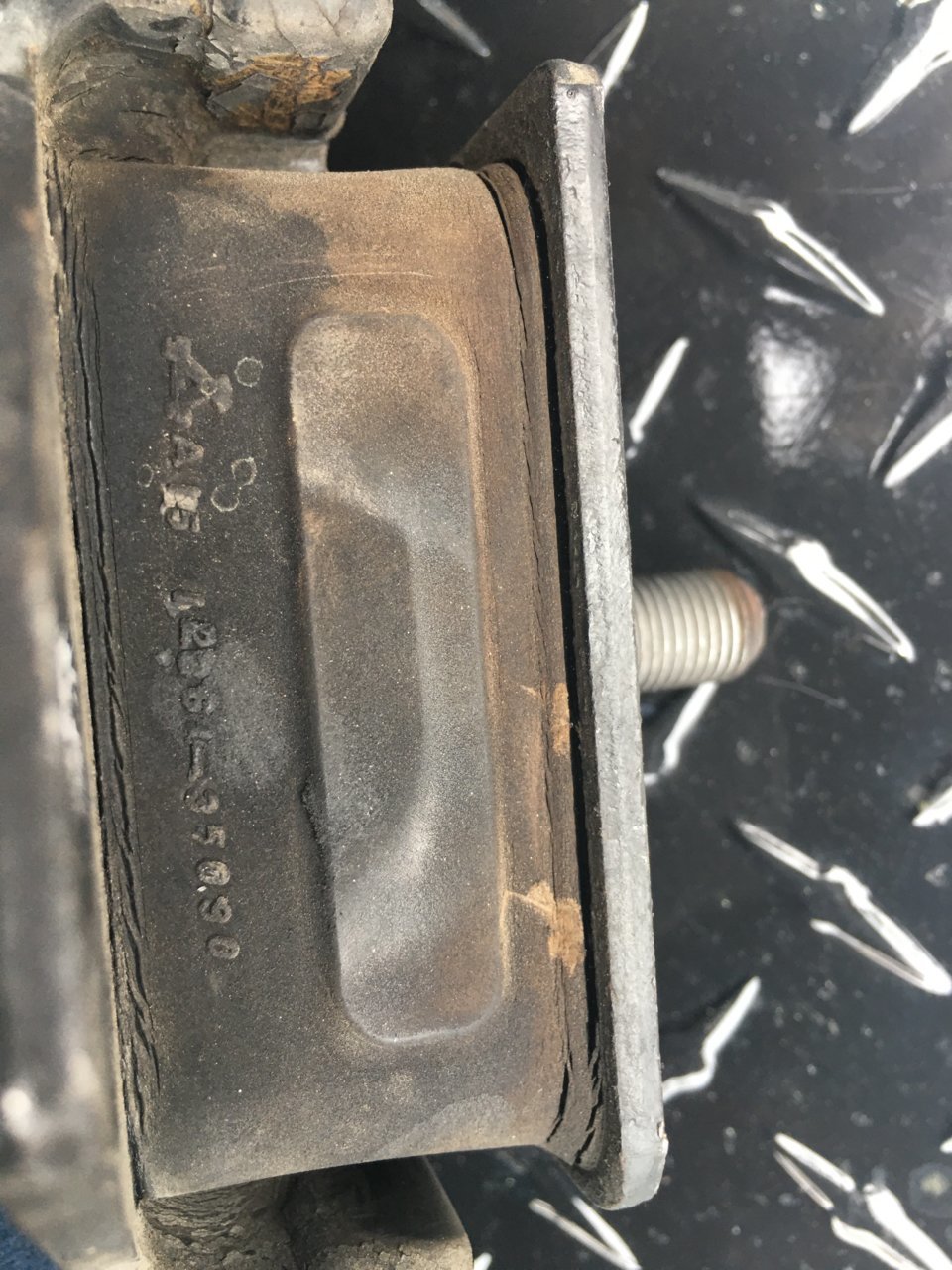

    Finally got to replace my motor mounts after 16 years ! What a difference

    Need to do mine. Did you lift the motor by the oil pan??

    Yes along with a hoist which wasn’t really difficult , it’s my 5 lug 2rz ,mounts are easy to remove compared to the v6 , both mounts are exposed

    hey man, how'd u know they were shot? visual inspection, or there was shaking? Good job btw

    When shifting the engine it would pull hard, I Pressed the gas while holding the brake in Drive and confirmed my driver side was the one with more movement

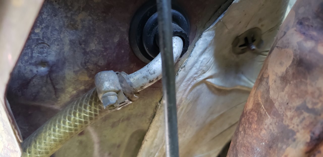

    The drain tube may be clogged. Don't forget to check and clean it out.

    There should be a metal tube that drains past the firewall. I've had it clog up before, a piece of wire works well to clean it. I put a tube on it as well so it wouldn't drip right on the frame.

    I thought it dripped on the nice and hot exhaust on the V6 trucks...

    That's where mine drips. Makes a funny sizzling sound when i shut the truck off.
