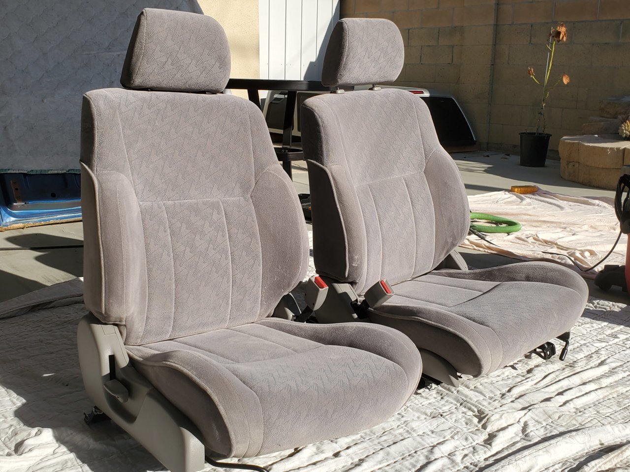

    Well, I was going to offer the first set of SRunner seats I have for you since we chatted about them while back.. but dont think I can store these for that long!!
    These are so hard to find, I would say if you want them you buy them whenever you can... I drove over 800 miles for my second set since I needed parts for my first ones!

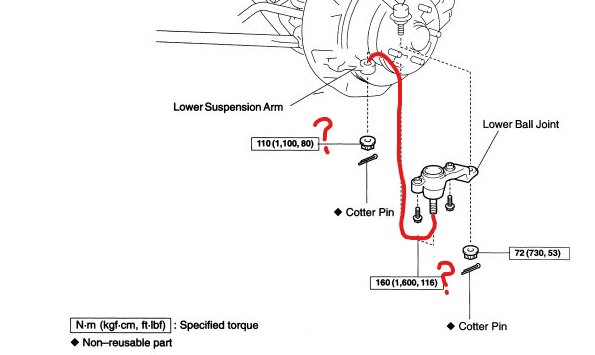

    So after swapping my lower BJs I’m kinda dealing with a dilemma , when i torqued my castle nut I did my research and according to YouTube videos and forum pages the bj castle nut is torqued to 105 ft, so today I’m going through my service Manual that was hidden away in my garage and it states 80ft , anyone confirm This? 04 5 lug

    Hope this helps. looks like 110. 72 for the tie rod.

    You’re talking different units.

    does it say 80 and 53? Are the first numbers part references? If so I stand corrected.

    @fortiz619 was stating torque values in "ft" aka ft-lbf on the diagram.
    The values you are stating are N-m.
    Assuming you have the correct parts diagram (I did not verify this), this should clear it up for both of you:

    Thanks for clearing that up, you are correct.

    Looks like the bJ castle nut is torqued to 80 ftlb and the two bolts that attach to the spindle are torqued to 116ftlb, , tie Rod is correct at 53ftlb , I’m gonna have to loosen it up and retorque my bj castle nut since i torqued it to 105ftlb

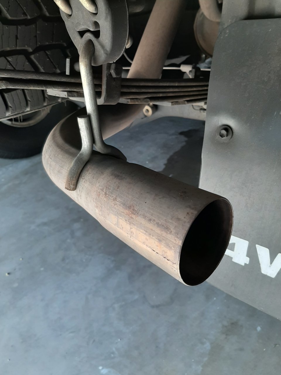

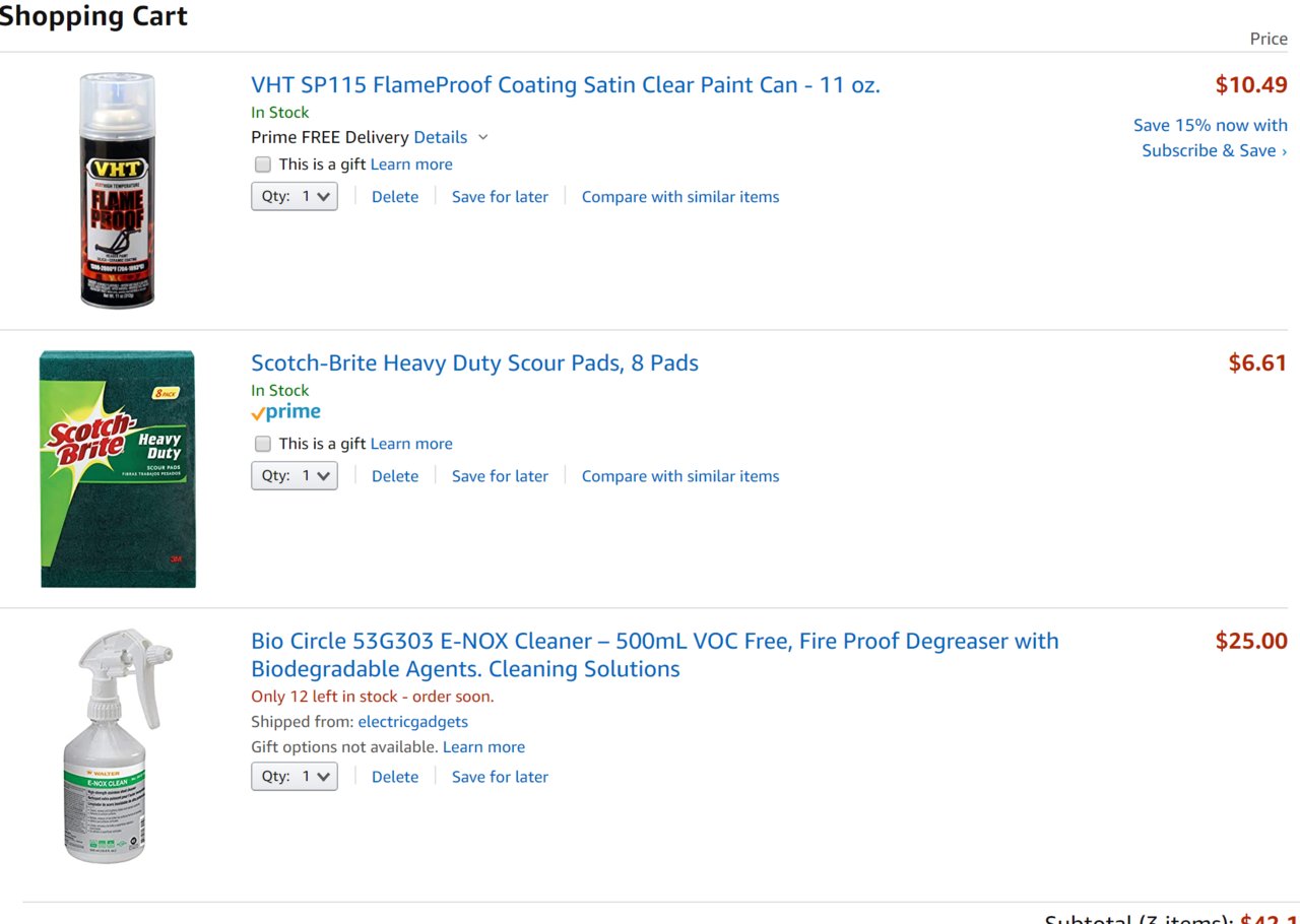

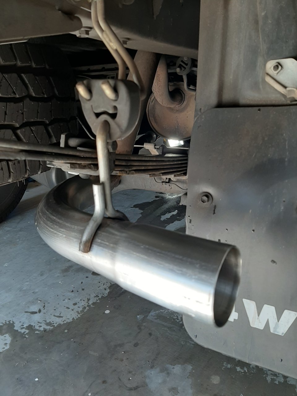

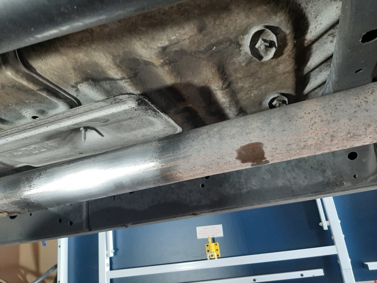

    Polished my exhaust pipe, That's not a euphemism! This phosphoric acid takes rust off of stainless steel with very little effort and won't strip the chromium in the steel like other acids. After I get the whole exhaust + muffler done, I'll clear coat it with VHT - though I have been warned it smells bad. @GQ7227
