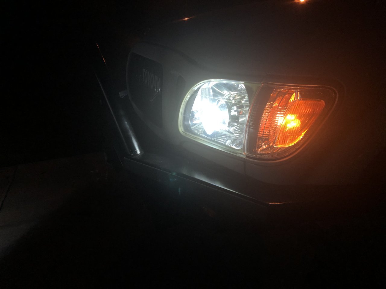

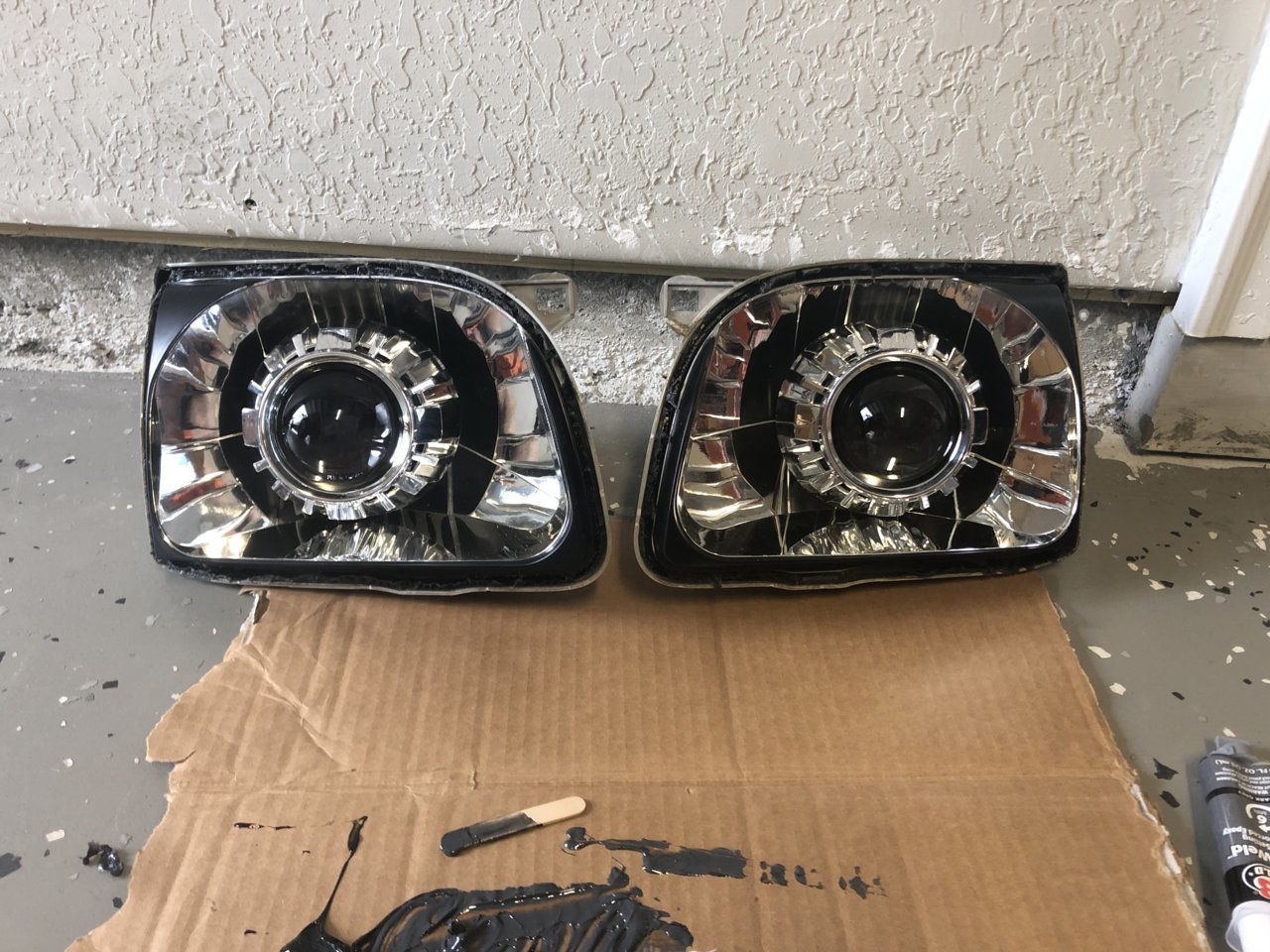

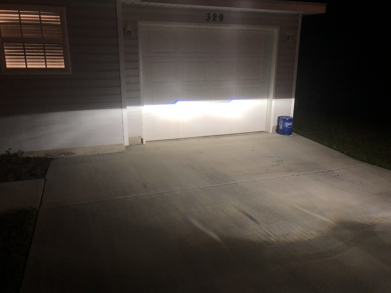

    I finally got around to doing a headlight retrofit since I’m on a 7 on, 7 off COVID schedule. I bought used retrofitted headlights from @UnderFire about two months ago, tore out the projectors and shrouds, and tossed the housings.
    In preparation to doing the retrofit, I purchased new 5500k bulbs, and D2S mounting hardware, and butyl rubber for resealing my OEM housings. It was really difficult to get a secure mount with the old hardware.
    I personally don’t think projectors look better than the OEM reflectors, but the benefit of the light output and clarity is worth it in IMO. The projector headlights remind me of Sid from the animated Ice Age movies. Lol

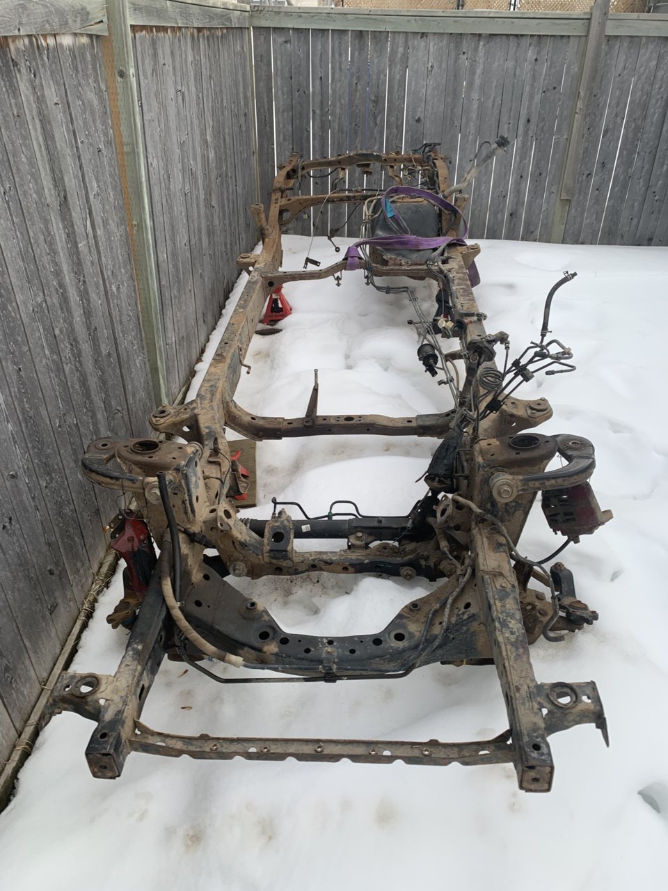

    Well, sold my spare 98, and now going to move the frame from my 00 into the garage, box and bob it, move body mounts, and use it for the 01 double cab.

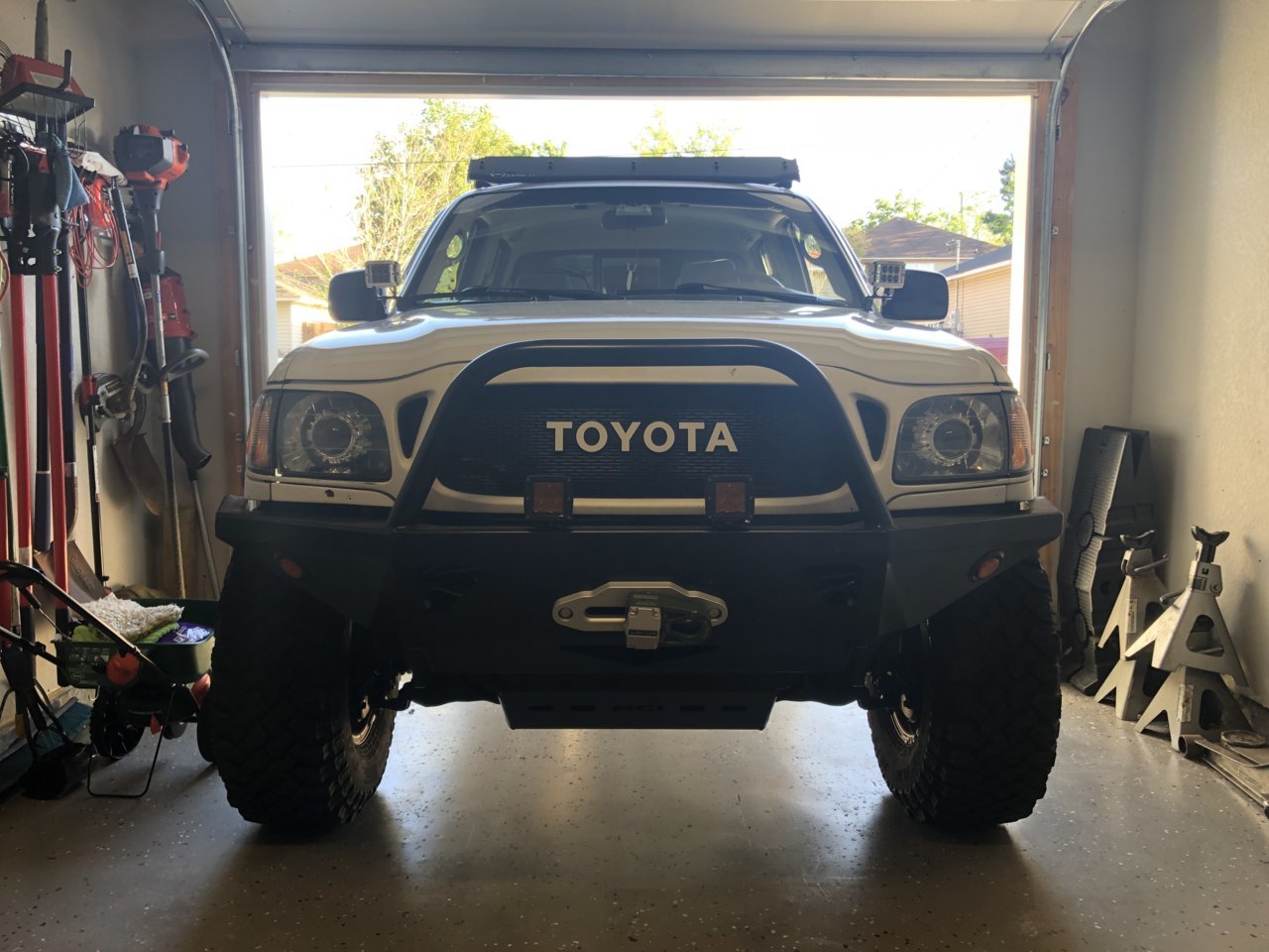

    Finally got around to installing the D43XL add a leafs and axle relocation plates. I’ve always had a problem with the front of the rear tires rubbing and chewing up the fender flare when I go wheelin. I used the 3/4” position on the relocation plates and that worked out perfectly.
    and yes, that is a full size 285/75/16 tucked under the bed.
    Anyone have a suggestion for raising the e-brake cable so it doesn’t contact the leaf springs?

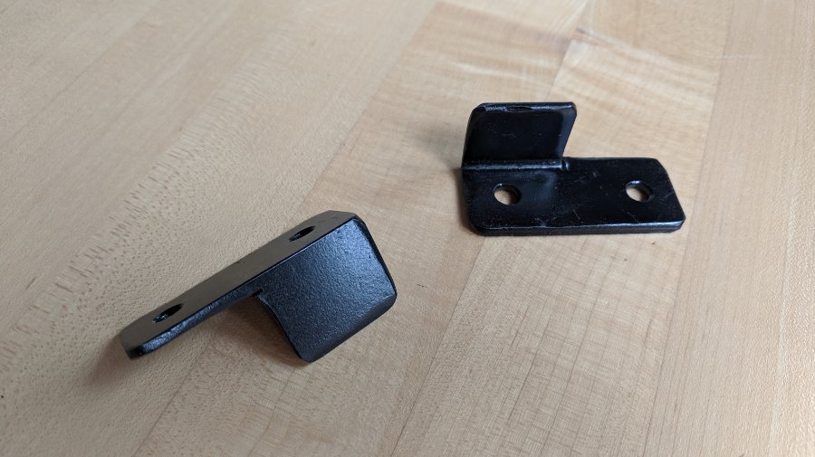

    I made a set of these for myself and Mike @Digiratus, based on some that Dan @drr had on his truck. Worked great and are easy. Made of 1" angle, the total length is 2.5", and gets the cable up off the leafs. Hole next to the short side goes on the ebrake lever, with the short side pointed to rear of truck, ebrake cable connects to top hole.

    Did you make that mount? I have mine mounted there but there is so little space with my charcoal canister.
    EDIT: Just realized that's a paranoid fab mount.

    Thanks @turbodb! I’ll have to pick up some 1” angle and get that knocked out while I still have time.
