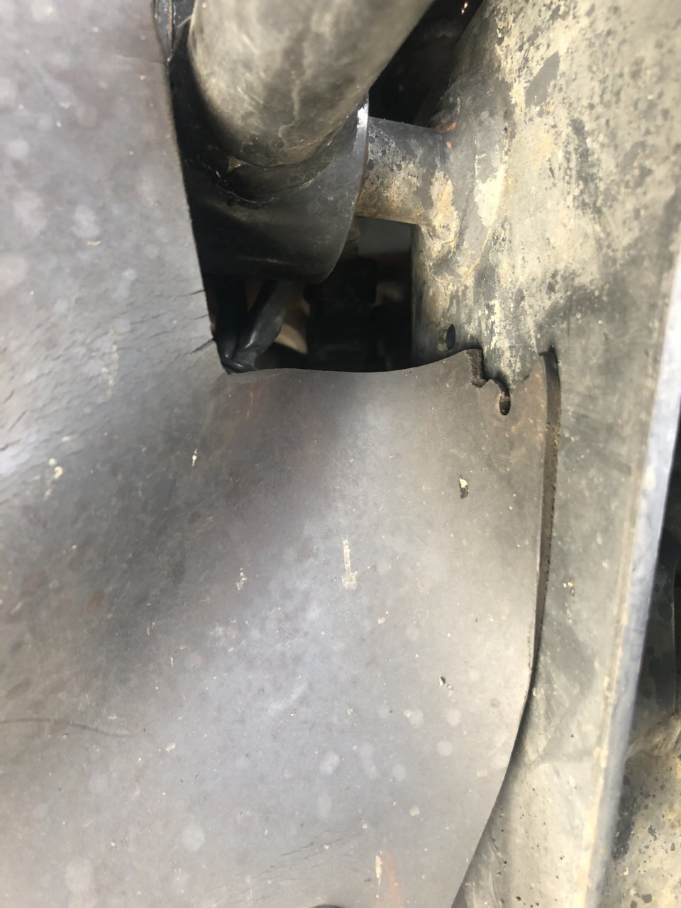

    That’s what I thought too but they started to dry rot over time and that hole is just close to the edge of the material. Here’s the area to keep an eye on.
    I’m still extremely happy with them though.

    Looks like the wrong material is being used here if they can't last more than a few years... Not sure if it is environmental or the UV exposure that caused them to deteriorate, but that makes me happy that I've been waiting to pick up a set.

    Looks like it’s starting to crack in the corner there too. When they showed up they were in plastic bags with some kind of oil on them. Maybe they need some oil rubbed on them every so often or something...

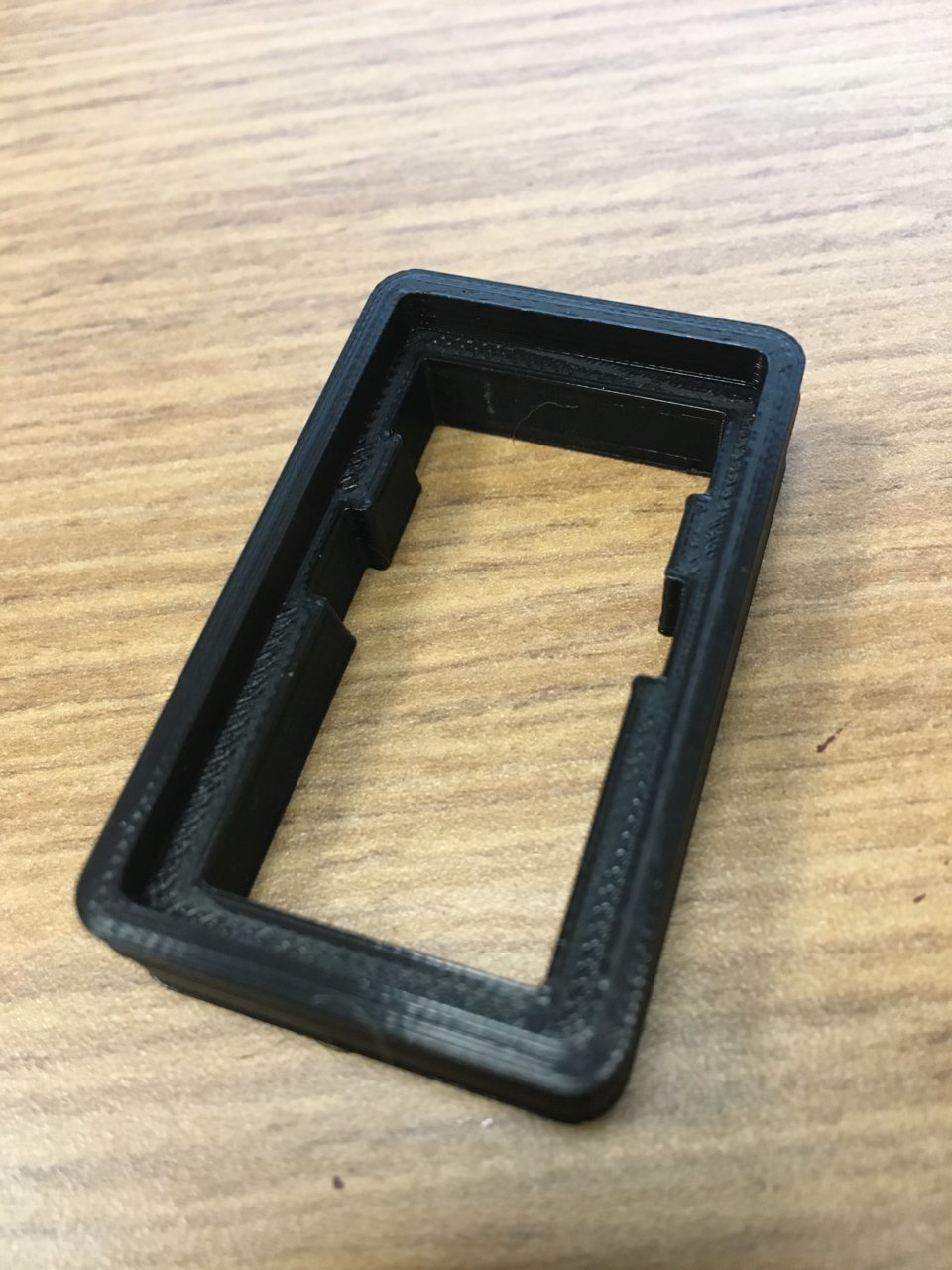

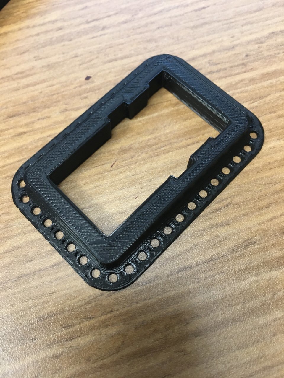

    Started prototyping some stock switch mounts. I modeled these off a part I pulled from the junkyard.
    This one is designed to be glued to the back of a stock dash piece after cutting the rectangle hole. It should make it sit flush. I’ve done this before by hacking apart dash pieces and gluing them on, but I figured it would be good to print my own when needed.

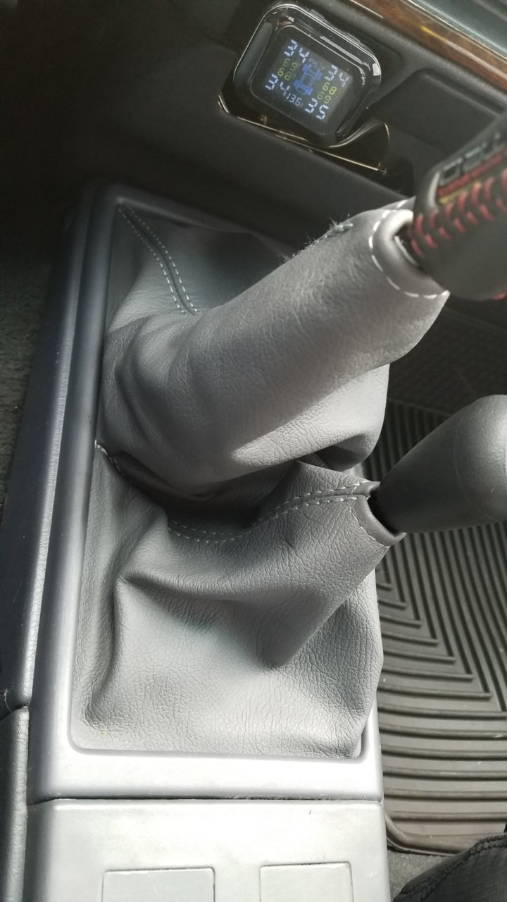

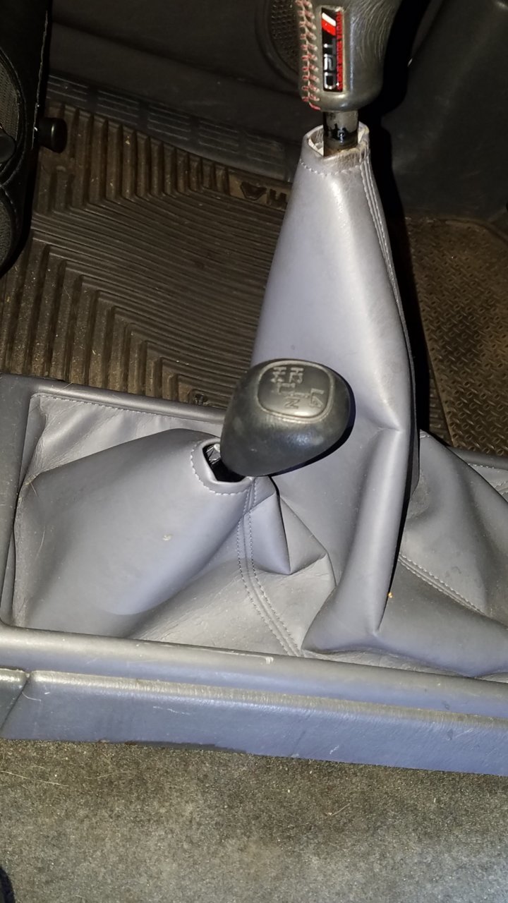

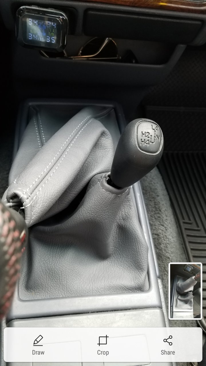

    Installed an aftermarket leather shift boot.
    Looks much better
    The vinyl boot is pretty thin
    The new leather boot is thicker so it needs
    to be glued from the underside because it won't fit into the clips that qere for the thin vinyl.
    Before and after
