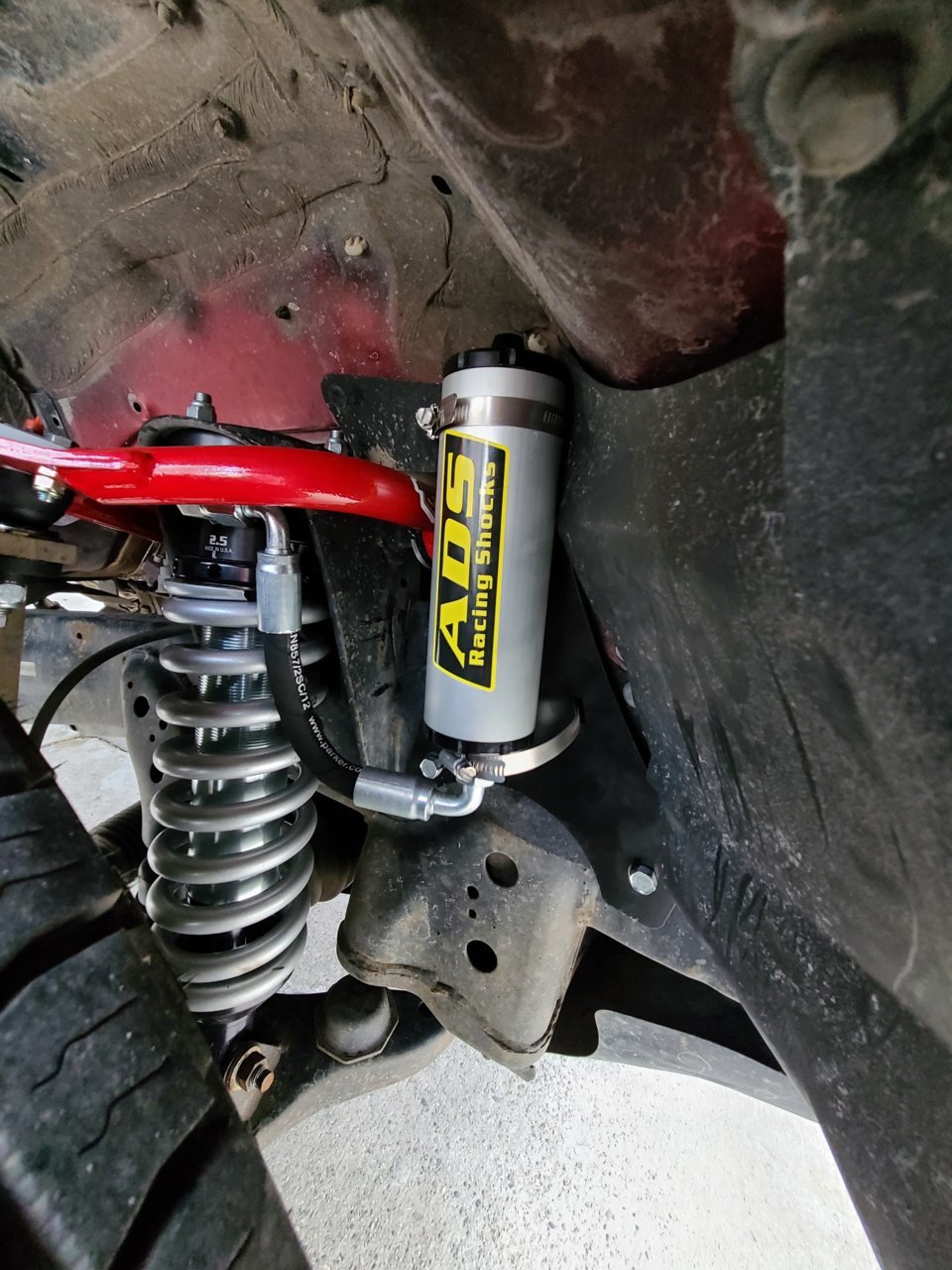

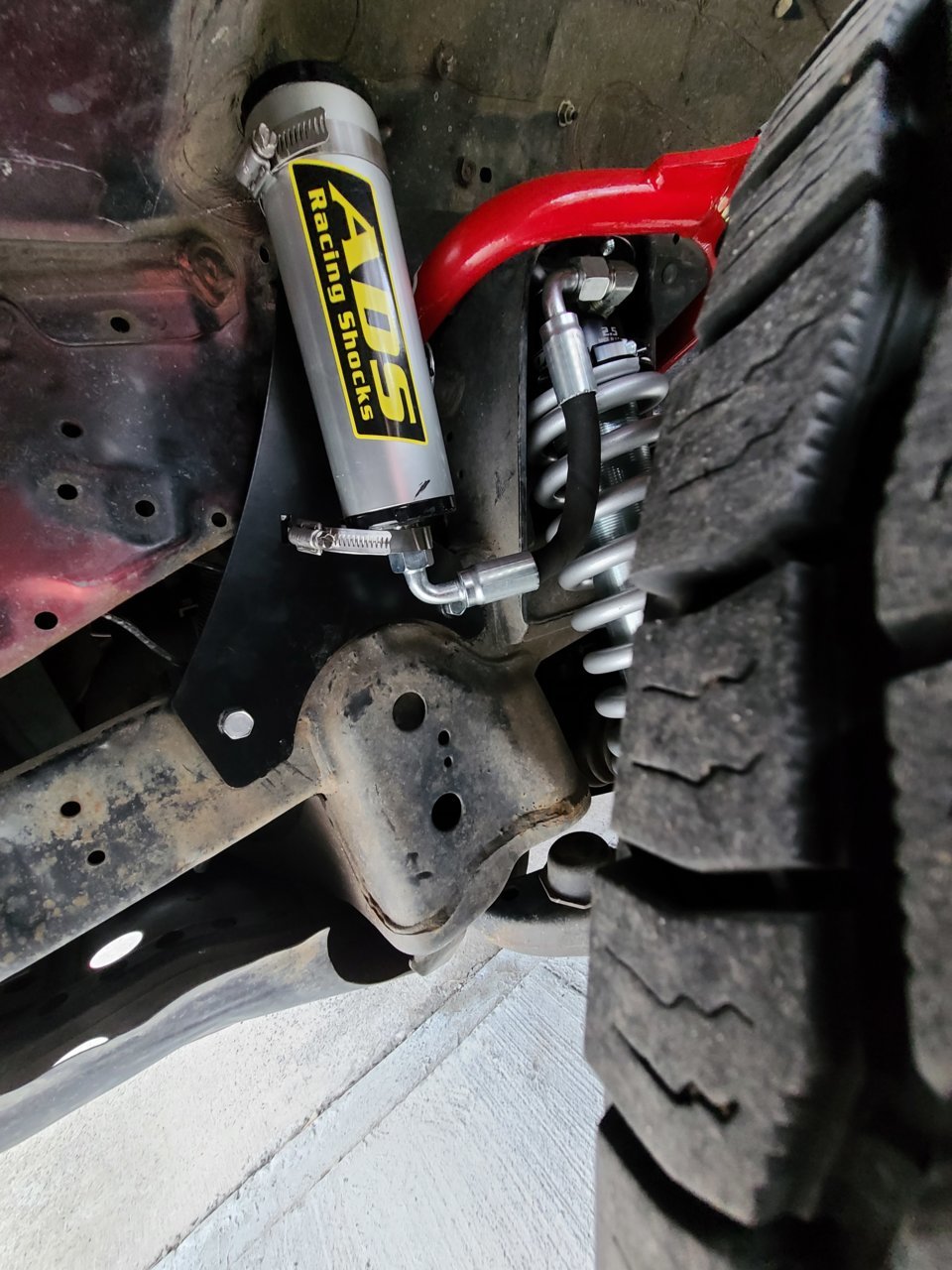

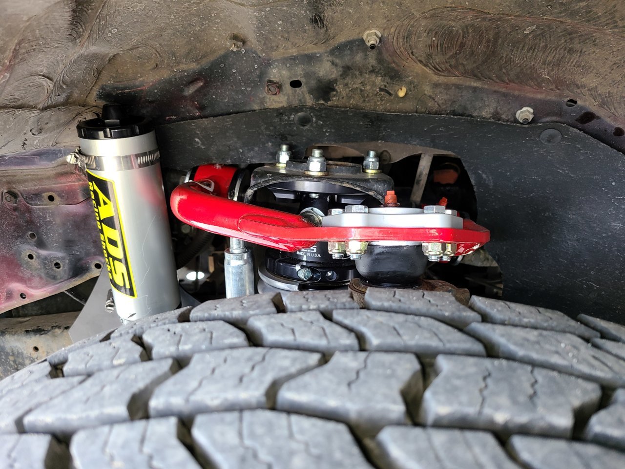

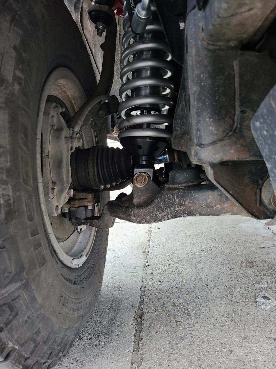

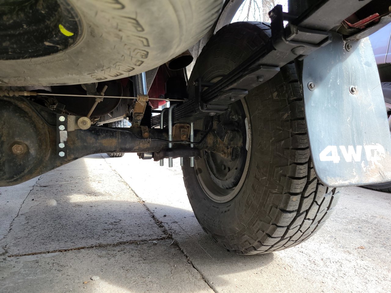

    Finally got around to upgrading my suspension.
    Deaver leaf springs
    5100's
    ADS resi coilovers
    JBA upper control arms
    20200407_110244.jpg 20200407_110252.jpg 20200407_110335.jpg 20200406_185729.jpg 20200406_185705.jpg 20200406_185752.jpg 20200406_185918.jpg 20200406_185942.jpg 20200406_190659.jpg 20200406_175646.jpg A little disappointed on the length of the resi hose but I made it work...

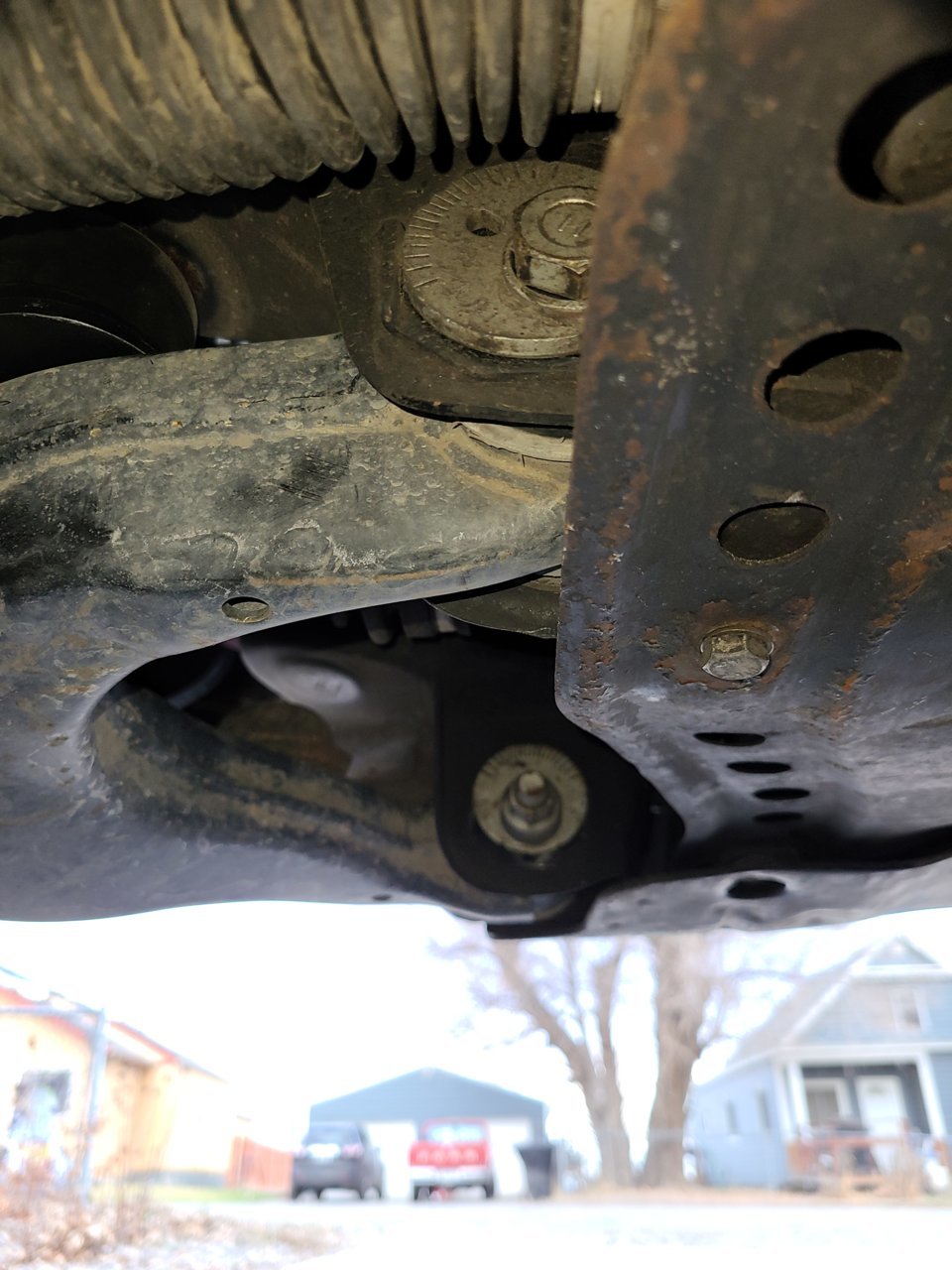

    Any thoughts on the alignment numbers? I feel like they could be better...

    That's a shitty alignment. Tech probably had no idea what they were doing, or your cams are frozen.
    To get the most caster, the back cam would be all the way out, and yours are exactly the opposite. Not to mention you front cams are neutral, so way more adjustment available. So at the very least you can get way more caster, and probably get camber closer too.

    Cams are good. Put Whitelines in 2 years ago. Cleaned and lubed everything up real good on install.
    He said that that the -.4 was the best he could do with the passenger camber and that something might be tweaked, preventing a better number there:notsure:
    I told him I would like to see my caster numbers around 2.4-3 and he told me he would do it but that I would be back because the bump steer would be unbearable. Some rough numbers to shoot for would be greatly appreciated if my expectations on 2.4-3* caster and 0 on camber and toe are unreasonable

    I'd take it to another alignment shop, or better yet, learn to do your own. You have tons more adjustment left, so I don't know how he could say something is tweaked.
    Your expectations are not unreasonable. Your truck will drive better with more caster, and also, you have greatly decreased your tire clearance to the firewall with your alignment like it is now.

    Is it your intention to drive people nuts with the way you have those bottom worm gear clamps?

    I was about to ask wtf is going on there as well.

    Are the hoses too short to mount properly?
    "disappointed on the length of the resi hose but I made it work..."

    Ya, they're shorter than they should be. No way to get them to sit how they should. Mine v @Blackdawg

    Yeah. They made those way short.

    whoa. That sucks. I'd contact whoever sold you those and ask about it.

    Ya, it was a pretty big disappointment finding that out during the install. I've asked about it but haven't heard anything back yet

    @01Montaco I recently installed mine as well and same thing the hoses were way too short. I'm curious to know what you hear back.
