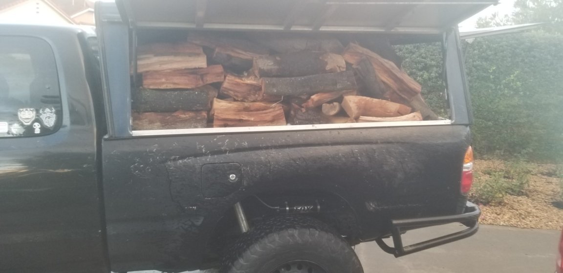

    Damn, that quarantine boredom is hitting hard, huh?
    What kit are you running outside the frame? I am assuming you are still on a smaller tire?

    Fox 2.0 12" on the @ARCHIVE hangers
    yeah, those are my smaller set. 265 75r16 i think. i'm on 285 70r17 now, but will be going 255 80r17 in the next week or so.

    No rubbing? Spacers assumed right? Tire width is the only thing that kept me from going outside.

    Yeah the 285's rub at a full articulation (not alot but enough that i don't run them crawling) The smaller ones don't rub at all. I'm hoping the 255 will be money. I've got 2" spacers now, i know, not ideal, but they work (i've been running 1.25 up front forever and never had issues so i don't mind running them in the back) make sure they are always torqued with Loctight. Eventually i'll want a wider axle, but those days are in the distant future. thats gonna be another can of worms i don't want to open just yet. For now the setup is tits.
