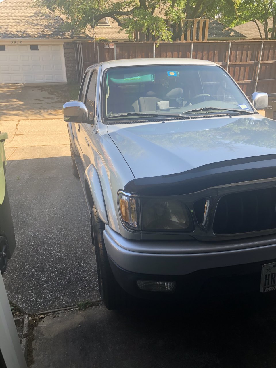

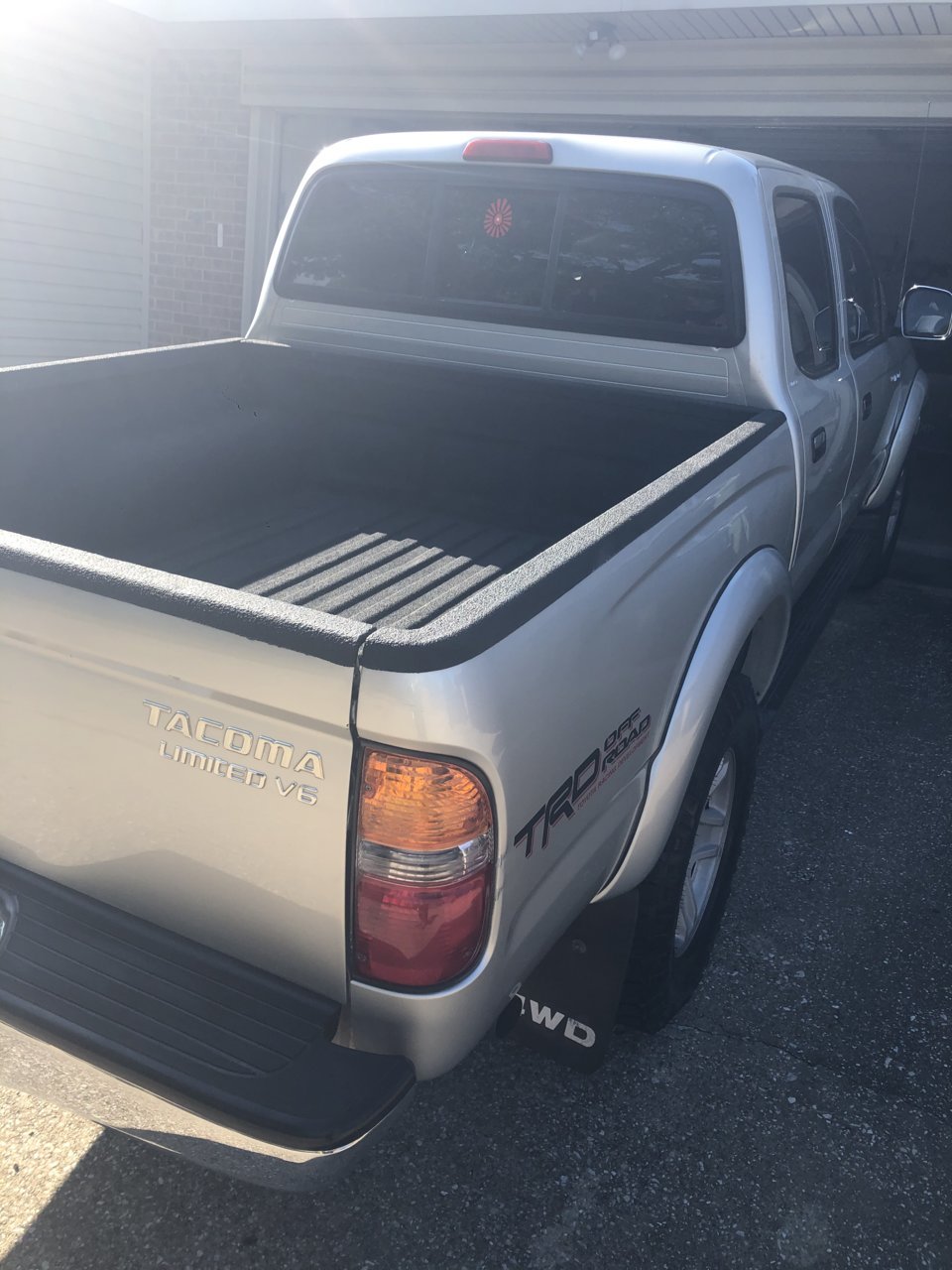

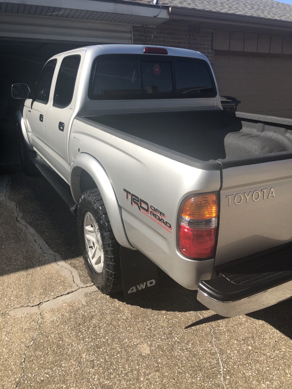

    C0EB6384-A475-4D0A-B523-6ECFFADDC67A.jpg 201F2277-AAE4-4E51-8CA8-CD2C2A5A4ADE.jpg D1D0A74B-4A21-45A6-BE1D-EF08E0C08F67.jpg D59BE72B-2DBE-4745-8829-E7E96DCD03F3.jpg Nothing comparable with what you all guys do... but I spend 2.5 hours Hand washing , waxing truck , ready for next couple of seasons:cheers:

    Keep the stock clean ones alive its refreshing seeing one not bro'd out
