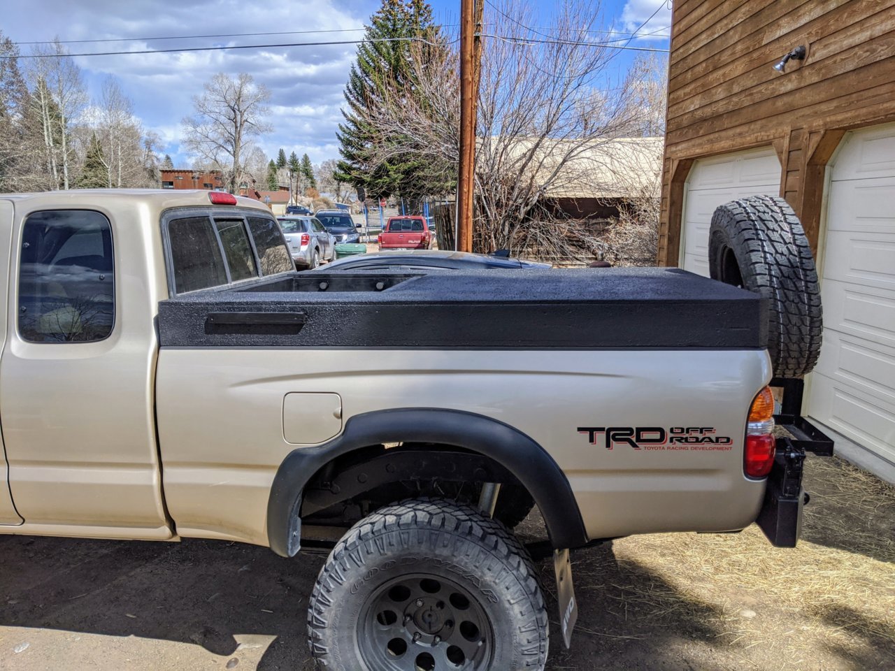

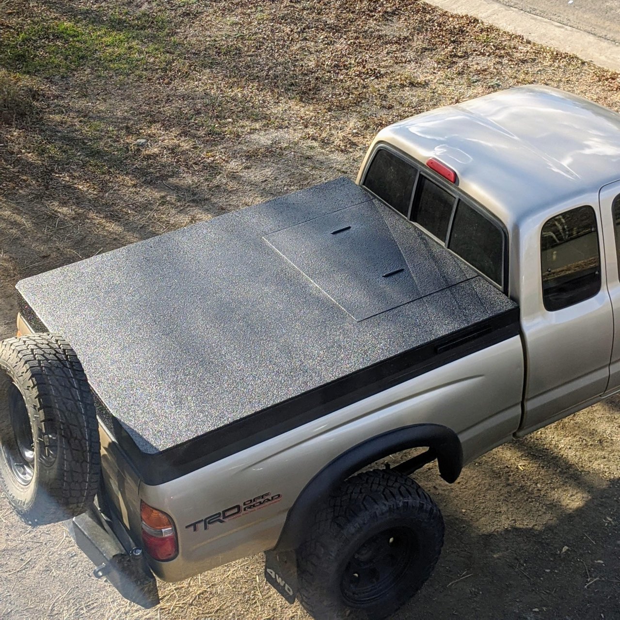

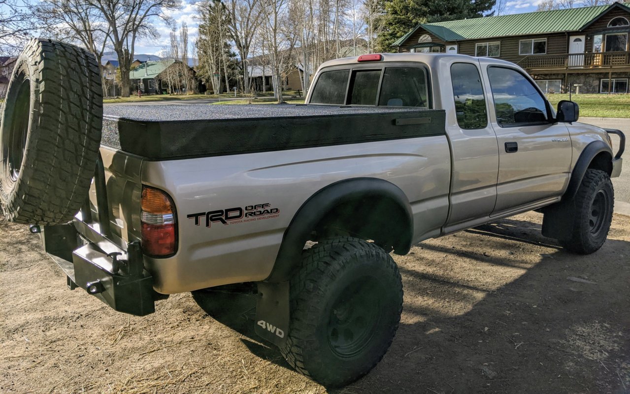

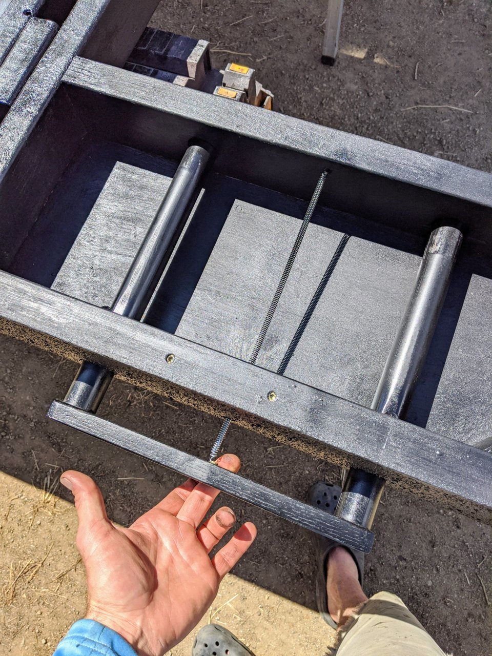

    Took the better part of the week and built my own bed cover. It's coated in Tuff Coat Marine paint. It's got rubbery bits in it - mostly used on boats and docks. Ought to last a while. The removable hatch cover at the front gives access to loading/unloading and it's held in place by spring-loaded dowels. The platform is held onto the bed rails with typical topper c-clamps. Was a fun project - lots of time on hands these days.
    If you'd like one, happy to build it! :)

    Even the rubber splash guard looks to be original and not dry rotted :eek:.

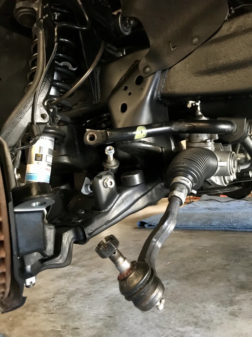

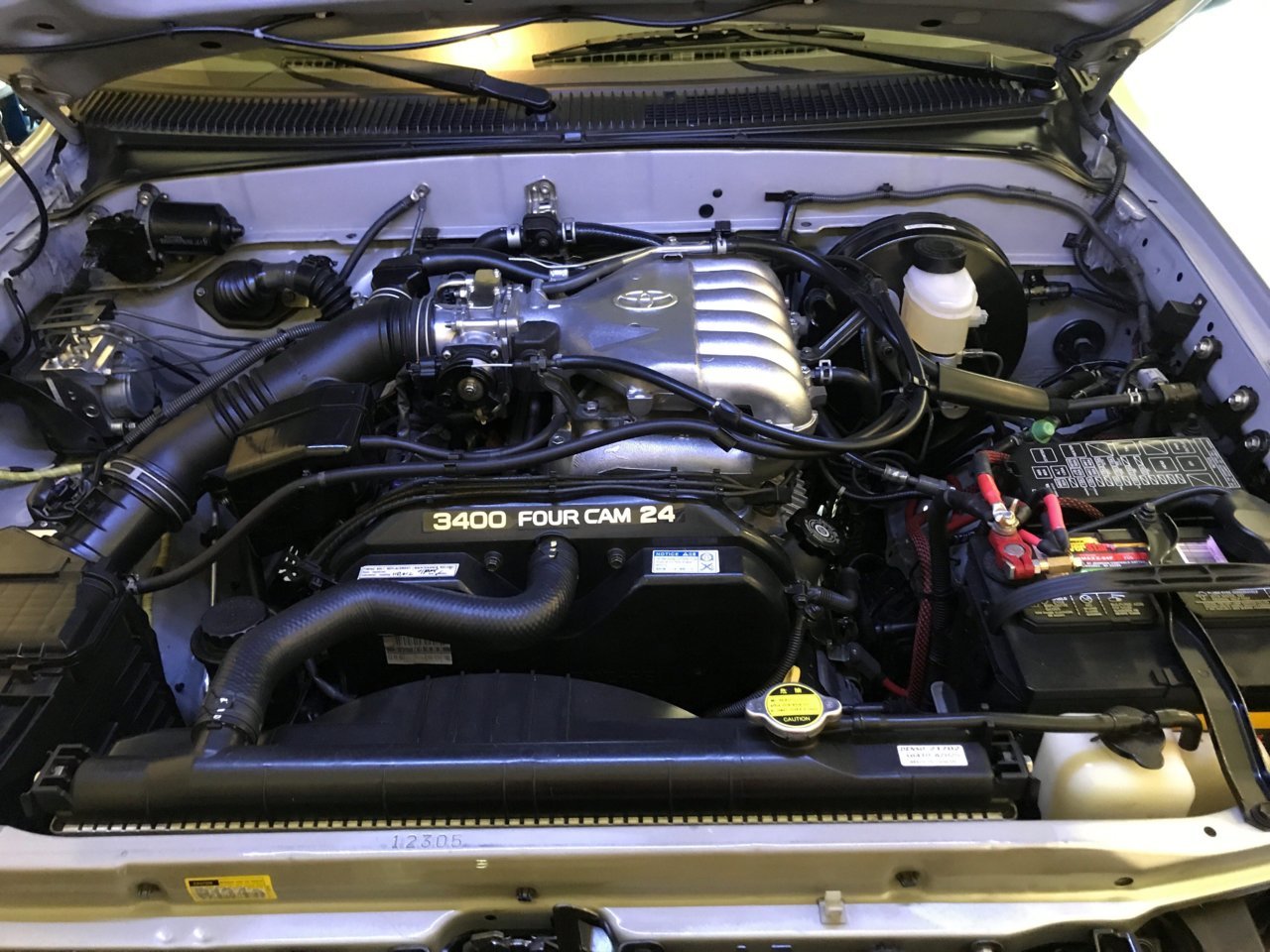

    See, it's not always squeaky clean. There is dust in between the gaps on the rack n pinion boot covers.

    Last pics of my OCDness......and yes, I can assure you it looks like this alllllllllllllllll the time.
