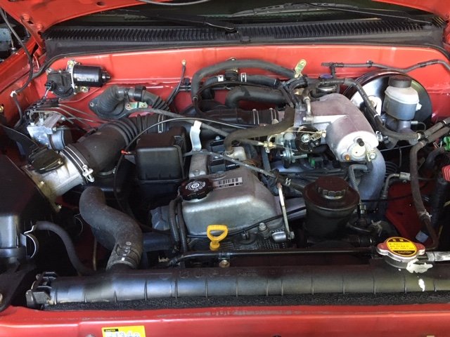

    That is clean beyond imaginable. I really admire your OCDD.:bananadance::broccoli::dancingbacon:

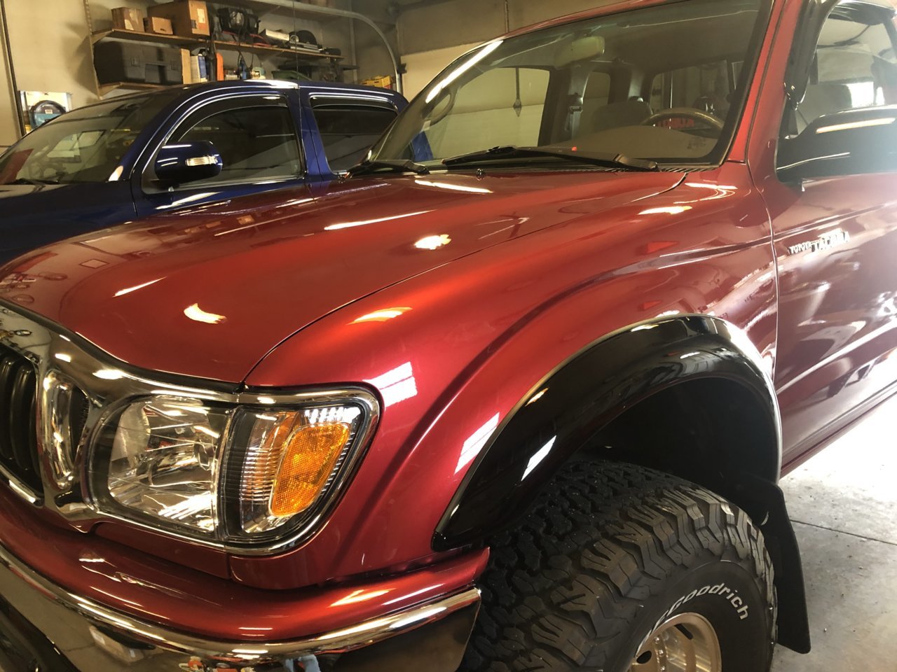

    Totally digging those wheels. Where did you get the center caps. That’s exactly what I need lol.

    They are method wheel center caps. With Toyota center caps modified and epoxied in. I'll post a pic of the backside in awhile.

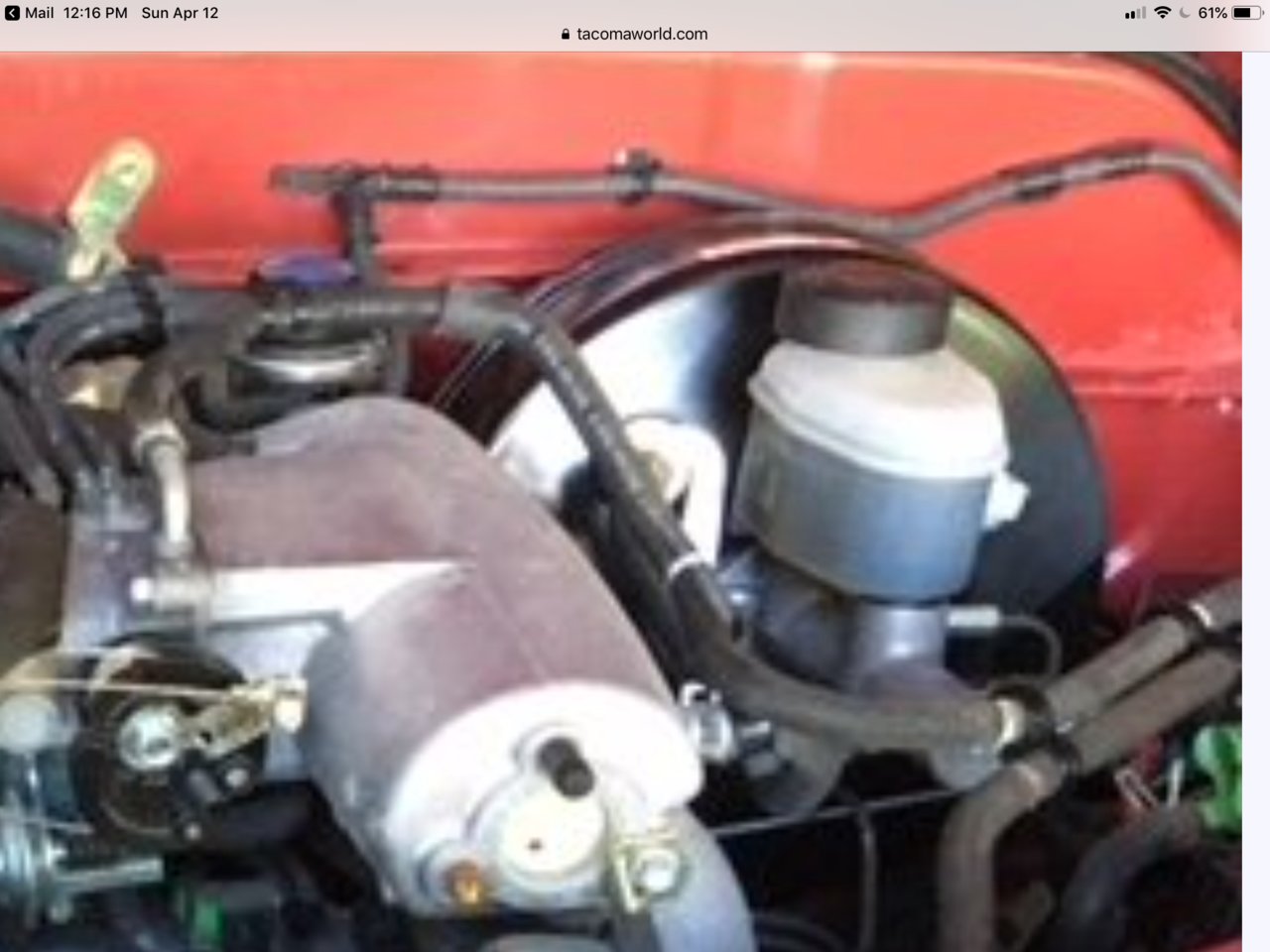

    When did you do a brake flush last?
    I did mine about 6 months ago. Mine brake fluid was brownish.
    After the flush the brakes are much more sensitive and responsive.
    I did add new stainless lines in the front and back at the same time tho
