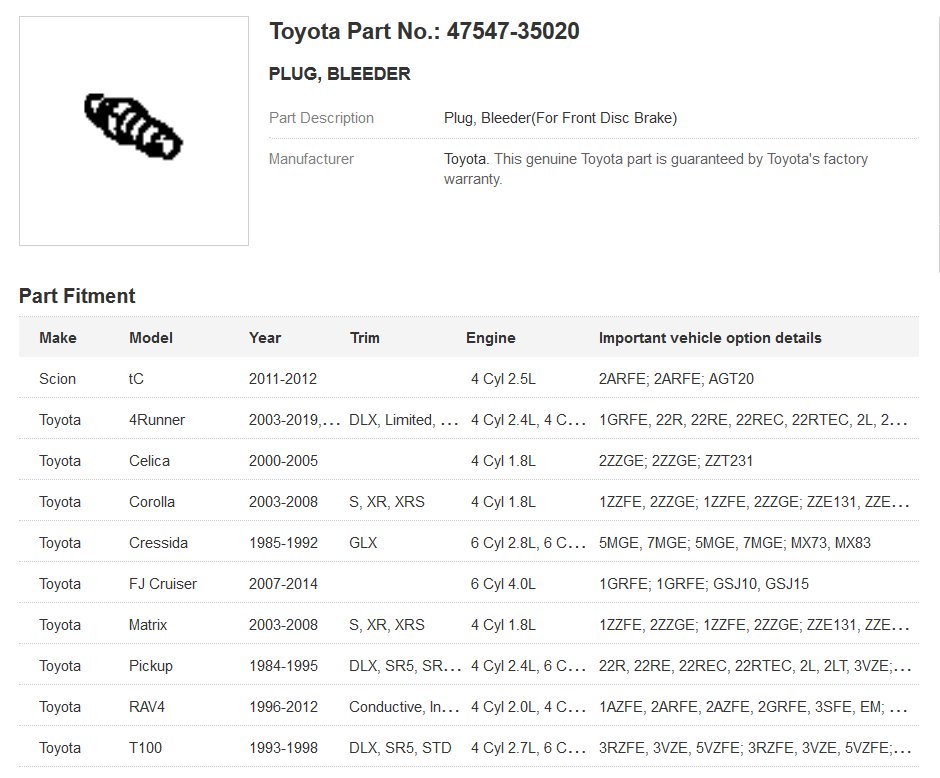

    My guess is it's probably a pretty standard size for Toyotas. I found the part number for the bleeder and looked up on TPD and below are some of the models that part covered.
    EDIT: I didn't notice partsouq gave 47547-35020 as a substitution. Correct part number was 47547-04010. Still, i bet both parts work so basically a bleeder for any of the models below should be fine.

    And for the cost, I imagine the parts store would only have a few different metric sized bleeders on the shelf. Could just buy a few and use whichever one works.

    Well I found it based on the sizing and all , https://www.oreillyauto.com/detail/...112/2560239/2004/toyota/tacoma?q=H94112&pos=0 just picked them up too

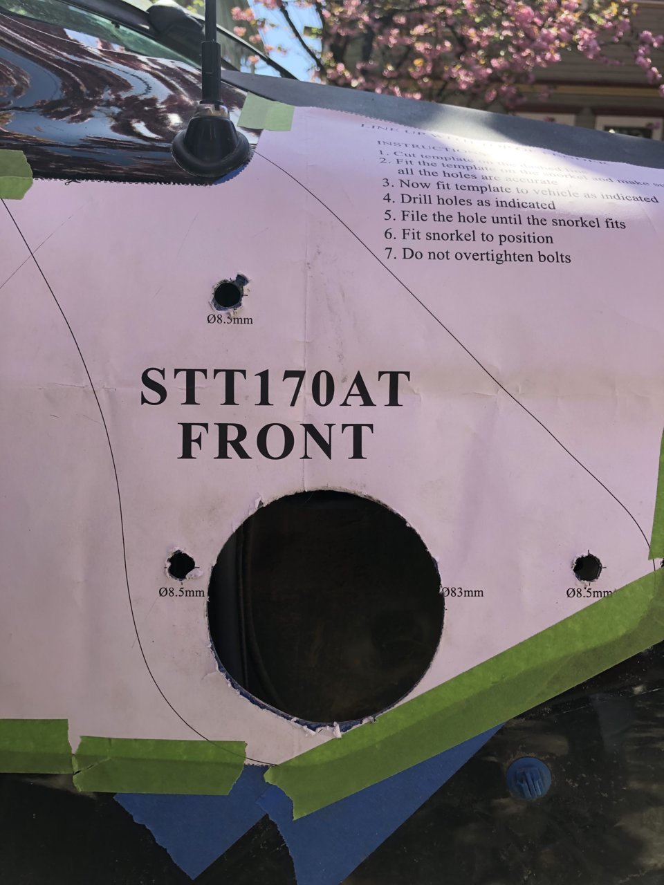

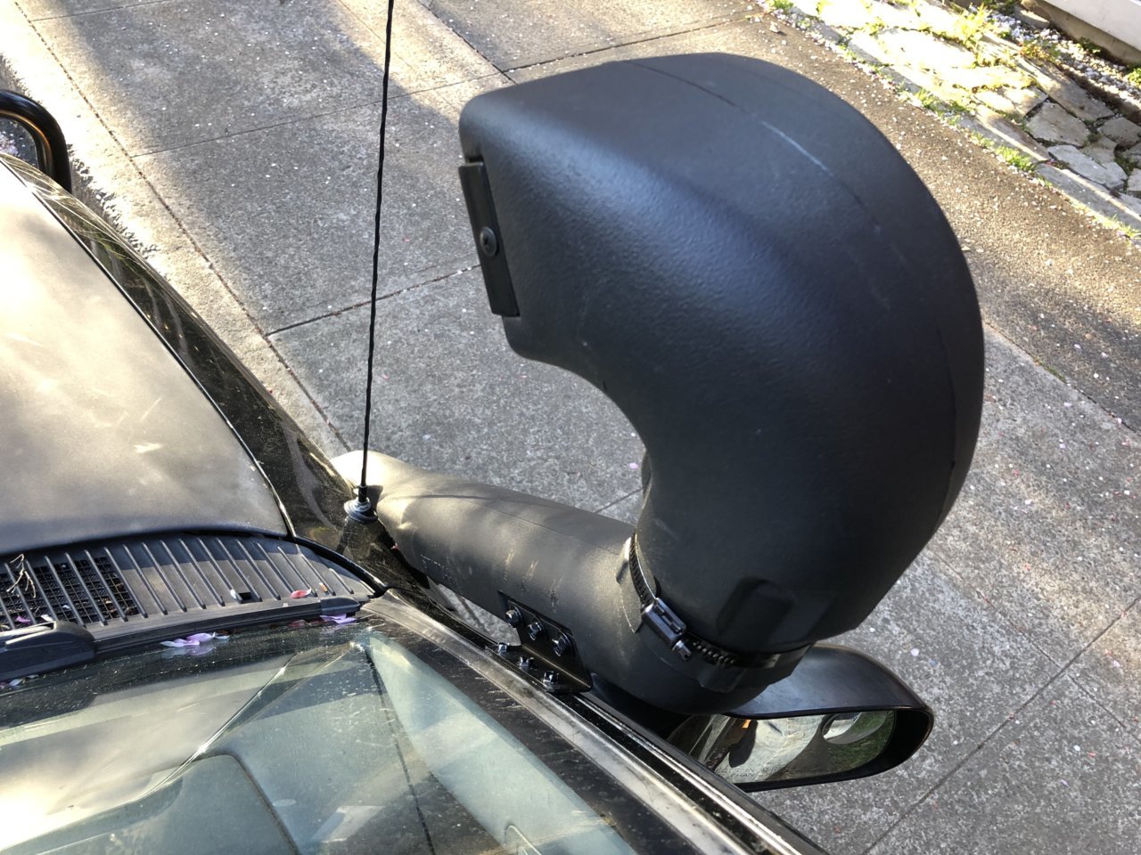

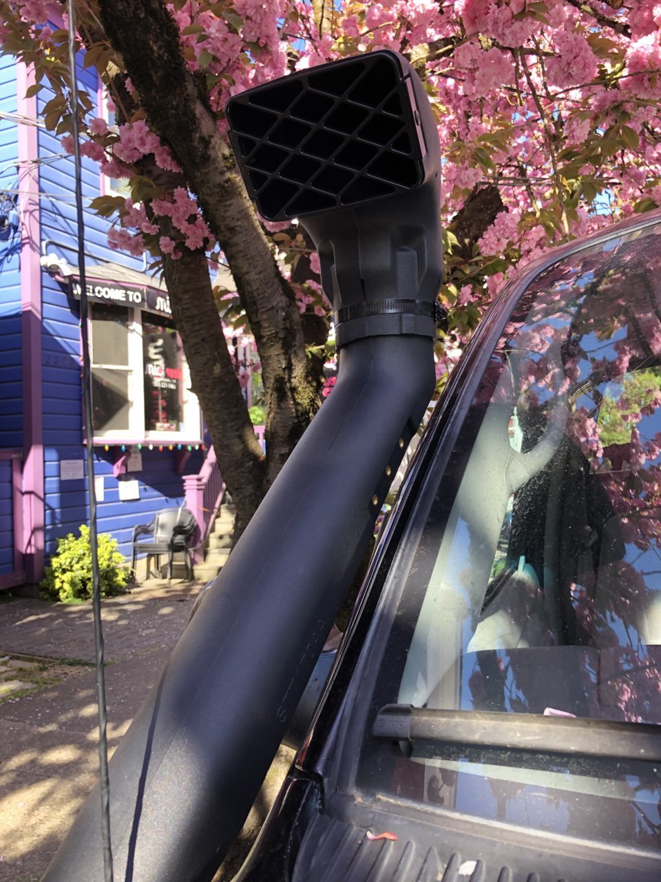

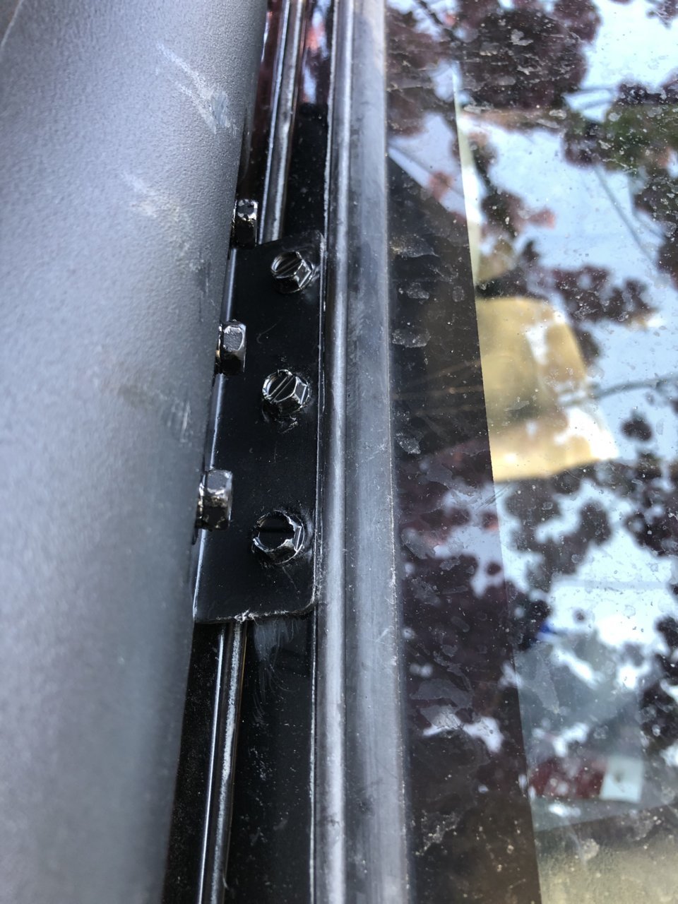

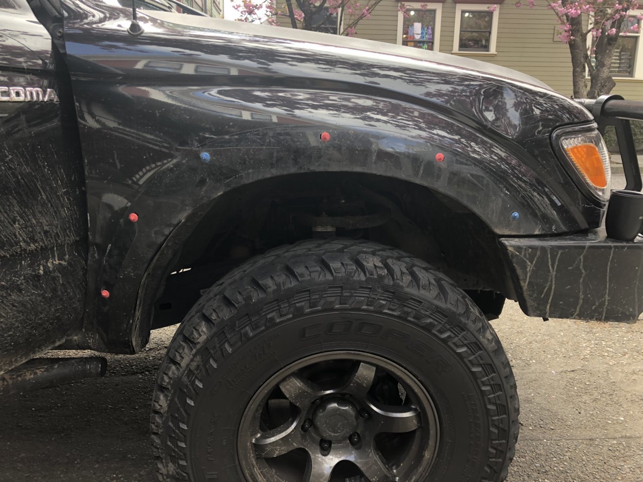

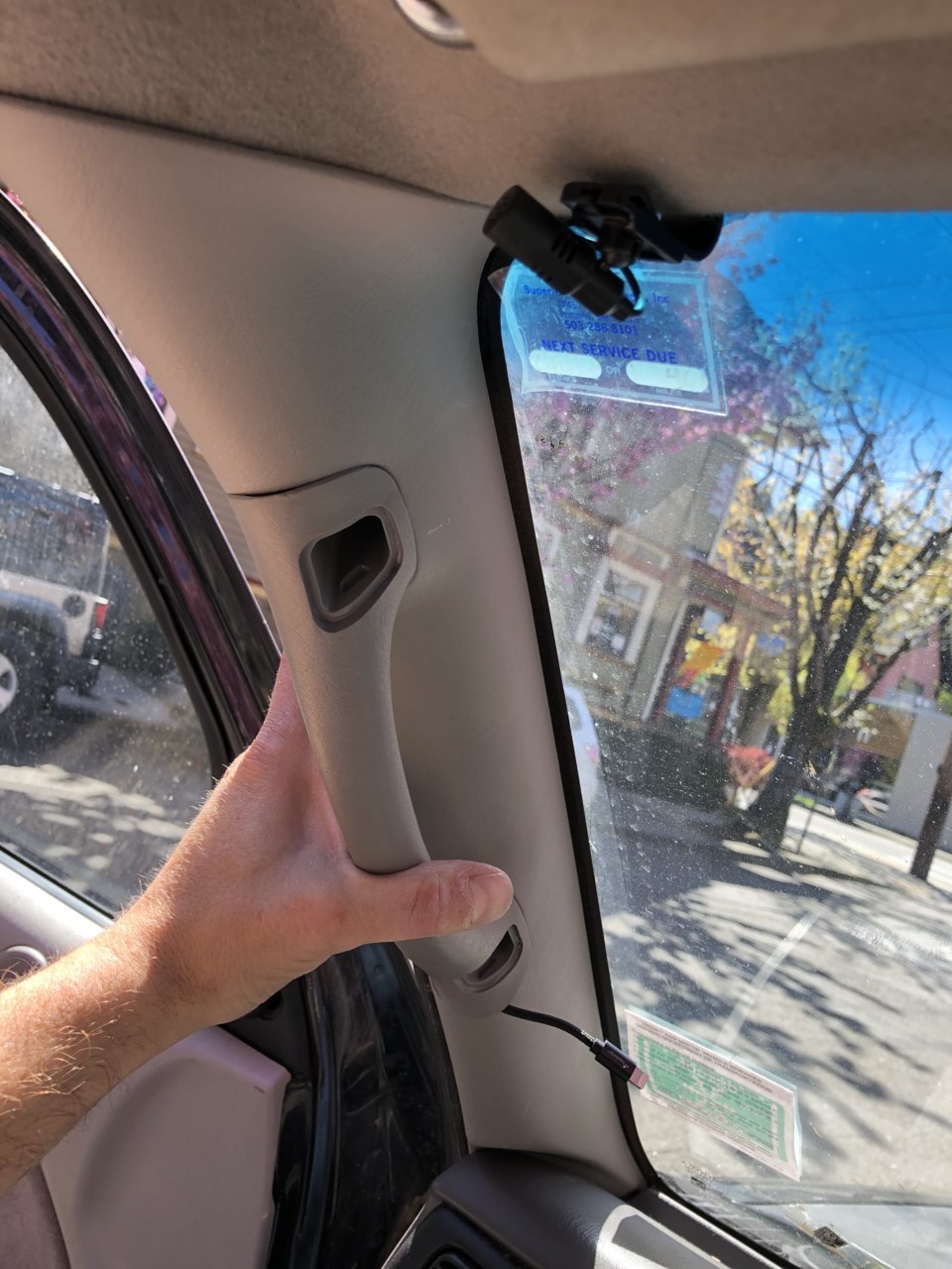

    Cut into a perfectly good fender and installed a blowhole.

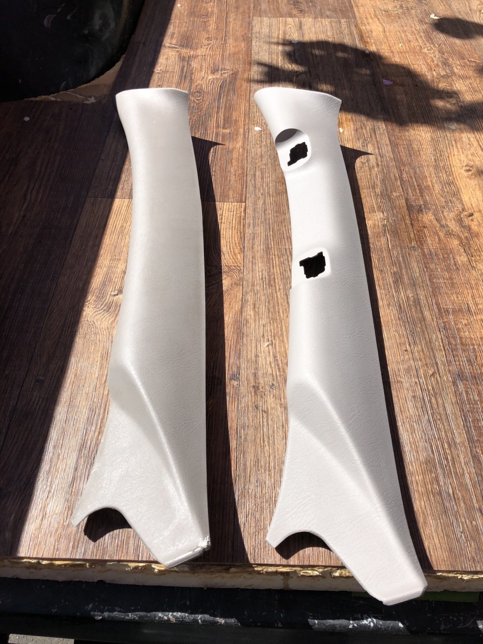

    Took off my silly 2001 non-oh-$%*#-having a-pillar trim piece and added a 2002 oh-$%*#-having a-pillar trim piece, keeping the mic cable hidden as it was before, adding a charging cable for the 1" ball ram mount thingy for a phone/tablet mount that'll live on the lower handle bolt.
    All in the middle of NW Portland, on the sidewalk...
