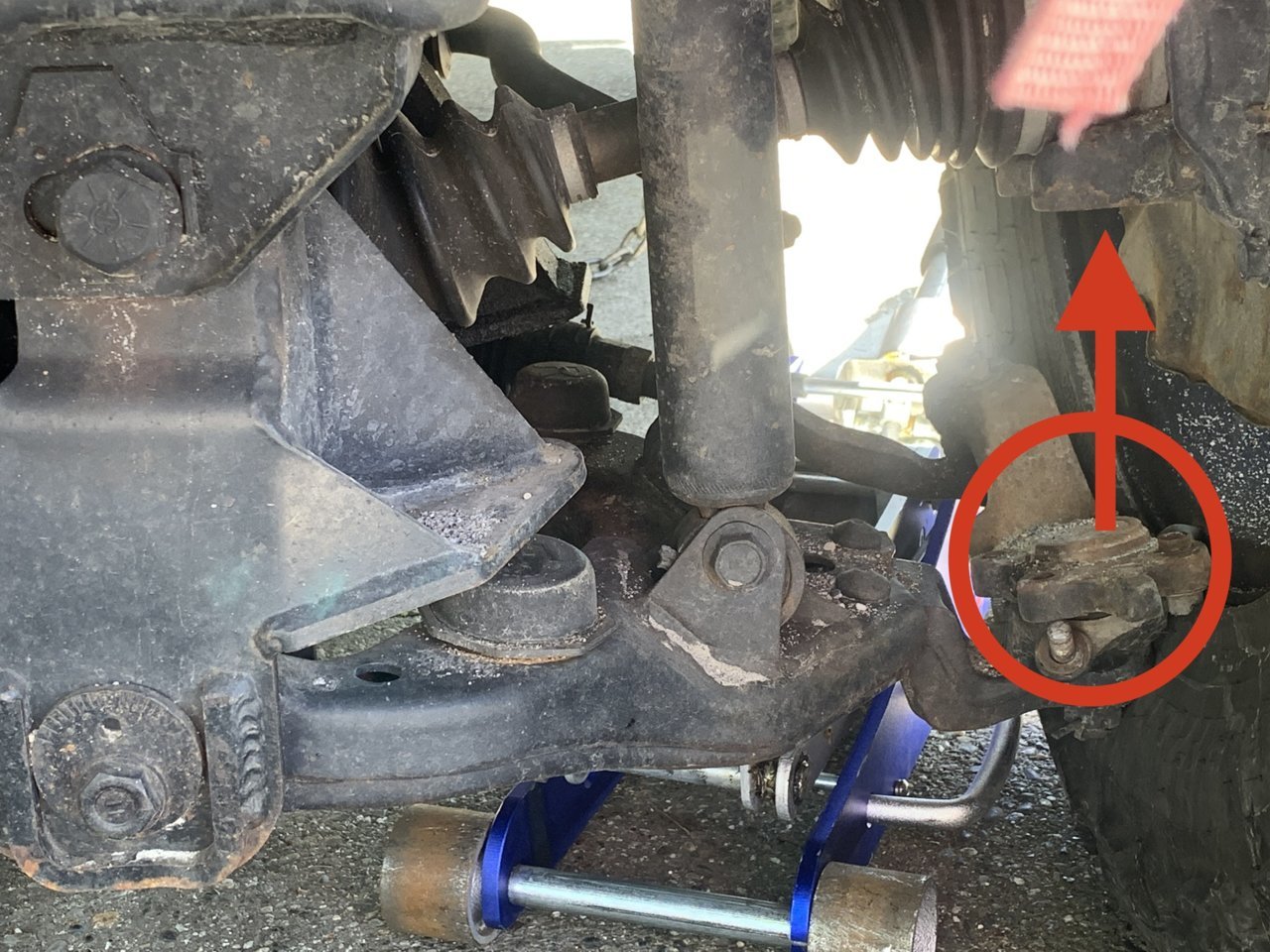

    Have any of you guys fixed your LBJ after a failure? What parts do I need?
    2002Tacoma4x4 likes this.
  8. Apr 14, 2020 at 10:41 PM
    JasonLee
    JasonLee Hello? I'm a truck.
    May 9, 2014
    #129454
    12,281
    Jason
    Q322+3C Denver, Colorado
    15 TRD OffRoad
    TRD Supercharger and more.
    Short story. Go buy replacement ball joints for both sides. Buy new bolts. Likely your bolts attaching the LBJ to the spindle were overtorqued/reused too many times and snapped.
    Also, you may want to buy some new shocks - the lower bushing is completely shot and the bolt is gouging the shock / shock is gouging the lower control arm... You may also want do inspect the rest of the truck as I am guessing there may be a few more issues going on...
    dweikum and nagorb like this.

    Part No.:43340-39585
    Part No.:43330-39815
    because i have them in my cart right now, heres the part numbers for the lower ball joints

    I would also add that he verify the bolts in the outer of the spindle are able the be removed. If not best thing would be removing it and then extracting them

    Yea... adding that all to my nice list of things to keep me busy during quarantine.. the goal is to get it back in the road so I can take the truck to someone who will inspect the vehicle thoroughly. But thank you... will go to parts stores tomorrow after I find out if stock parts will work with the fabtech lift

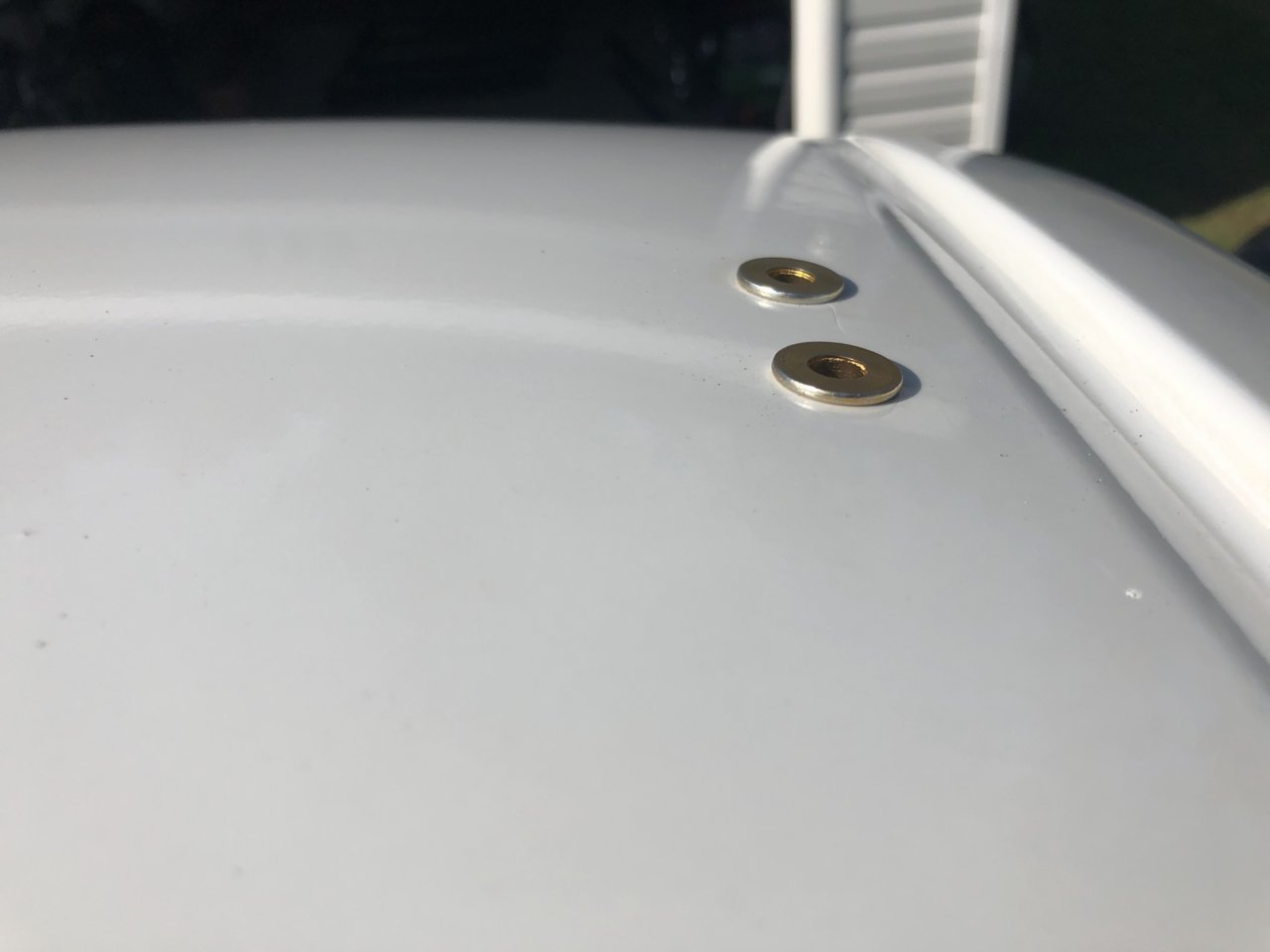

    I think it would depend on the mounting hole locations on that Xterra rack. The prinsu rack has fixed feet positions but the bolt locations have a good bit of adjustment.

    You had a bolt failure. So find out which bolt or bolts are still stuck in the spindle and get them out. Hopefully you can.
    Then replace the lbj and bolts as said.
    But you might need a new spindle if you can't extract the bolts.
    If you were driving when it happened check you tie rods and steering rack. But doesn't look like you had the wheel get sucked under.
    And ditto on getting new shocks.
    nagorb and ericp95[QUOTED] like this.

    Yea they're just the Fabtech shocks, whatever comes in that lift. If it were up to me, I would have gone another direction but this is the way I got it so just need to work with it.

    There's a tiny chance you could just replace the bushings in them. I know nothing about FabTech shocks or part availability/interchangeability. My OME shocks with 46k on them are slightly off center, but the bushings still have some lift in them.

    Thank you. Main goal right now is to get Jeanine back on the road. Truck is stuck at a shop waiting for these parts. Shocks will get changed sometime after all this.
