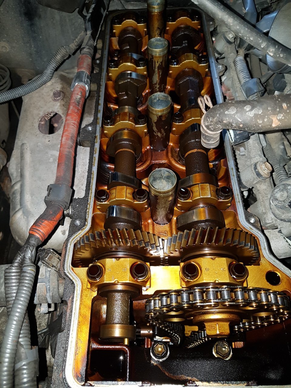

  1. Apr 16, 2020 at 8:16 PM
    0xDEADBEEF
    Mar 2, 2019
    #285037
    19,847
    2000 reg cab 4x4 flatbed MT
    So all the bolts around the passenger side and across the front were finger tight. Guess that explains the leak.

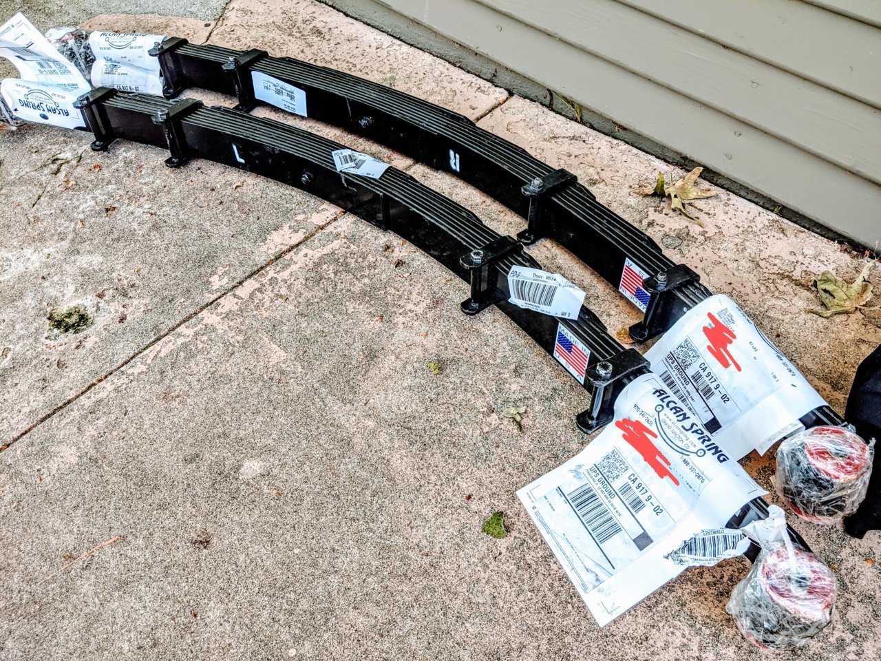

  2. Apr 16, 2020 at 8:18 PM
    eon_blue
    Mar 4, 2016
    #180213
    70,110
    Azusa, CA
    Yea I had Dakars a few years ago, then Dakars + AAL. Even with the AAL they wouldn't hold a full bed of camping gear + RTT without sagging onto the bump stops. Also they were crazy noisy but it was the weight issue that bothered me most

  3. Apr 16, 2020 at 8:21 PM
    Speedytech7
    Feb 20, 2014
    #123587
    58,548
    FCQM+VG Cheney, Washington
    It's less Tacoma and more mod
    The leak actually explains that lol... The rubber hardens and shrinks over time from oil exposure, leaving your covers loose.
  4. Apr 16, 2020 at 8:27 PM
    0xDEADBEEF
    Mar 2, 2019
    #285037
    19,847
    Lol. That makes sense.
    The ones on the intake side were still tight, probably because the engine tilts.
    Is there a way to tell from the cam chain tensioner what condition the chain is in? I haven't gotten inside to go through the book yet.
  5. Apr 16, 2020 at 8:29 PM
    Speedytech7
    Feb 20, 2014
    #123587
    58,548
    It's a hydro assisted tensioner, I never had mine clatter and I had 265k on it. If they stretch enough to cause problems you'll get a timing CEL first.
    0xDEADBEEF[QUOTED] likes this.
  6. Apr 16, 2020 at 8:32 PM
    0xDEADBEEF
    Mar 2, 2019
    #285037
    19,847
    I was thinking that as the chain wore more of it would be visible.
    No cels though, aside from the downstream o2 sensor one whenever I go down a bumpy road or a large puddle.

  12. Apr 16, 2020 at 11:23 PM
    Blackdawg
    Blackdawg Dr. Frankenstein
    Dec 31, 2010
    #48500
    81,652
    Monte
    Wyoming/St. Louis
    The Trifecta of Taco's
    eh..sorta. The torque spec is only like 7ft/lbs I think. Which is pretty much finger tight. They aren't supposed to be super tight.

  14. Apr 17, 2020 at 1:45 AM
    Empty_Lord
    Empty_Lord Toyotaholic
    Mar 13, 2016
    #181186
    28,304
    Dan
    Northwest Indiana/Chicagoland
    ive noticed they do "come loose" moreso because of the rubber washer toyota used.. not a single issue on newer toyotas without those buggers, even when the gasket is beyond shot, theyre never loose. any toyota engine with the washers? i dont think ive ever seen one with "tight" bolts

  17. Apr 17, 2020 at 6:01 AM
    Speedytech7
    Feb 20, 2014
    #123587
    58,548
    I'd be surprised if you could put 7ft of torque on a 10mm bolt with your finger tips.
    fiziks likes this.
