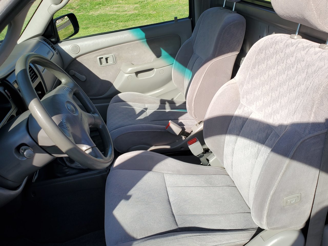

    Hahha, so is mine! :rofl: Guess the photos dont do it justice..
    In 2002 the factory called it "Charcoal" and I believe it may be different than your 98 Gray. Or do you mean 98 gray vs 02 charcoal?! Not sure if they made the sport seats like these I have in those years, I thought they were from 01-04 only but I may be mistaken... you can bolt them in (IF you find some), but not certain if you will find the matching color and patterns for your model year.
    Maybe this pic shows the color and patterns a bit better?
