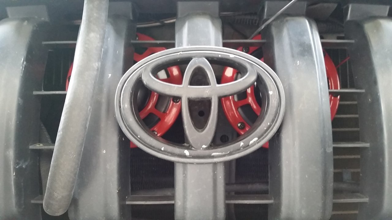

  17. Apr 19, 2020 at 7:28 AM
    Hooks98tacoma
    Hooks98tacoma Well-Known Member
    Sep 1, 2018
    #264818
    1,436
    Georgia
    98 Tacoma 2.4
    What all did it take to install theses??

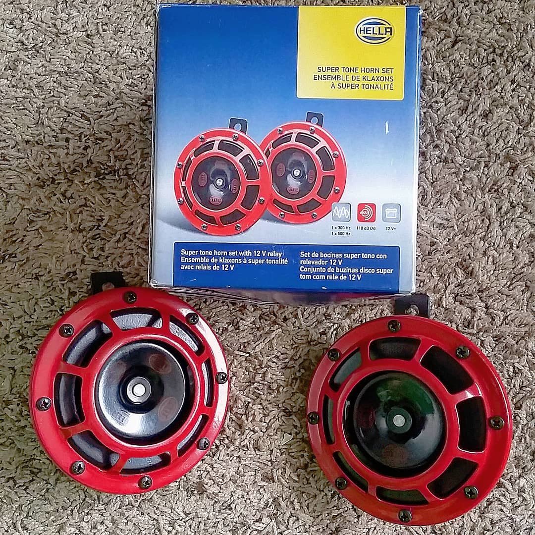

  20. Apr 19, 2020 at 8:44 AM
    Phessor
    Phessor Well-Known Member
    Feb 15, 2014
    #123156
    3,580
    Loud
