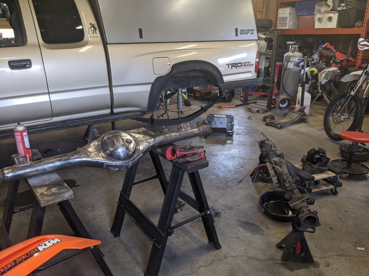

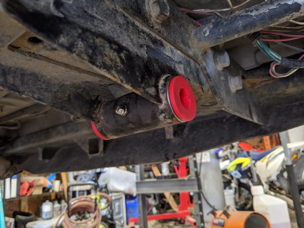

    I replaced my leaf spring bushings yesterday too. Also added a zerk on the shackle pivot.
    Current state of my garage.
