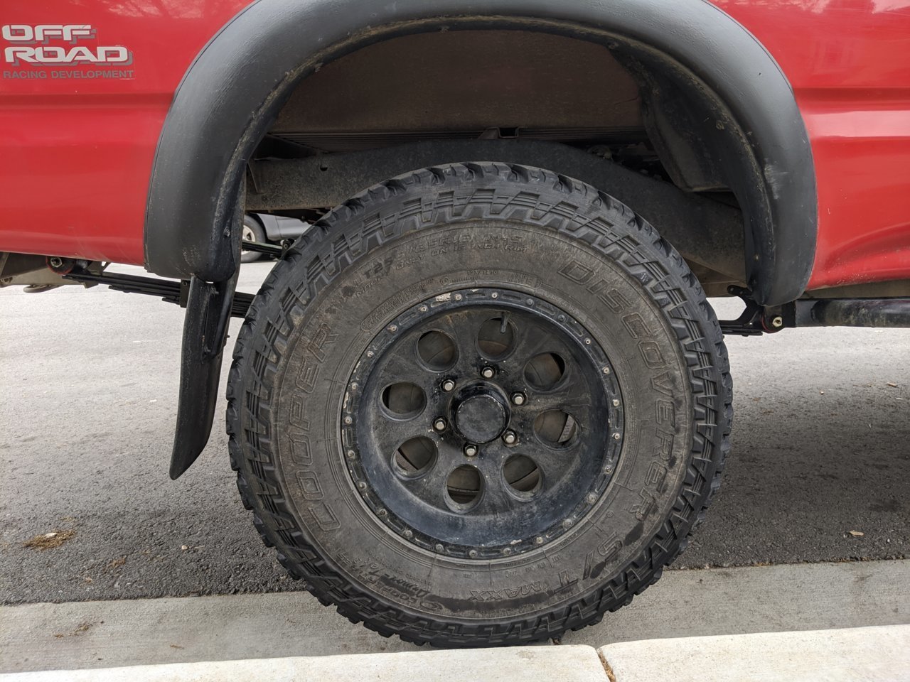

    Nilly’s taco
    Nilly’s taco Well-Known Member
    Apr 13, 2020
    #324681
    45
    The Yay
    04 double cab delux
    ADS 2.5 coil overs, JBA UCA’s, icon rear shocks
    Dude thanks for the alert on that. That was the case. I just got off the phone with Tyler. They’re making me new ones!

    There are two things I don't like about relocation plates (+stacked with shims)
    1. Stacking. Take it to an extreme and you're basically putting a block lift under your leafs, which I think we all don't really love the idea of.
    2. Leverage and stress. Now, sure you're only moving the leaf pack 3/4" or 1" in some direction, but that means you're no longer centering it on the perch. That's going to put weird stresses on the perch, and means your ubolts aren't going to be bolted around the center pin as they should be - putting "undesigned" stress on the leaf pack as well.
    So, maybe "sketch" isn't as sketchy as running 3 bolts on your LBJ, but it's not ideal either.

    Blutooth leaf springs are the best fix and the future

    To fix the axle being pushed back?
    I like what Turbo Dan did, get a new eye spring made

    I like the idea of the revised top leaf to fix the axle location, especially since I'm already running a shim underneath the leaf springs now.
    Was this something Alcan was able to get out to you pretty quick? I need to get in touch with them anyway regarding the u-bolts not being the right size.
    I'm not in much of a hurry anyway, definitely in no hurry to disassemble my leaf springs again lol. But definitely want to get it taken care of before the next off-pavement trip

    I saw on a Pirate thread that some people just drill a new hole on their axle for the pin to seat in. Not sure I'd want to go that route though

    Doesn’t seem to happen to everyone though, mine are fine

    The weird thing is that it seems to happen for some and not others. Maybe it's a later 1st gen issue vs early 1st gen, I'm not sure. My Expos nearly had me rubbing the front of the wheel well. They could probably argue that we're all running larger than stock tires, and they wouldn't be wrong lol.

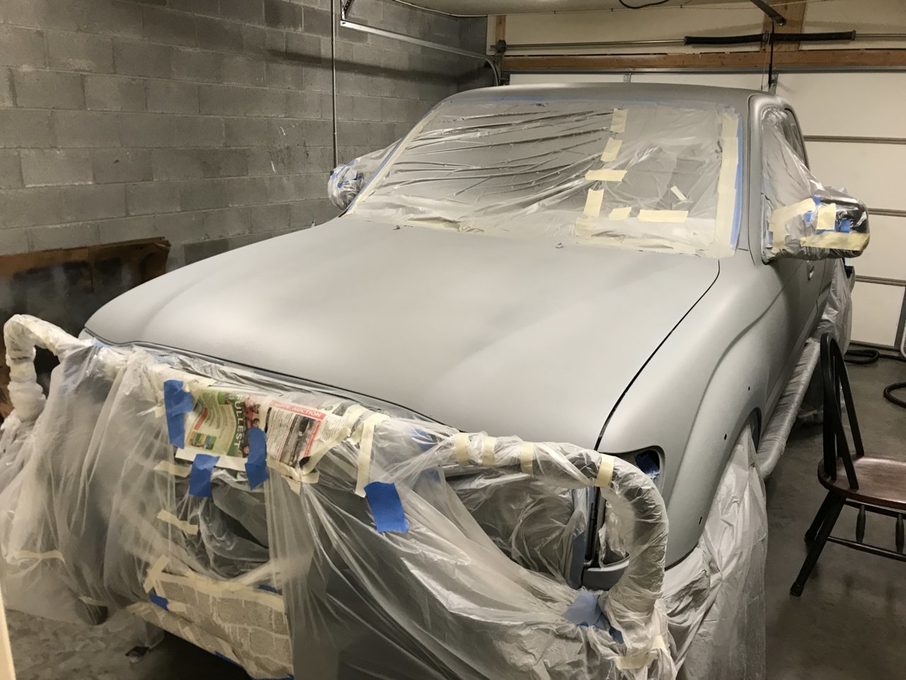

    base layer mostly down. only have 1 gal so not full coverage but that's ok since truck already has many layers of dip already. Just needed it to be "mostly" covered

    Ask them about it when you get in touch with them about the U-bolts.
    I'm curious what they have to say about the centering issue.

    I believe mine are centered just fine on my 04. Honestly haven't really paid attention but nothing rubs in the rear.

    What color you doing?

    you'll have to wait and see. hopefully it doesn't look like shit LOL. I got lucky the first time around I think, but I'm really trying to focus on laying it down "wet" as they say, so it doesn't have texture. That's the scary part to me because wet = runs at least with regular paint
