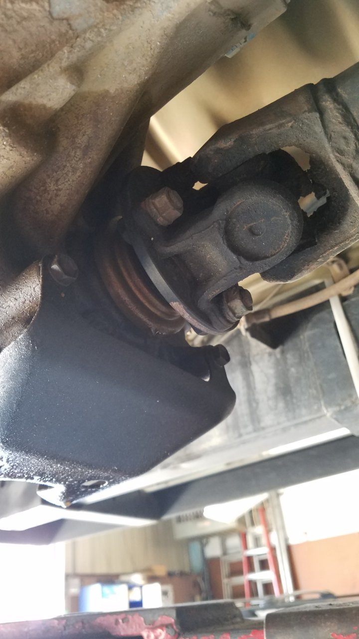

    There are a couple of seals and a stake nut involved.
    Remove the 4 bolts that hold the front driveshaft to the flange. Mark the mounting orientation so you can put it back together the same way. When you remove the driveshaft you will see the stake nut. Remove the stake nut and the flange will pull off exposing the seals.
    Here is the part numbers for my '02:
    Front Output Shaft Oil Seal 90311-41012
    Companion Flange Seal (small) 90312-23001
    Stake Nut 90179-22016
    You may be able to get away with not having to change the small companion flange seal. Depends on what you find when you get in there.

    It's not so bad. Output seal is most likely the culprit. Timmy-the-Toolman has a video outlining how to change this. All the part numbers and tools used are listed in the description, super detailed, makes it a cannot fail job. Timmy even gives Home Depot options for those of us who don't have all the fancy tools.
    I did mine in a couple hours. Let us know how that works out!

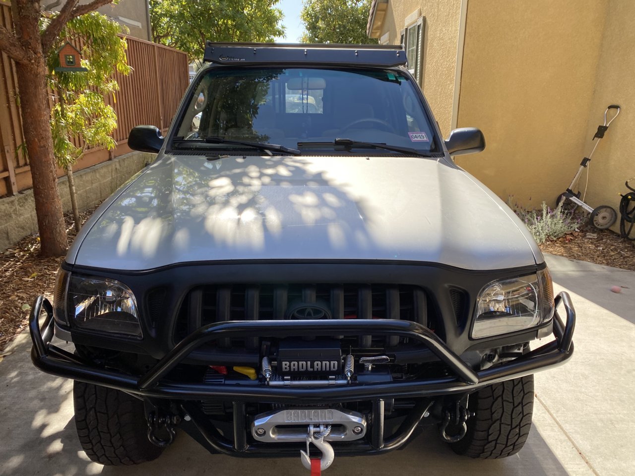

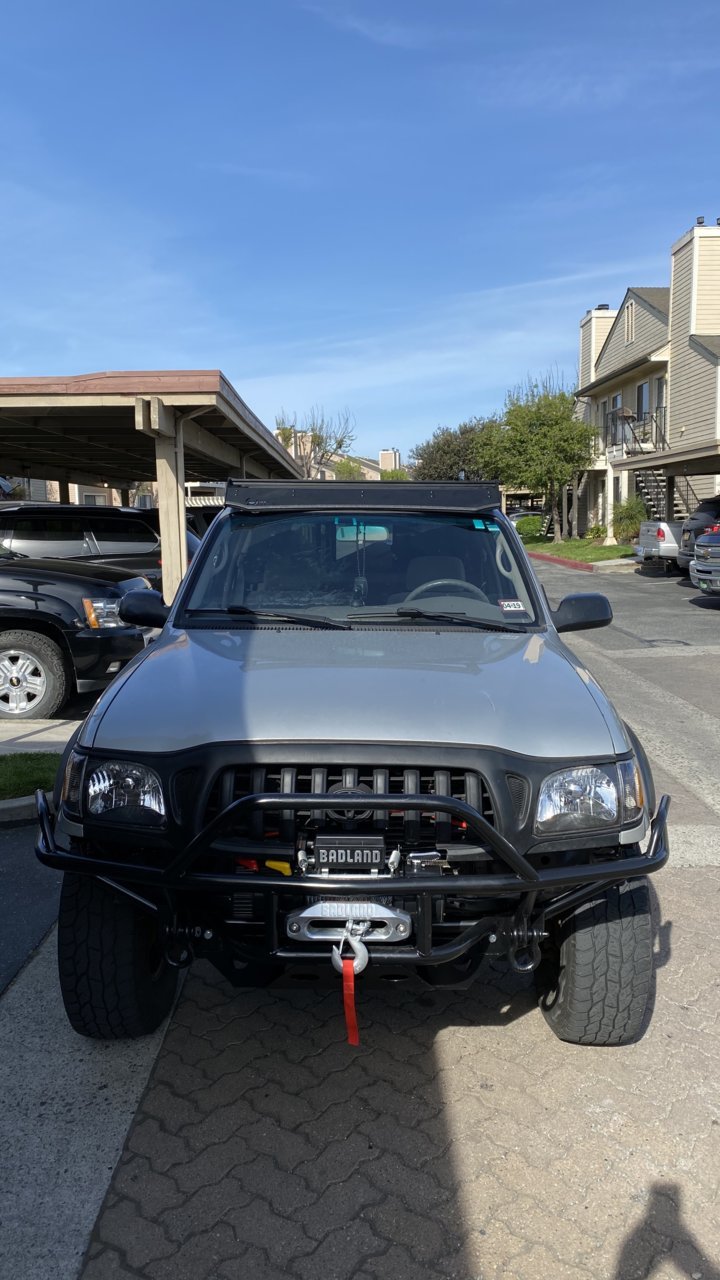

    yesterday i put on my prinsu cab rack, and the day before i. Put my apbaja bumper and my badland 12k winch

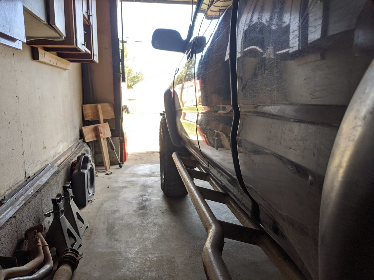

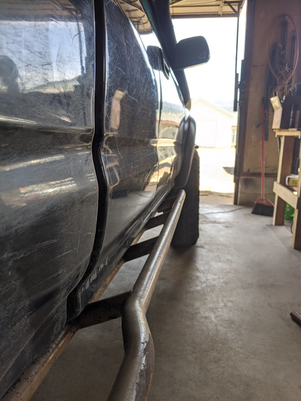

    Measured mine at 3/4", top and bottom for both sides. I've been tweaking out lately, worried about the frame bending and was happy to measure it to be the same both top and bottom and side to side.

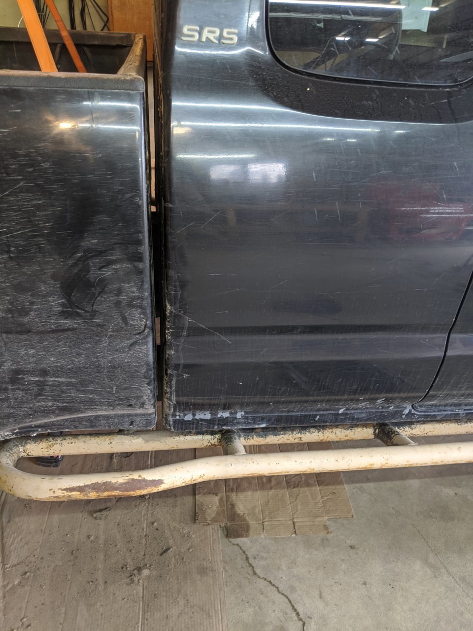

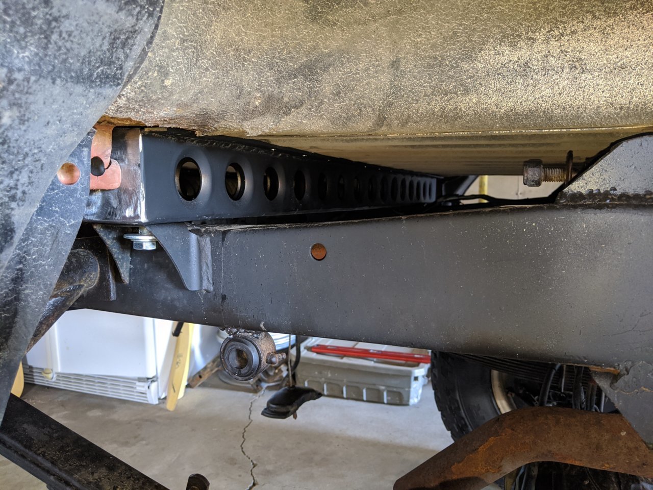

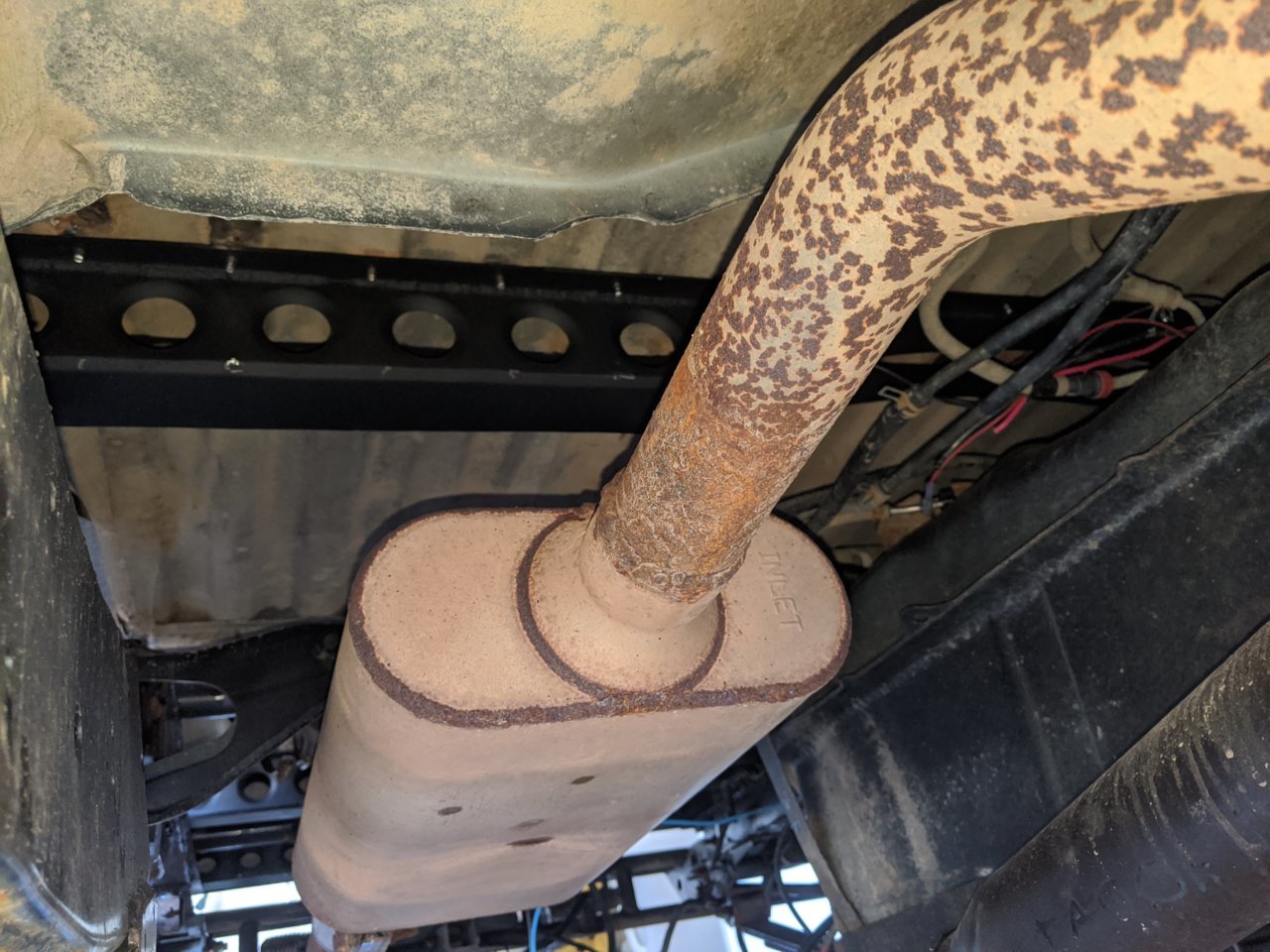

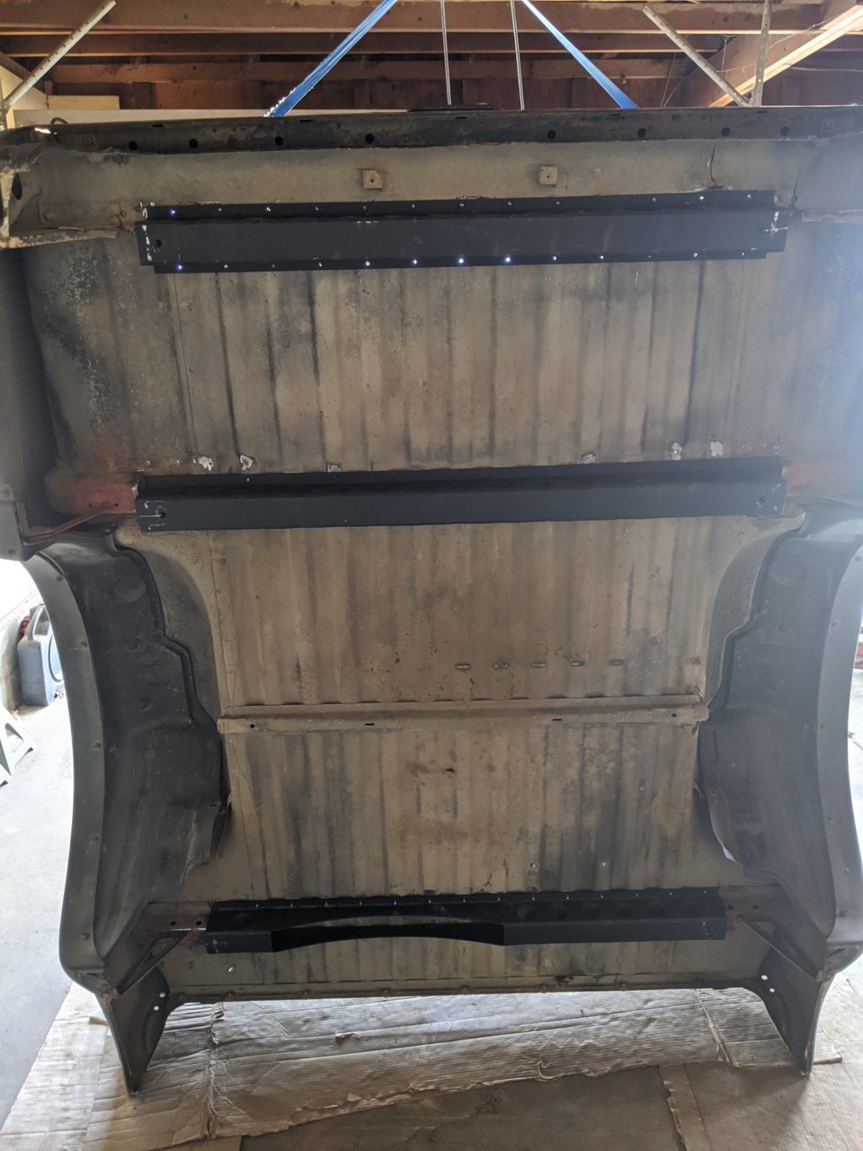

    Driver side is spot on, passenger is a bit high. Something has been tweaked somewhere. I'm guessing it could be from when my truck picked a fight with a backhoe. Gap is 7/8" at the smallest. Can't wait to be done with this project. Just need to tie into the side supports and finish riveting.

    What is that?

    That's the custom reh5108 shock mount. Weld-on, with greaseable bushings.

    Welded? Looks like bubble gum.

    Who designed this?

    Oh my b, must be that new jb weld mouthmix^tm steel epoxy

    Why not just do spot welds?

    Pretty sure that would ruin the bed liner if not catch the hole thing on fire. If the bed liner wasn't there I'd definitely weld.
