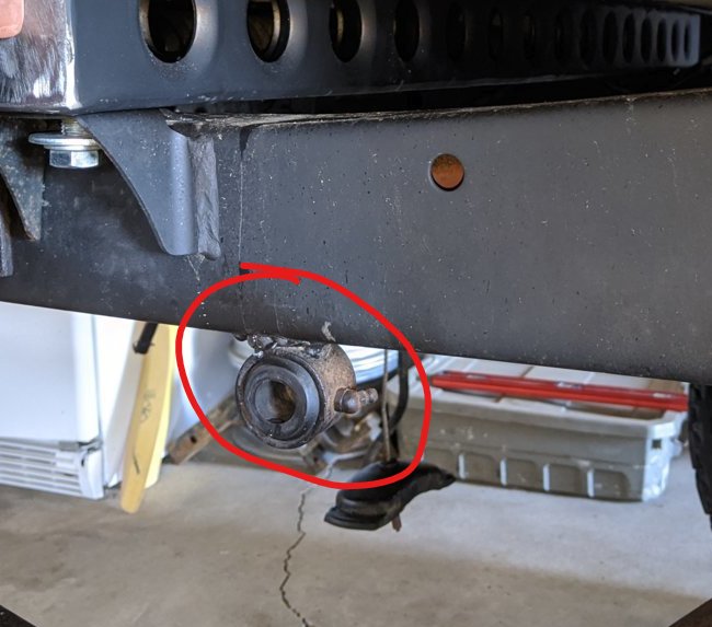

    The pivot for my Jerry can carrier.
    I suck a welding upside down haha. Its good enough for its purpose. The tire carrier winch hold all the weight.

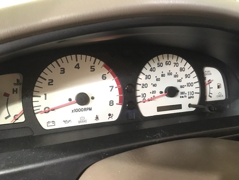

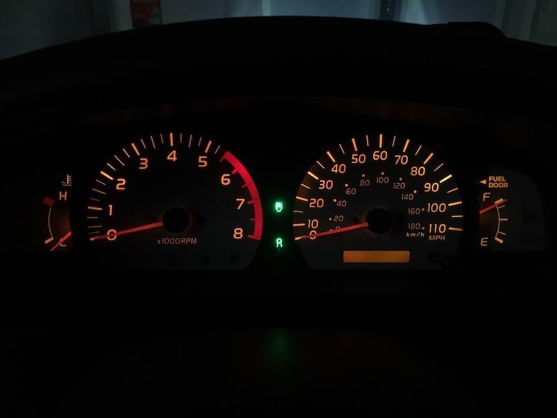

    Added extra indicator lights into the cluster. So I don't accidentally roll around with the front off road lights and aux. backup light on unintentionally.

    Cool. I was wondering if this could be done.

    Is that a little penis?

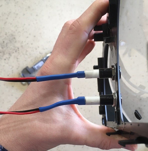

    Sure can! Looks something like this once you get the cluster and the cover seperated. The wiring is easy enough, just wire to the switched side of your circuit.
    HAHAHA! Didn't even realize that, I guess that's one thing the internet is really good at. Now I can't unsee it... def not changing it :thumbsup:

    The bottom one looks like a dick.
    *EDIT* Did not see the most recent posts.. :rofl:

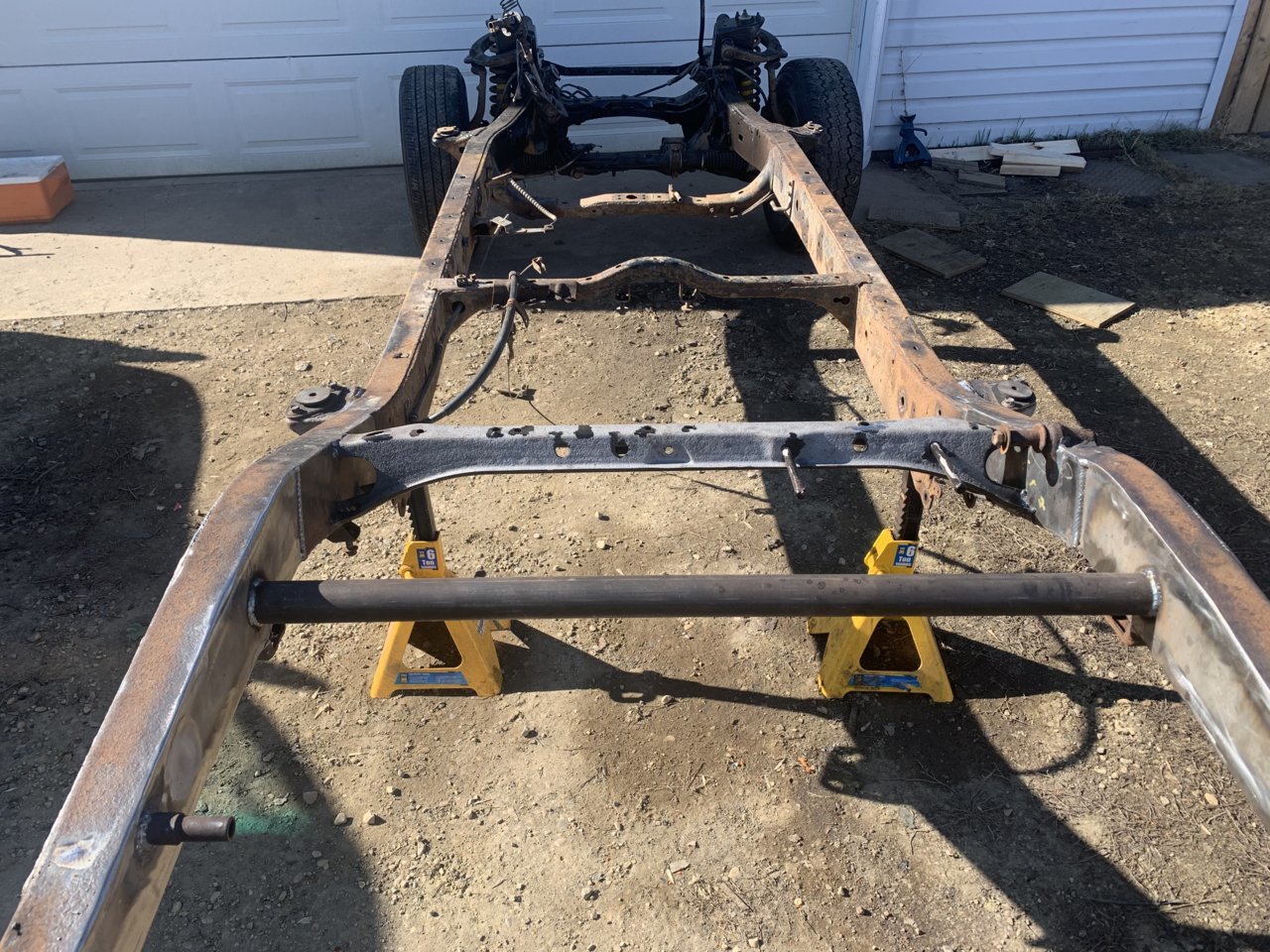

    Welded in the trailgear frame box plates, and the reinforcement plates on the outside of the frame. I cut the gas tank cross member out, cleaned it up, cut plate to fit that location, and welded it back in. Added the two crossmember tubes from trailgear, but left my shocks in the stock location. Burned 14lbs of 0.035 hardwire and a full 110ft3 bottle of C25. Also welded the body mounts in the proper location for the double cab. Should be able to pull the cab from the rotten frame and place it on the good one by next weekend. And now I wait on parts!!

    If you were near me I'd fix it for you for free, I couldn't let that go lol
