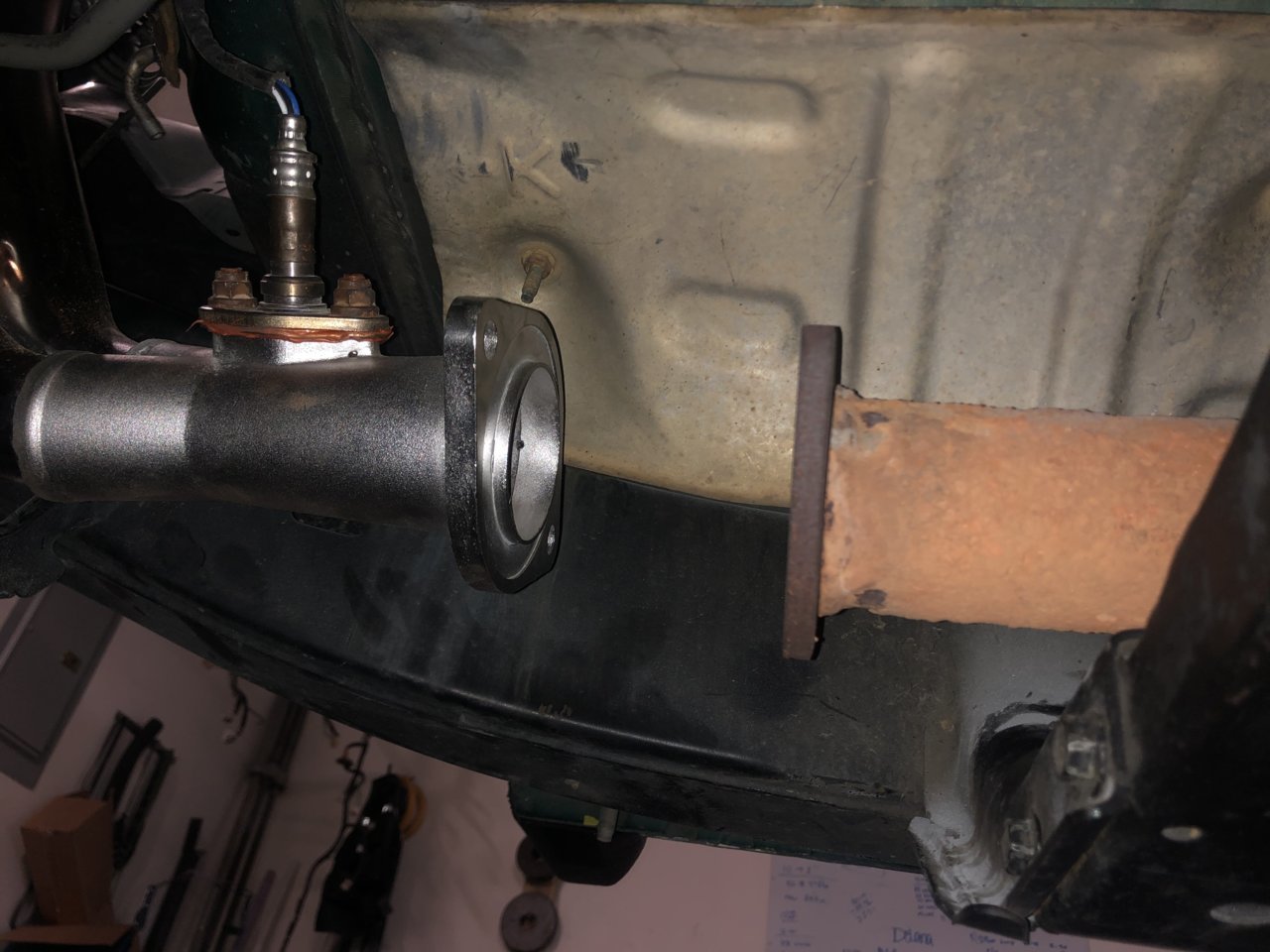

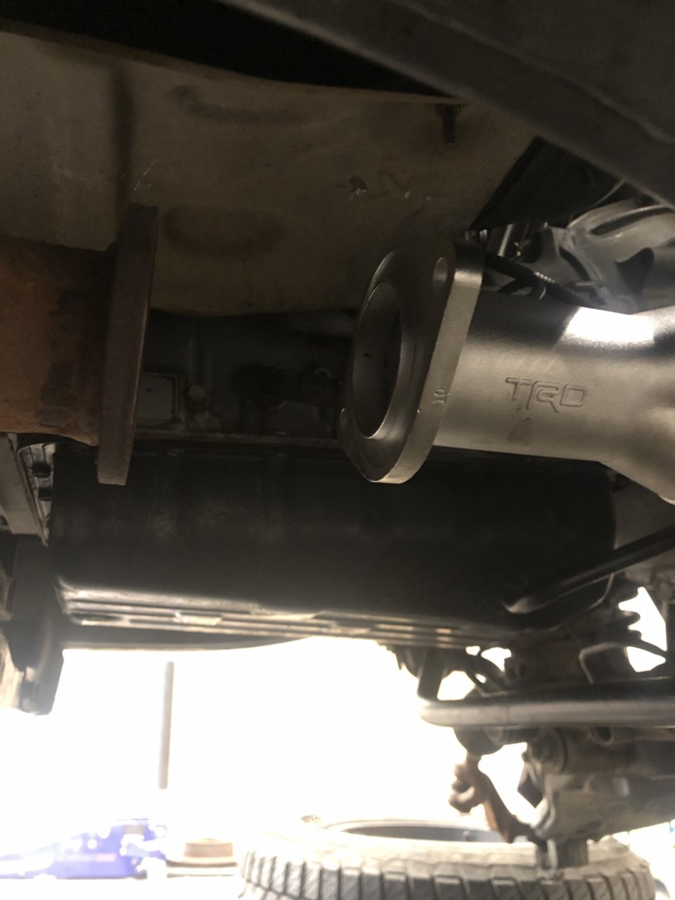

    Heres a visual. Sorry fo the poor pictures. Tape measure says its a exactly a 3.5" gap. When installing I didn't cut anything like the instructions stated bc I had my trans out for a 4wd conversion. So, I just unbolted the front cat and tossed it out of my way.
    P.S. The header install was a pure bitch even with the transmission out of the way. Can't imagine how fun it would be with trans still installed.
    Edit: Notice that mine is a really straight shot. No bend should be required. @drr @SwampYota
    SwampYota and cruiserguy like this.
  2. Apr 28, 2020 at 12:44 PM
    drr
    drr Primary Prognosticator
    Oct 17, 2013
    #114681
    2,774
    Dan
    Seattle-ish
    02 4WD Tacoma
    Oh yeah, does look like a straight shot. It's been several years since I did my TRD headers, I guess I forgot about that. The Doug Thorley headers we did on @Digiratus truck required that bent piece I showed.
    cruiserguy likes this.

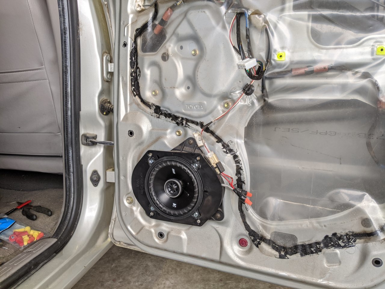

    Is that the Paranoid Fab 1st gen speaker plate?

    Says Scoso-e on it I think.

    Good eye!
    I was looking at the speaker cone instead of the mounting plate...:anonymous:

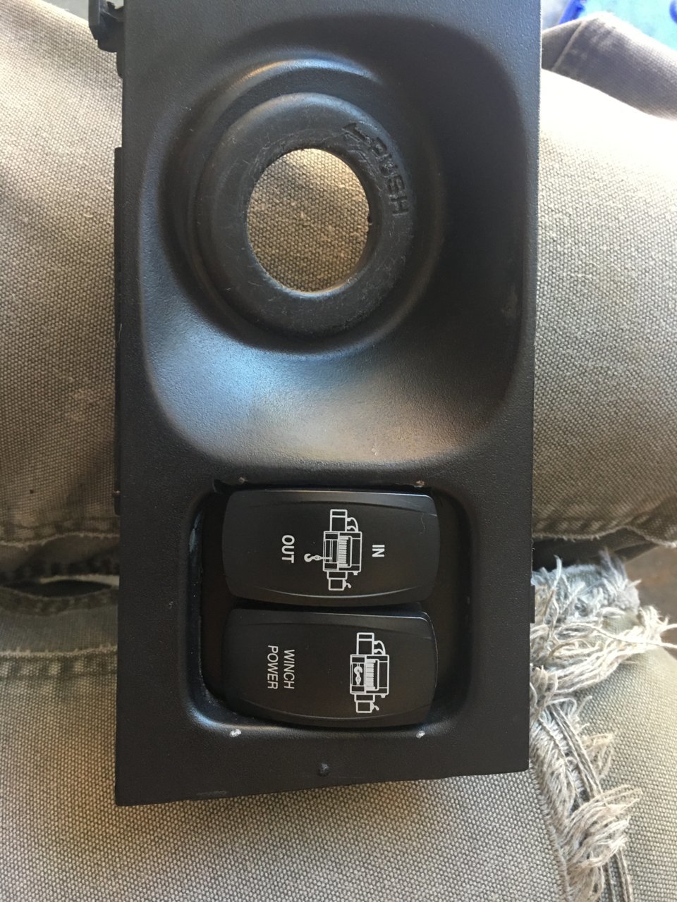

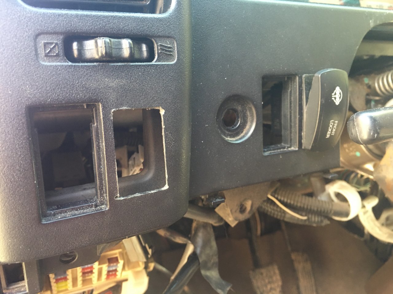

    Been my project over the last couple of days, but I’ve got a few more switch locations finished. 71FA100A-B430-48EF-B159-3D1D00370482.jpgC3A18B52-6FEF-4BF7-B111-3ED650DB2F60.jpg
    Got my fuse box bracket from paranoid fabrications with no cutouts. Looks like I should be able to cut a hole in it for my clutch master cylinder and everything should fit something like this:
    I never thought when I decided that I wanted to add accessories about a year ago, that I’d be researching and parts gathering for over a year before I started running any wire in an effort to make everything nice and tidy. I should have everything to start on my bussman box and making harnesses/getting power to my switches within the week!

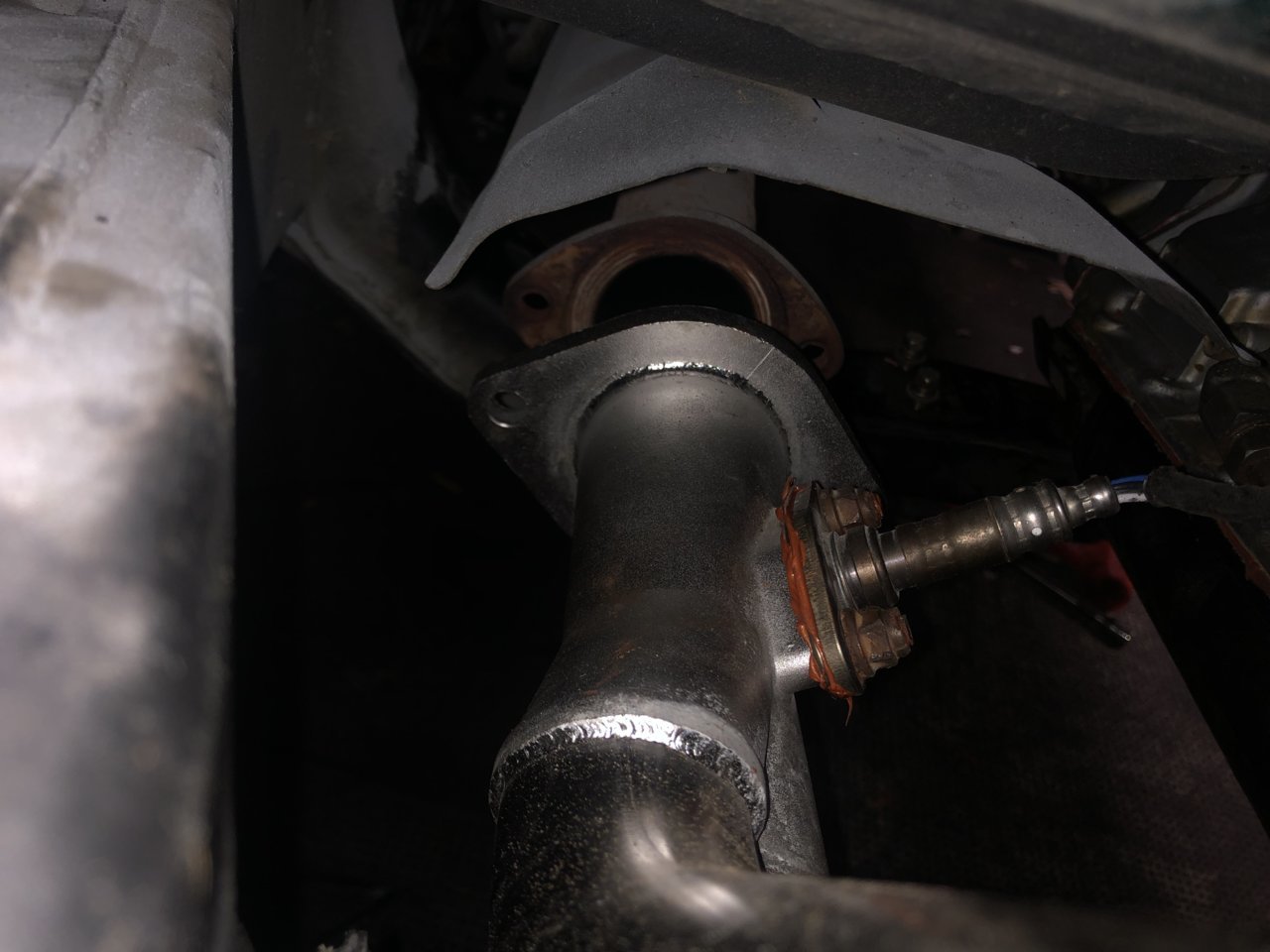

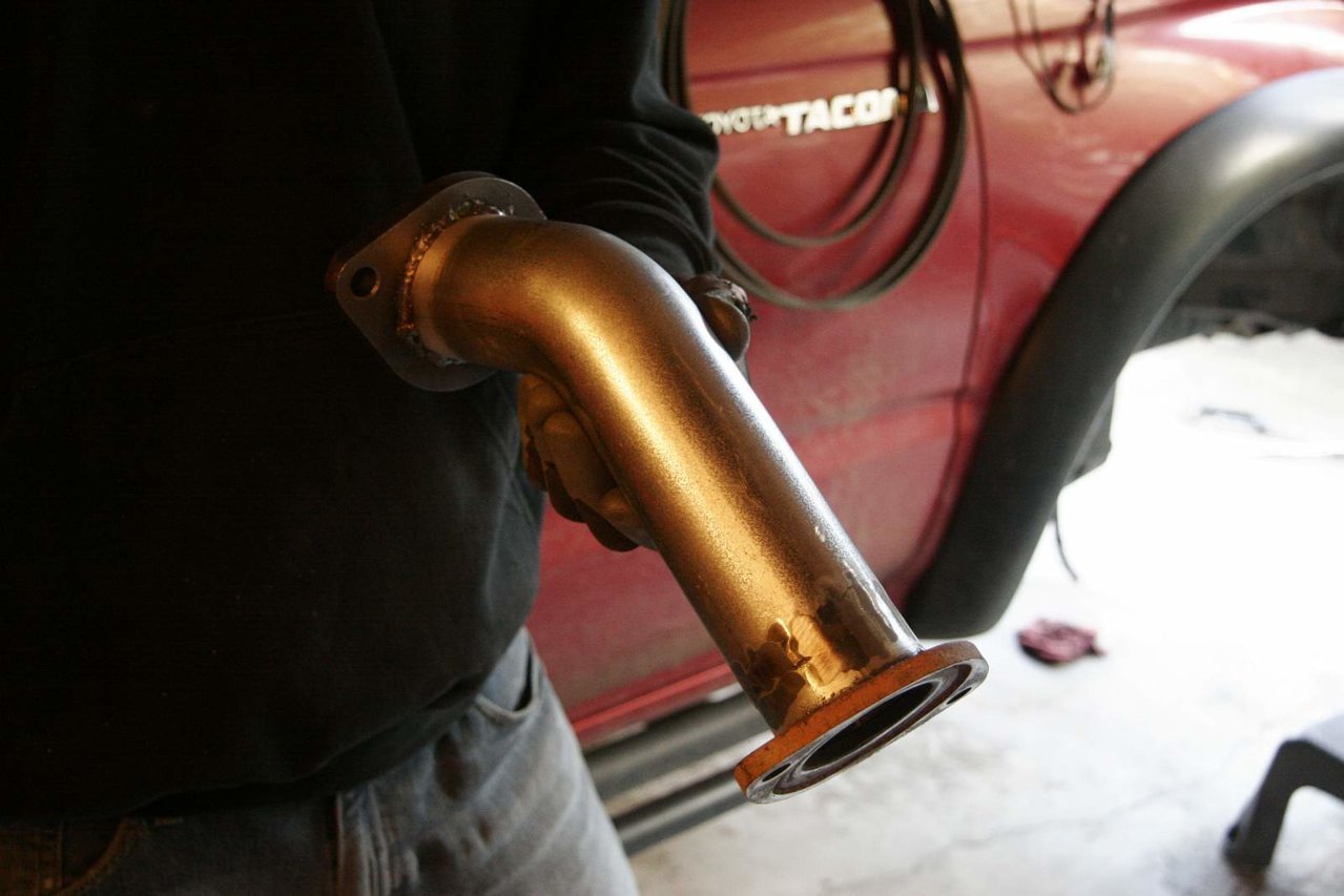

    As Dan mentioned we did the front CAT delete but it is not without consequences. The truck will now randomly throw a P0420 code. More annoying than anything. It is important to note that your exhaust note will change significantly too. It will be a lot louder and have deeper rumble than before without that front CAT. At least with my old magnaflow that is the case.
    The only thing from Summit that we used was that bent tube. The necessary flange came with the Thorley header kit. I did have to source an exhaust gasket from the local parts store.

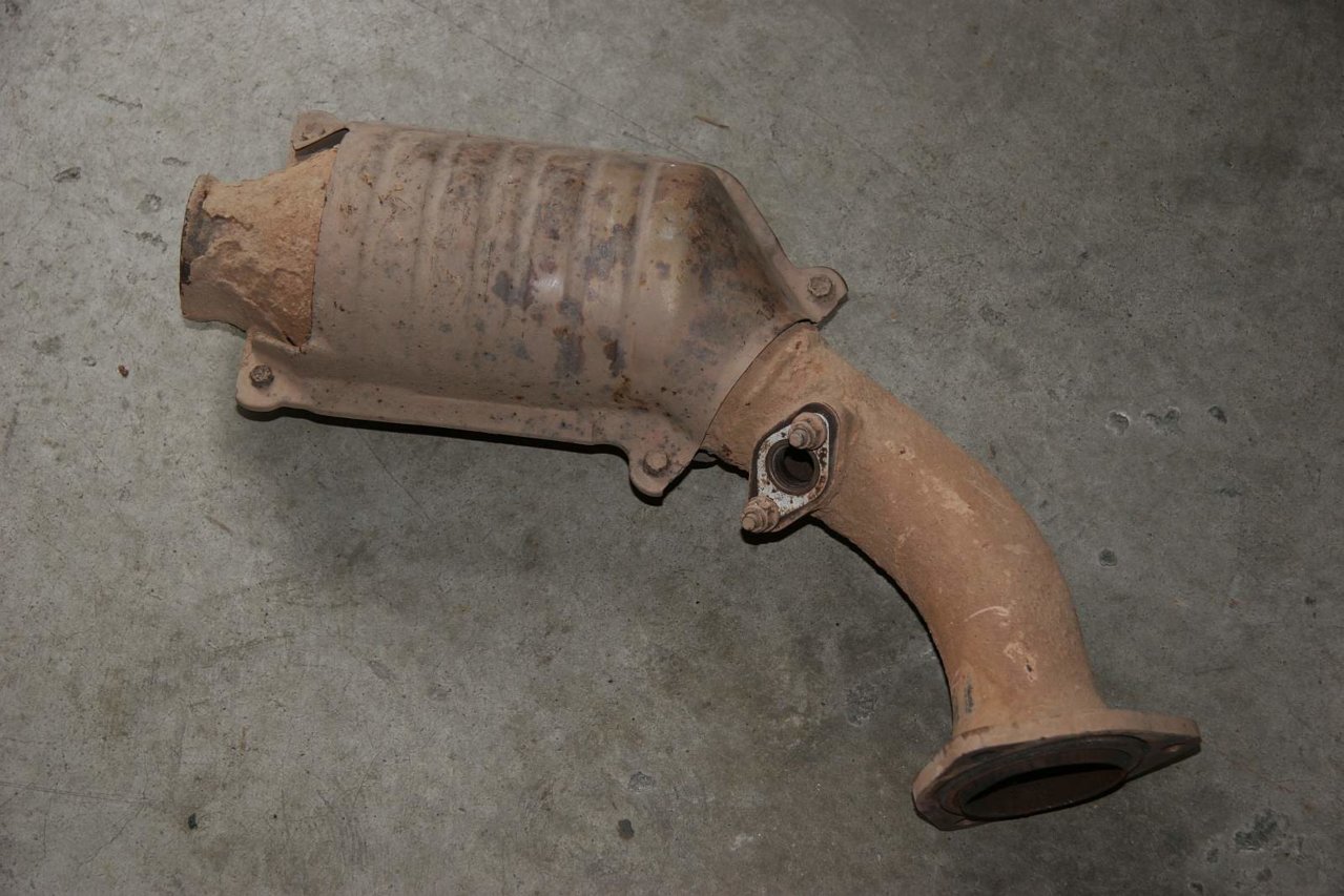

    Yeah, it looks like the TRD header terminates quite differently from the Thorley header.
    Here is what we cut off:
    Hence the shape of the replacement section.

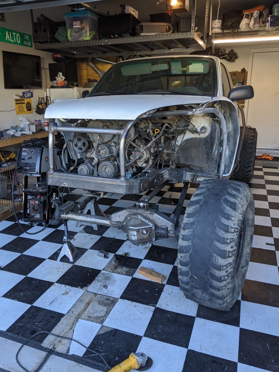

    Installed a radiator.
    Realized the crossmember was crooked.
    Fixed that.

    This might sound stupid to some, but if you feel comfortable separating the trans for this job I would recommend it. I was fortunate enough not to have a trans or spindles in the way, and it was still a relatively tough install. I did have a harder than normal time reinstalling my starter though. The TRD headers confine it a bit more than the factory manifold did.
