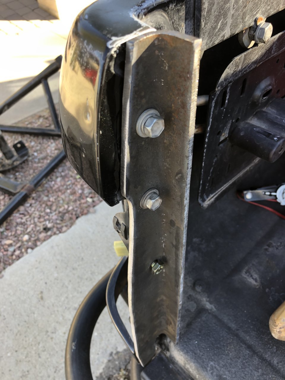

    Why isn't the strap flush to the bedside in the one photo? Looks like the bolts pulling out.

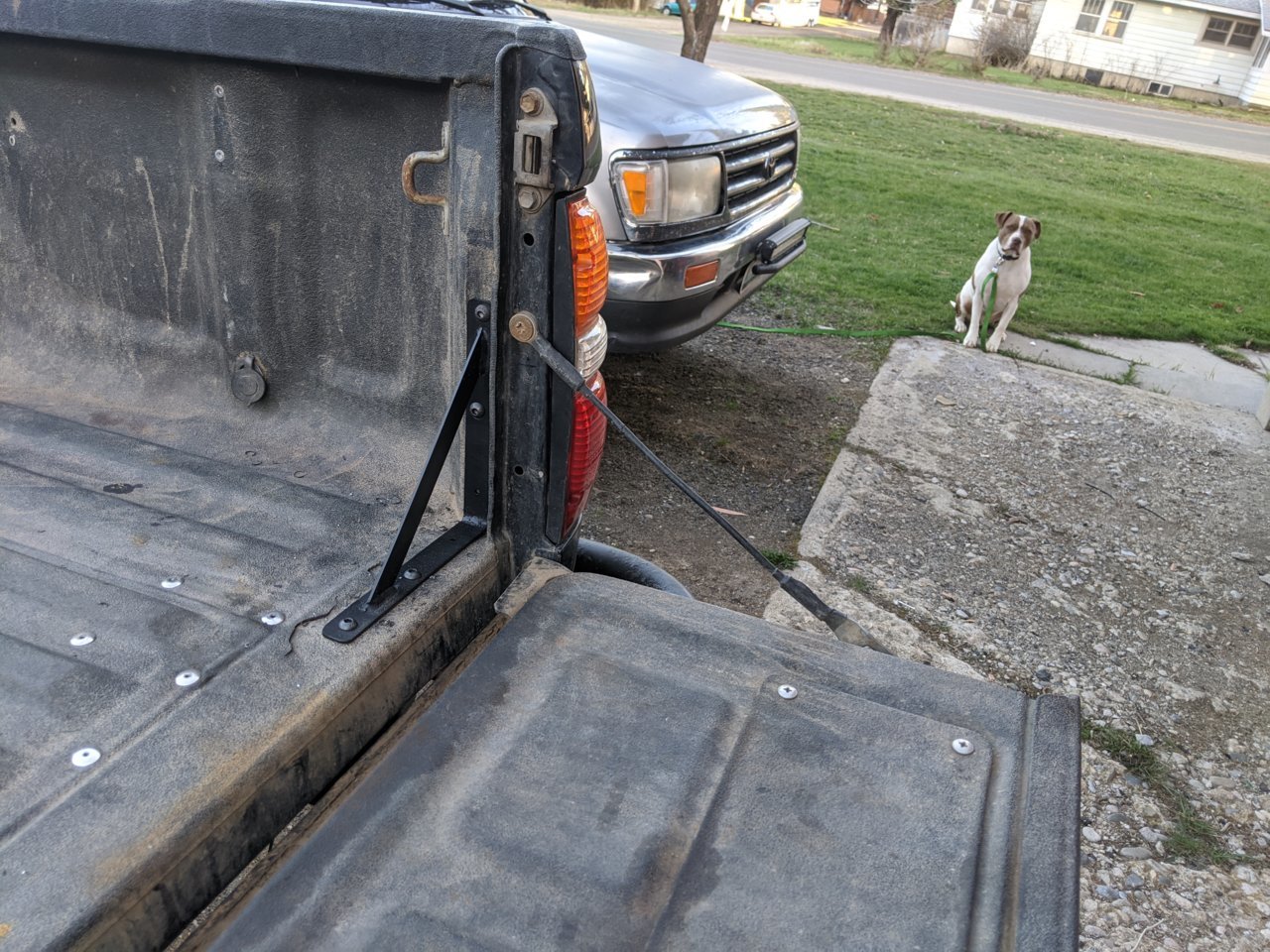

    I think if you have weight on your bed rails and do a fair bit of offroading the rear gussets will save the bed from cracking between the tailgate. I just made some this past weekend and wish I would have done it awhile ago. Always thought it was more a composite bed thing... IMG_20200428_194926.jpg IMG_20200428_195005.jpg IMG_20200428_194936.jpg

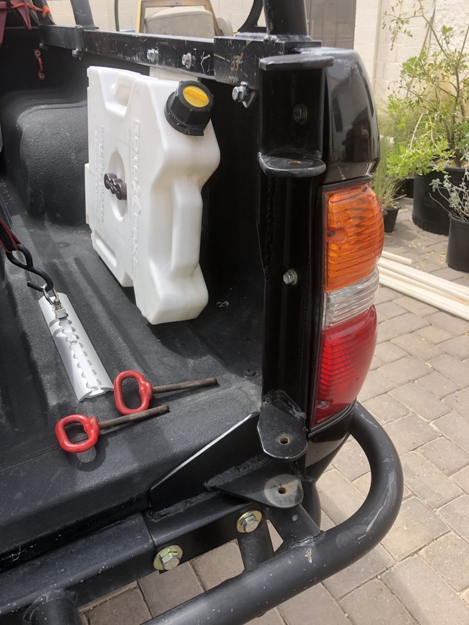

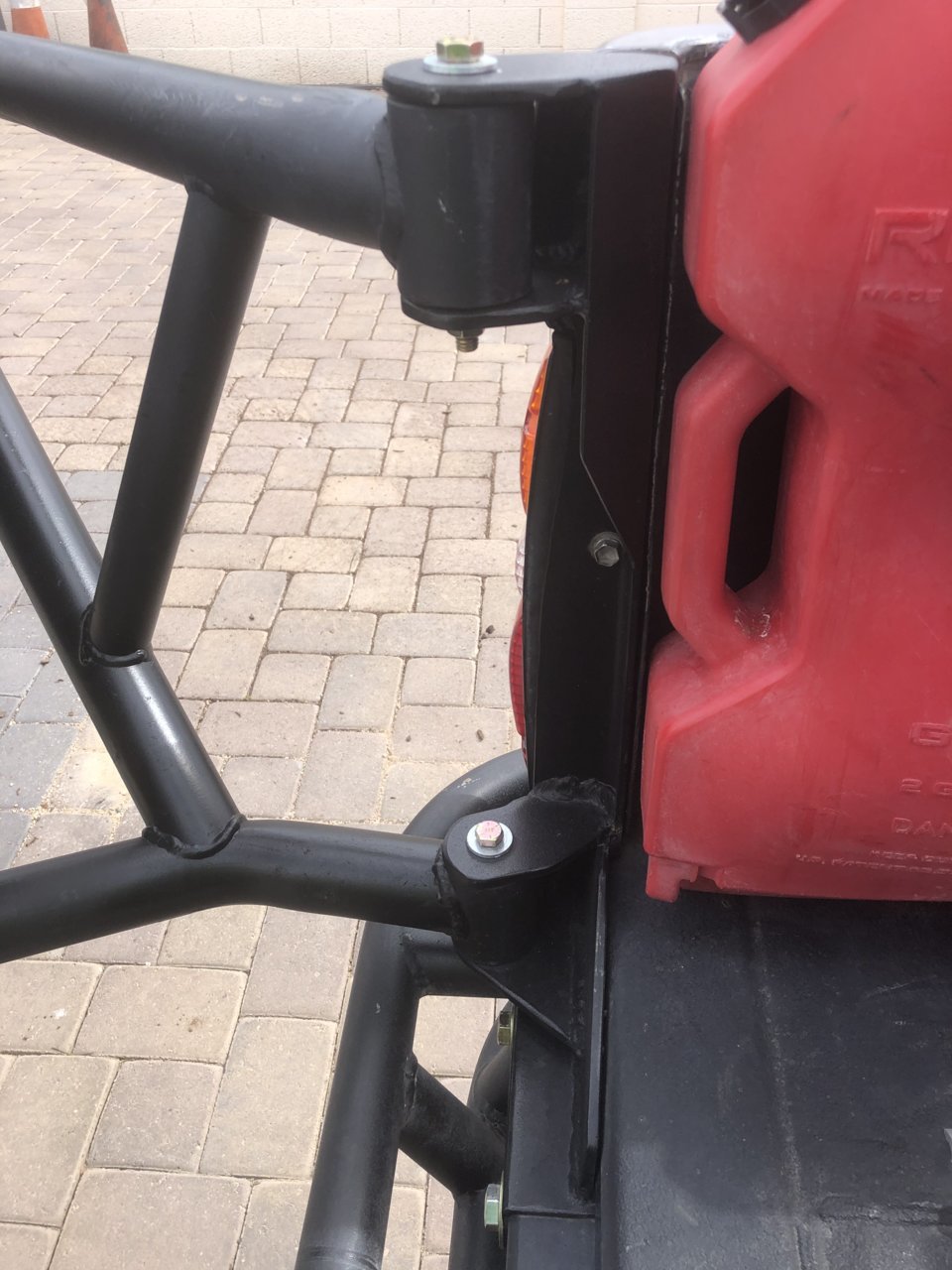

    I used angle on mine instead of plate like you did and its holding up fine after a few hundred miles and a few launches. I also did a gusset of sorts on the top side.

    not a link, i'll try to figure that out but here's a few pics. i unfortunately left some of the best pics out of the build thread.
