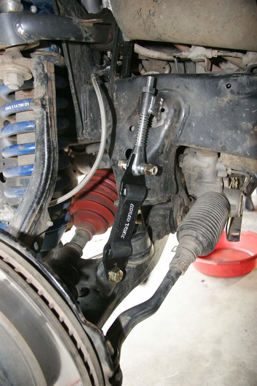

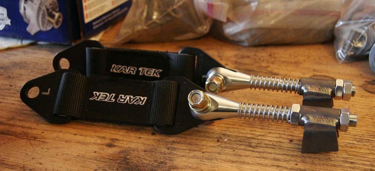

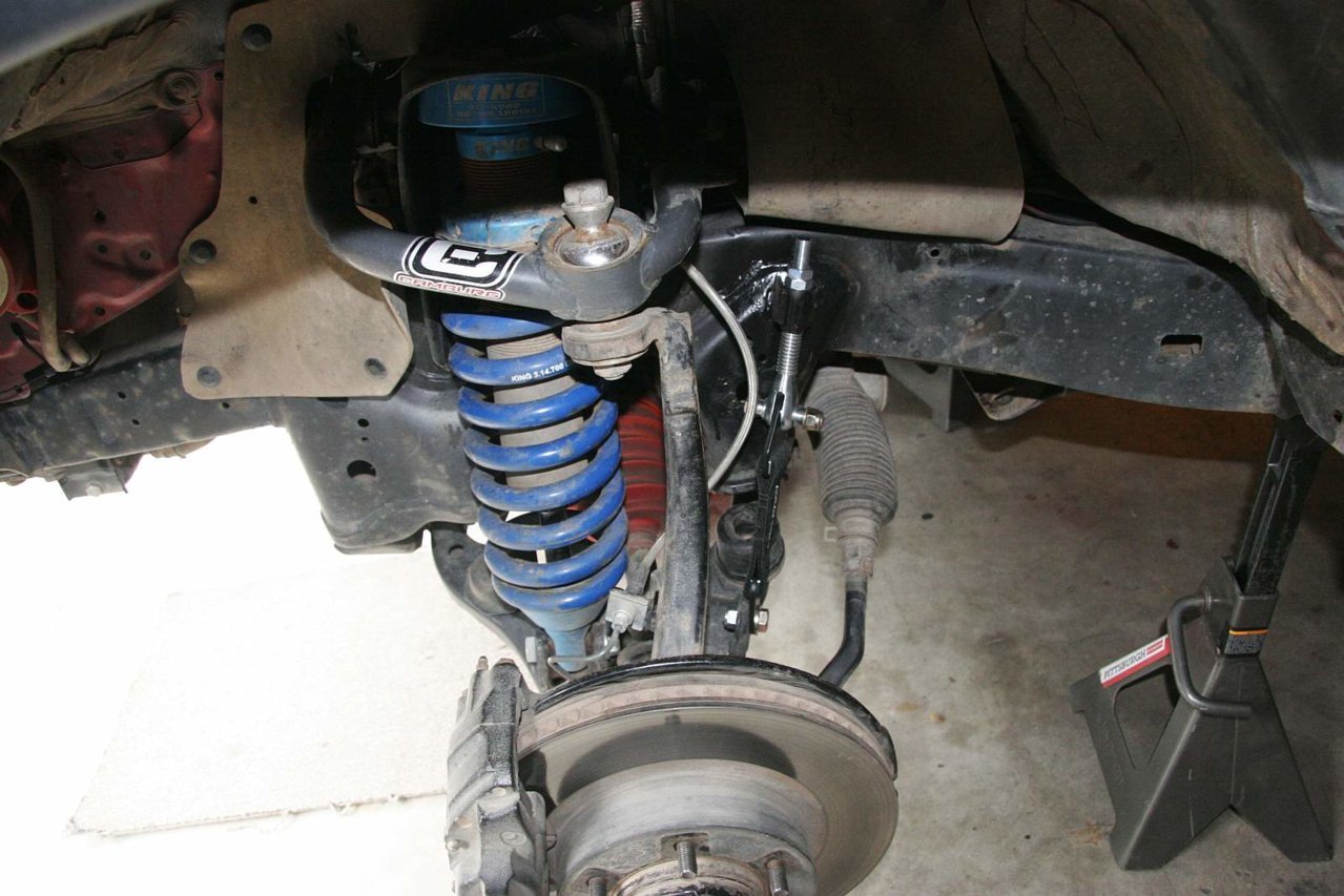

    Installed some limit straps today.

    Did you fix this nut situation prior to install?

    I'd double nut the top. Or it'll move and not do it's job.

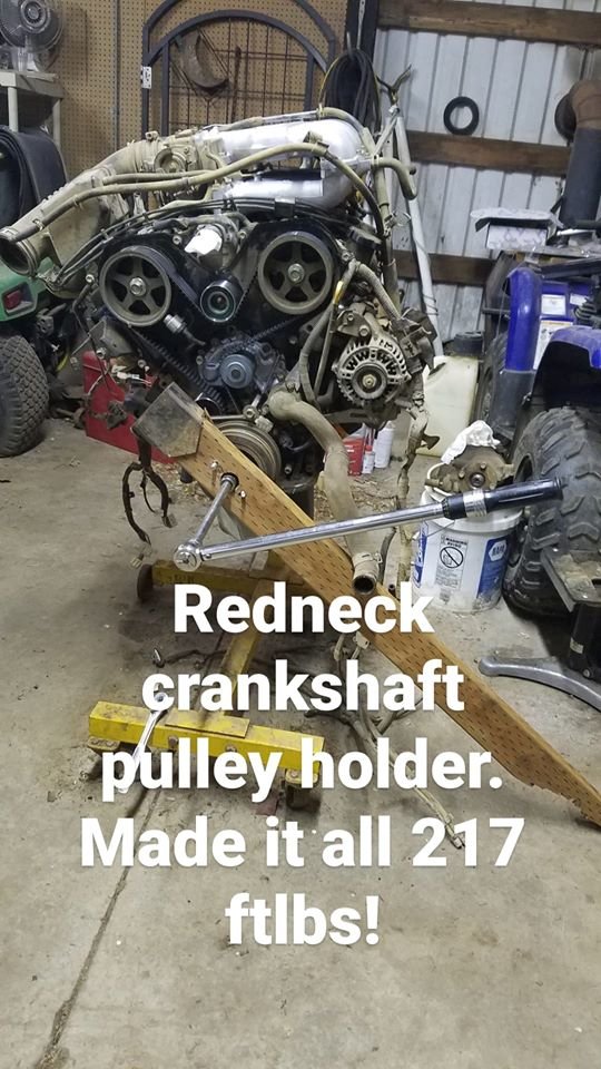

    A proper pulley tool was $50 and a 2 week shipping wait. Got 'er done for free and right now instead haha

    Yeah, fixed it.
    Yup.

    Keep an eye on the frame where you welded those. It's pretty thin, like less than 1/8"
    I welded my clevis mounts to as big a piece of 1/8" plate as I could fit there, and then welded the whole thing to the frame.

    Will do! Thanks.

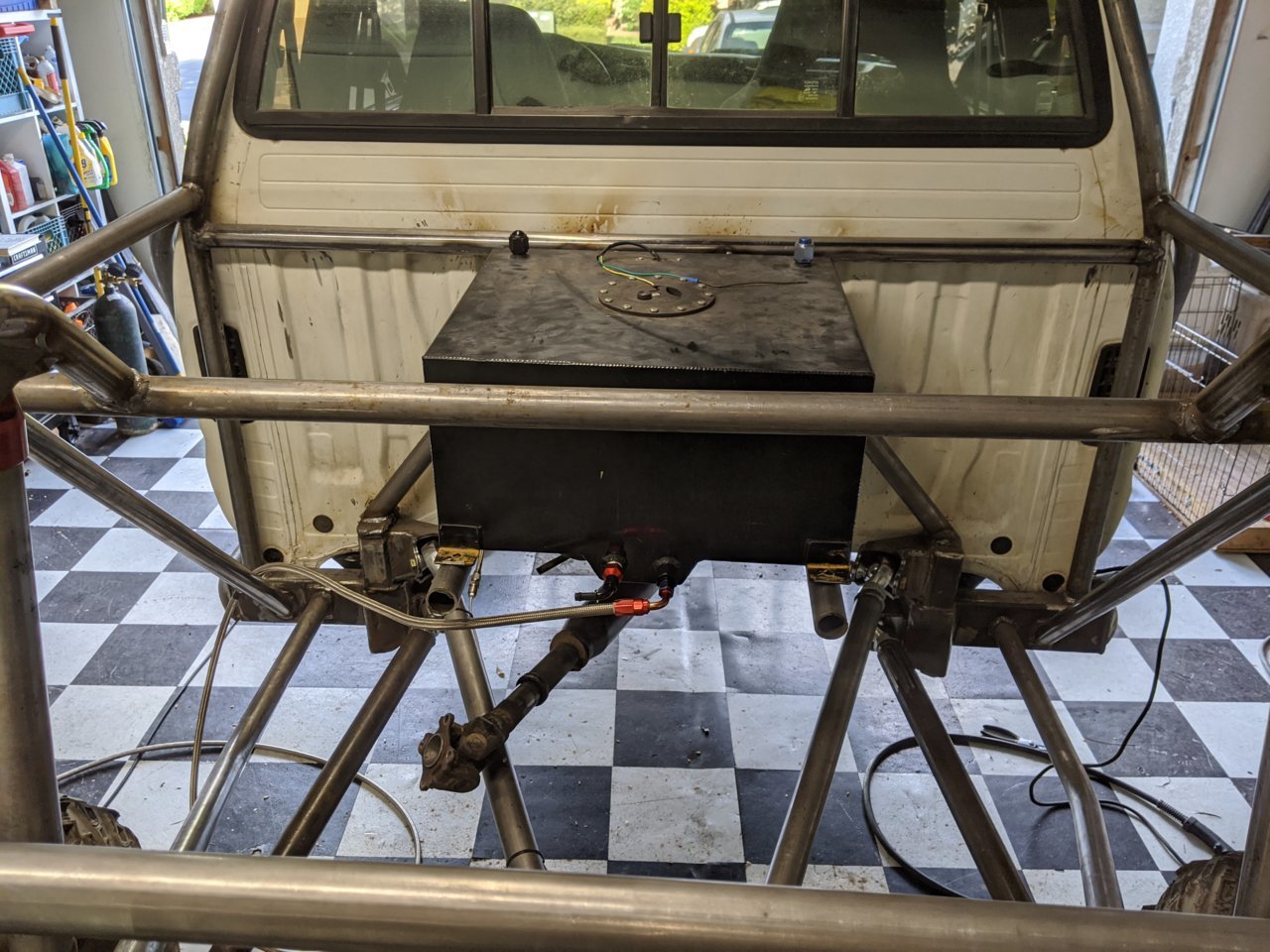

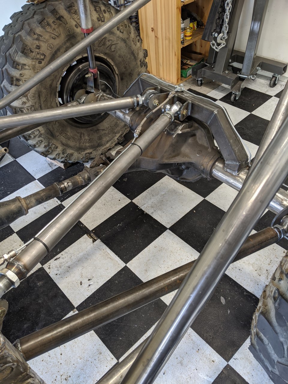

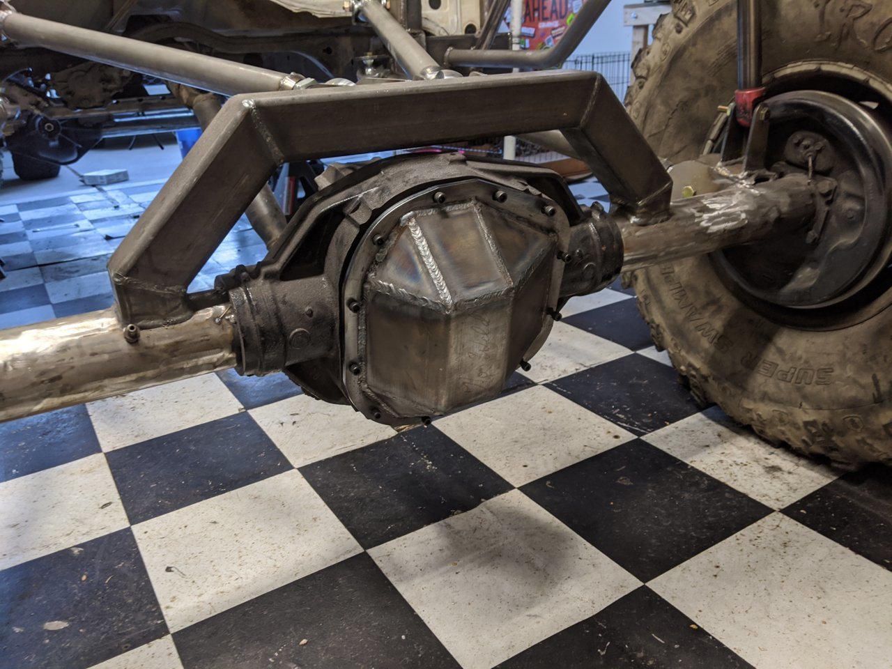

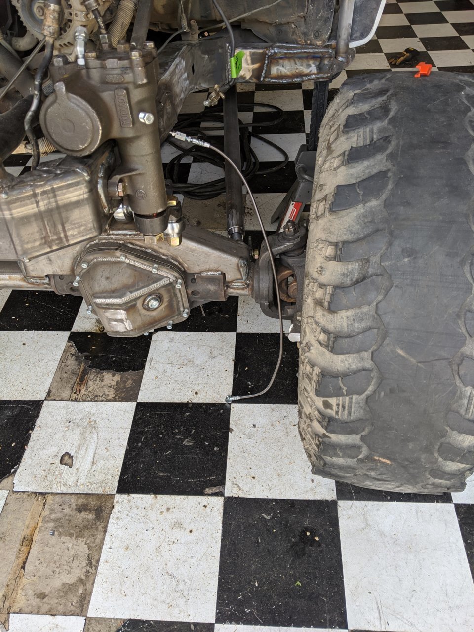

    Ran brake lines, finished diff cover, added some sections to the bed and half mounted fuel cell.
