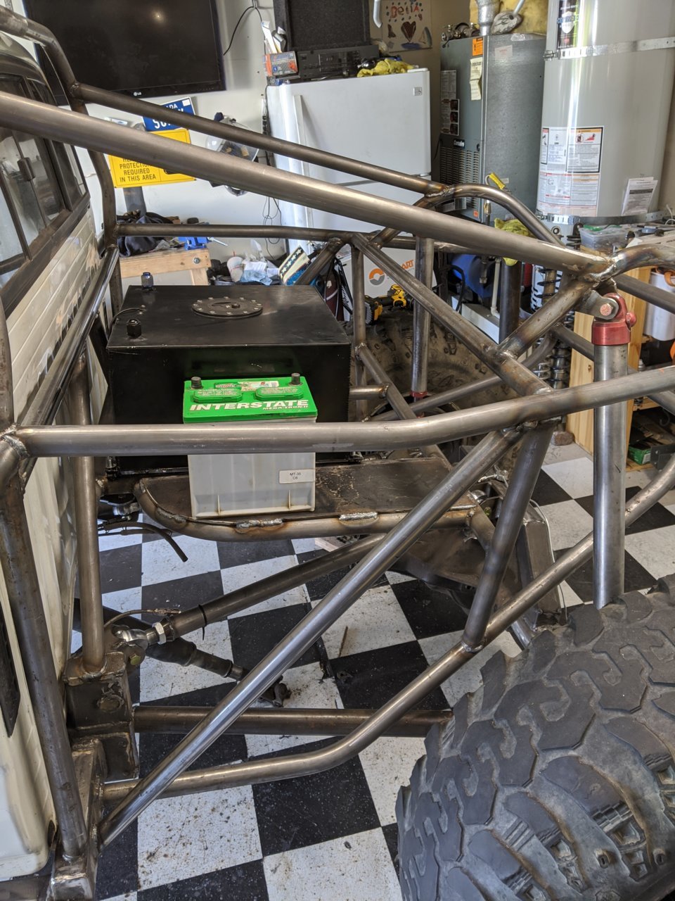

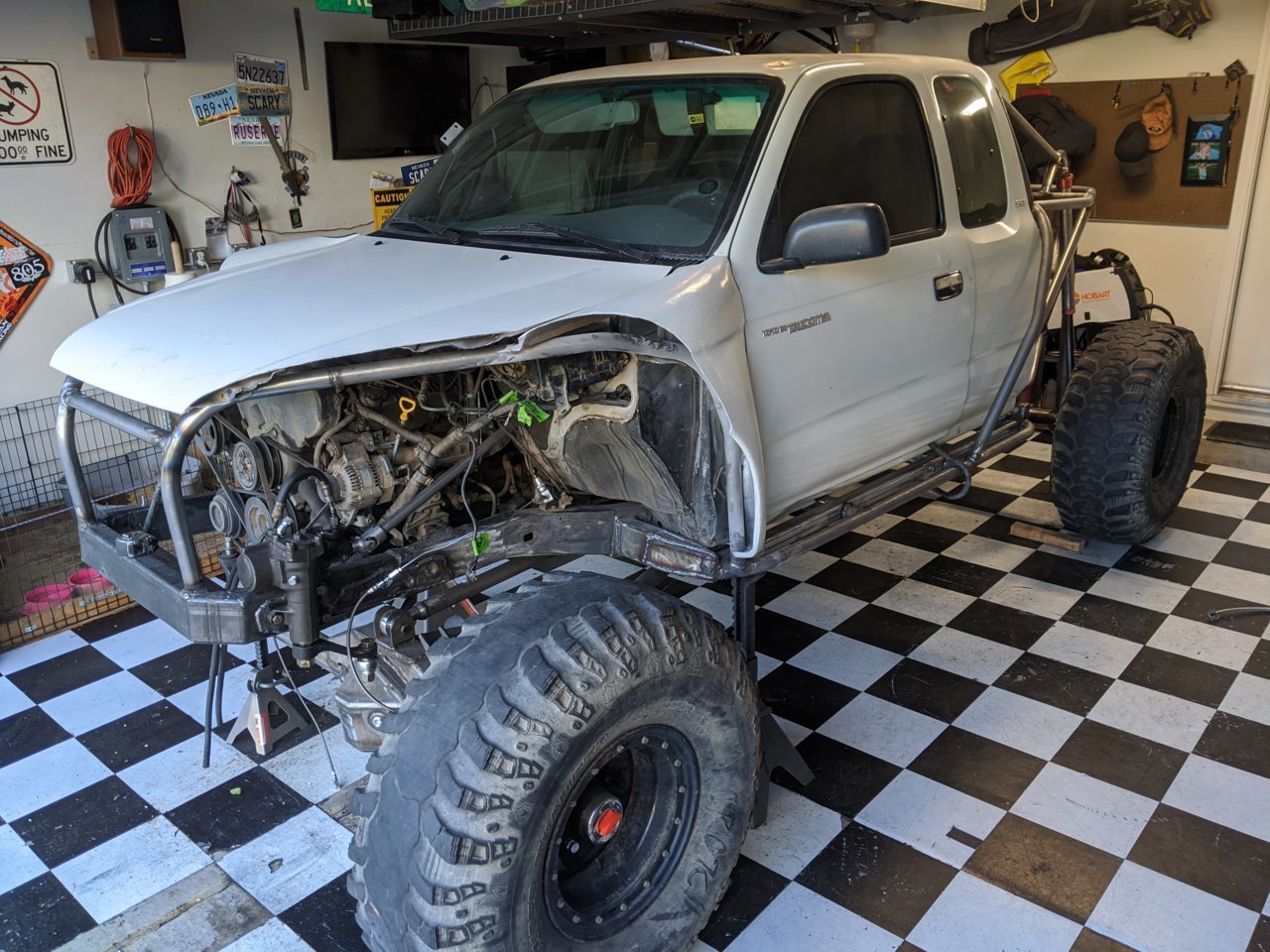

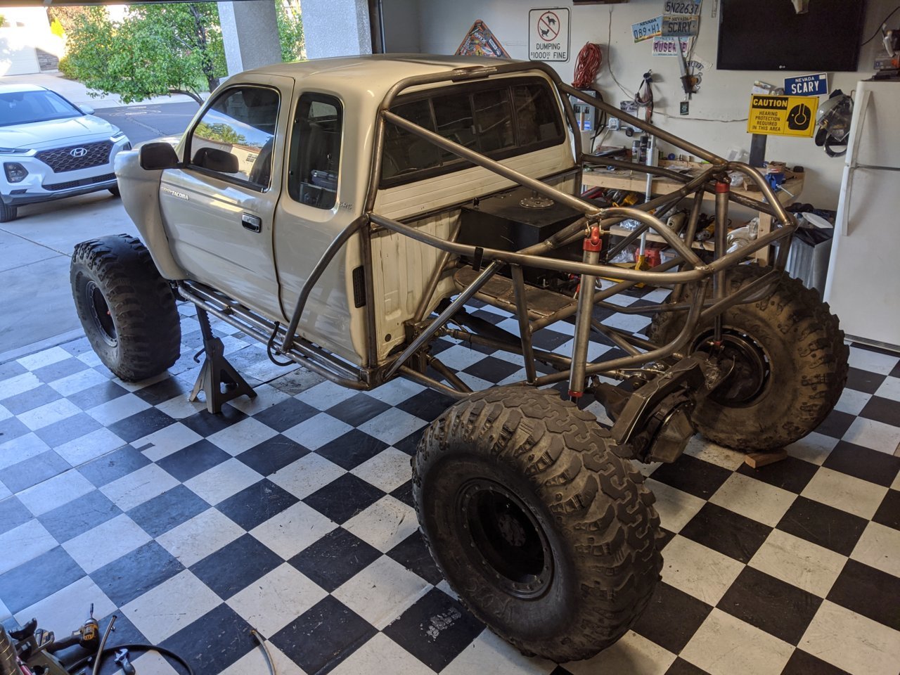

    Finished fuel cell mount, made a battery shelf, trying to come up with ideas for how to tie the battery down. Finished up the main tube work for the bed cage, then did runners from the main hoop to the shock hoops. Installed adjustable BPV, removed the old tank vent and second rear brake line. Whew!

    That thing is naaasty.

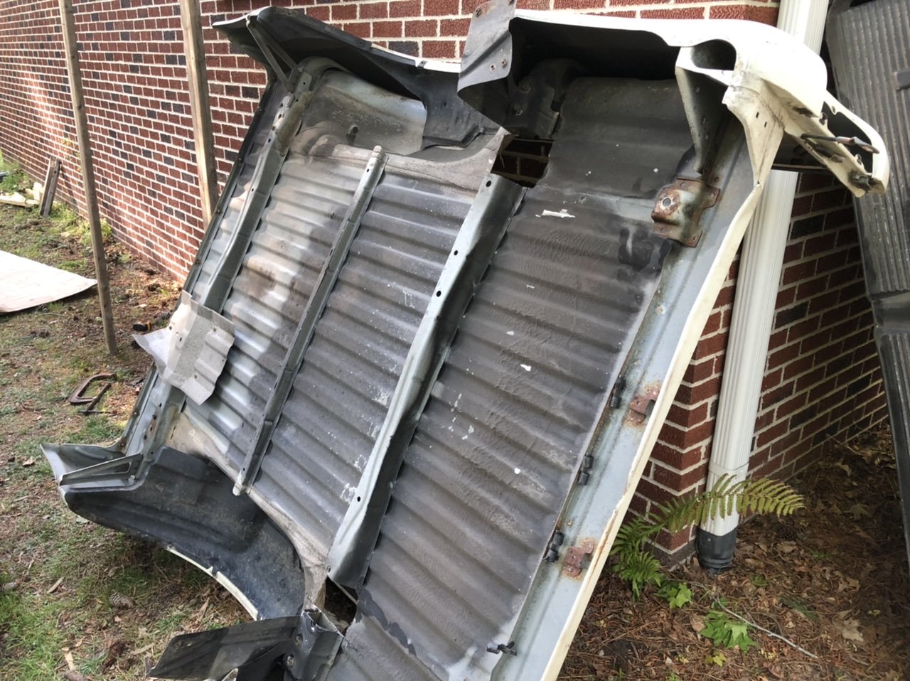

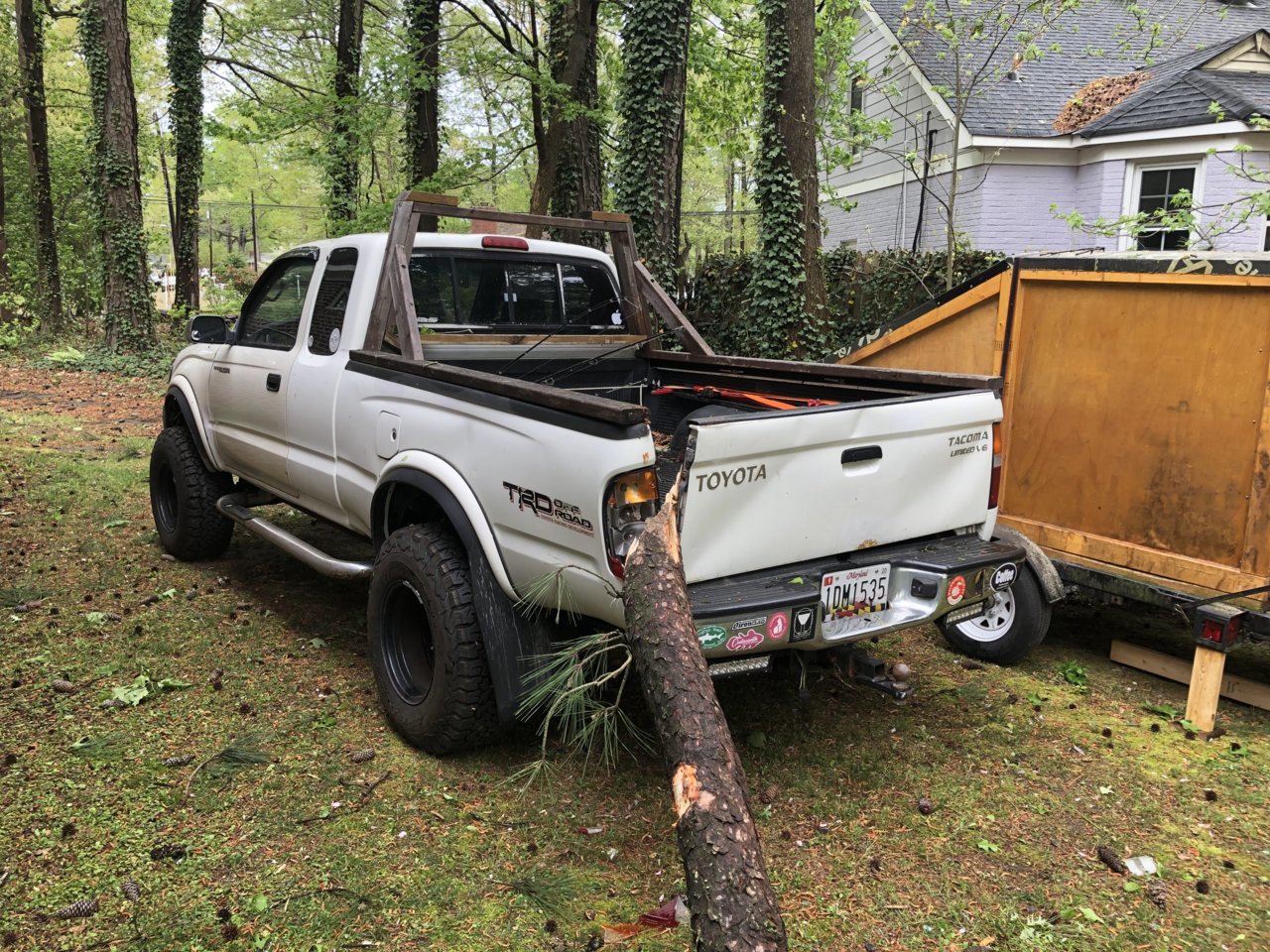

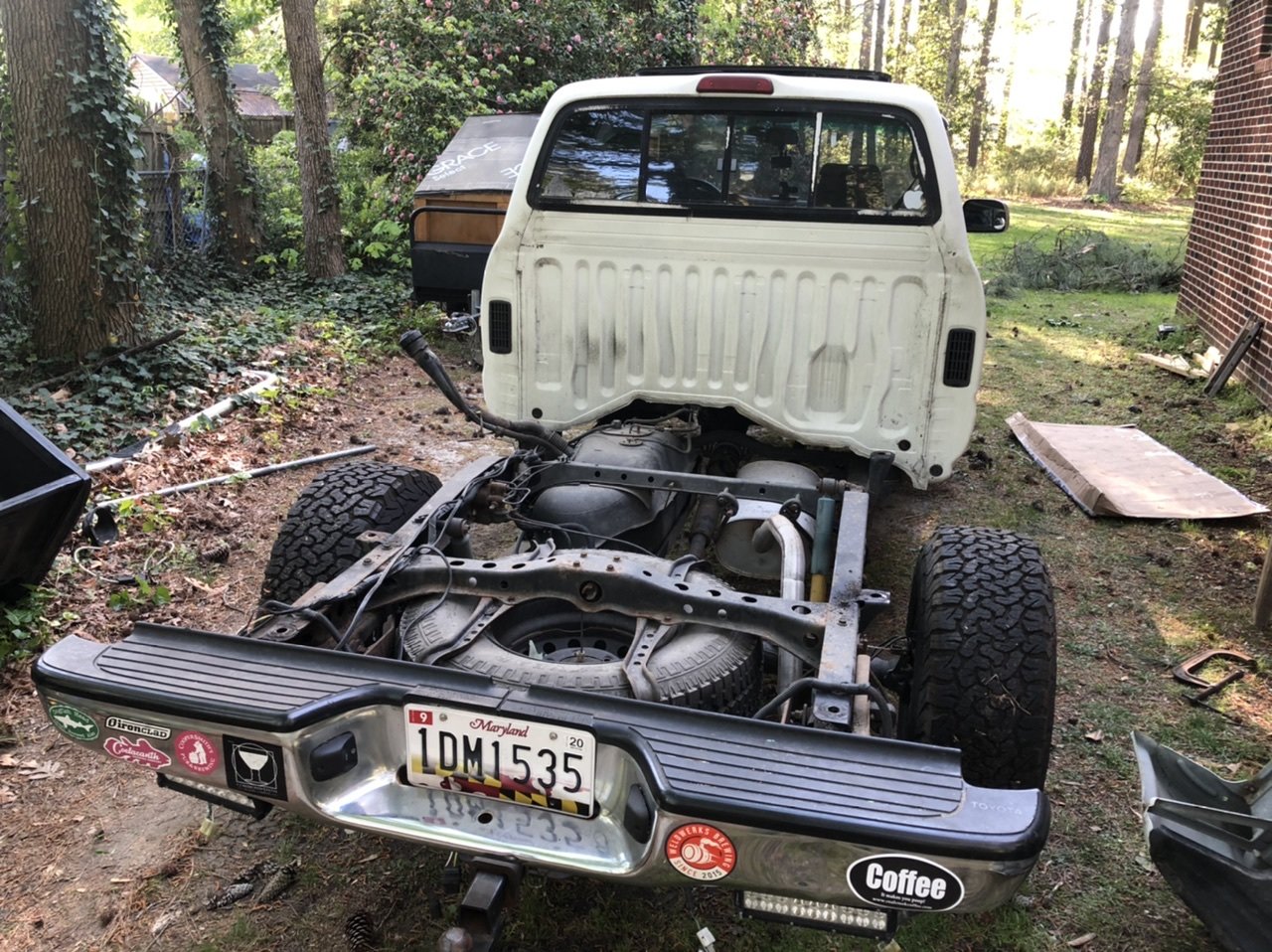

    First, in the beginning of April, this happened:
    So I decided to remove the bed and replace it after trying to bend it back into place. I figured that replacing the bed would be cheaper than body shop shenanigans anyhow:

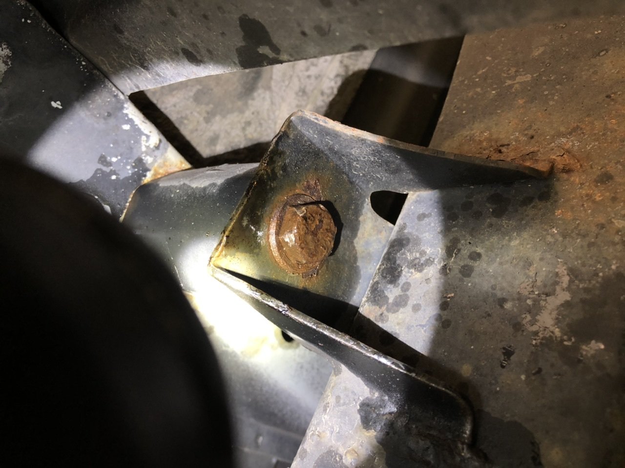

    Turns out that turning the bed bolts off would prove verrry difficult. I think half of the 6 came off mostly no problem, but 3 of them took most of the day at about two hours per bolt. That includes PB blaster treatment the day before and the morning of. But finally, the bolts all came out except for two that I just cut out of the old bed:

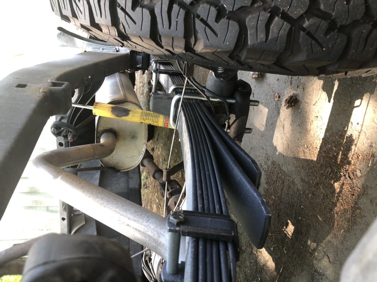

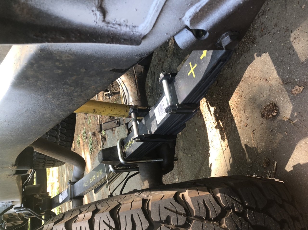

    I was going to wait until summer to do the leaf springs upgrade, but since the bed was off, a leaf upgrade would be much easier, so I replaced the very flat and worn out stock springs with OME CS046RA; CS046RB (with extra leafs):

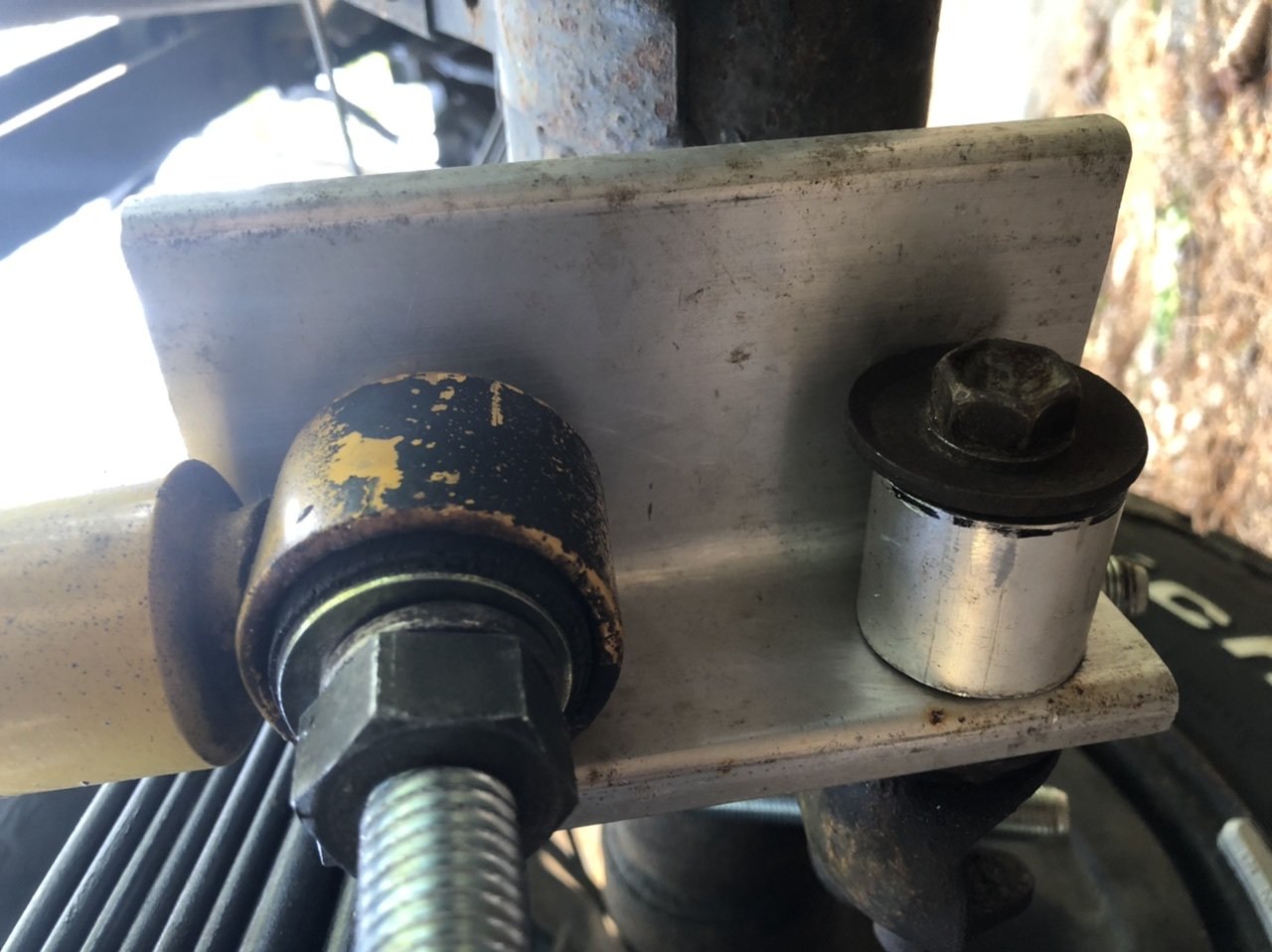

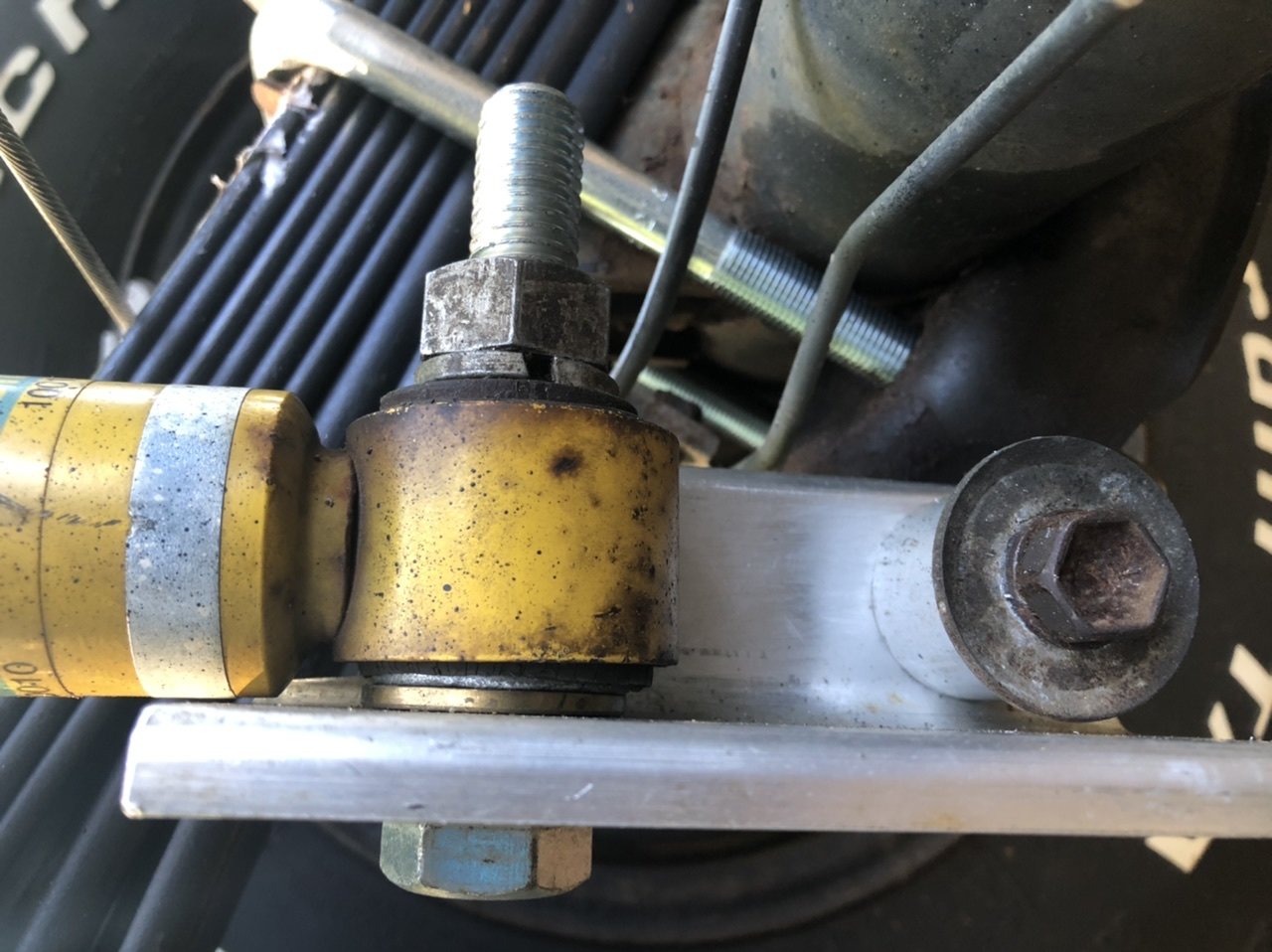

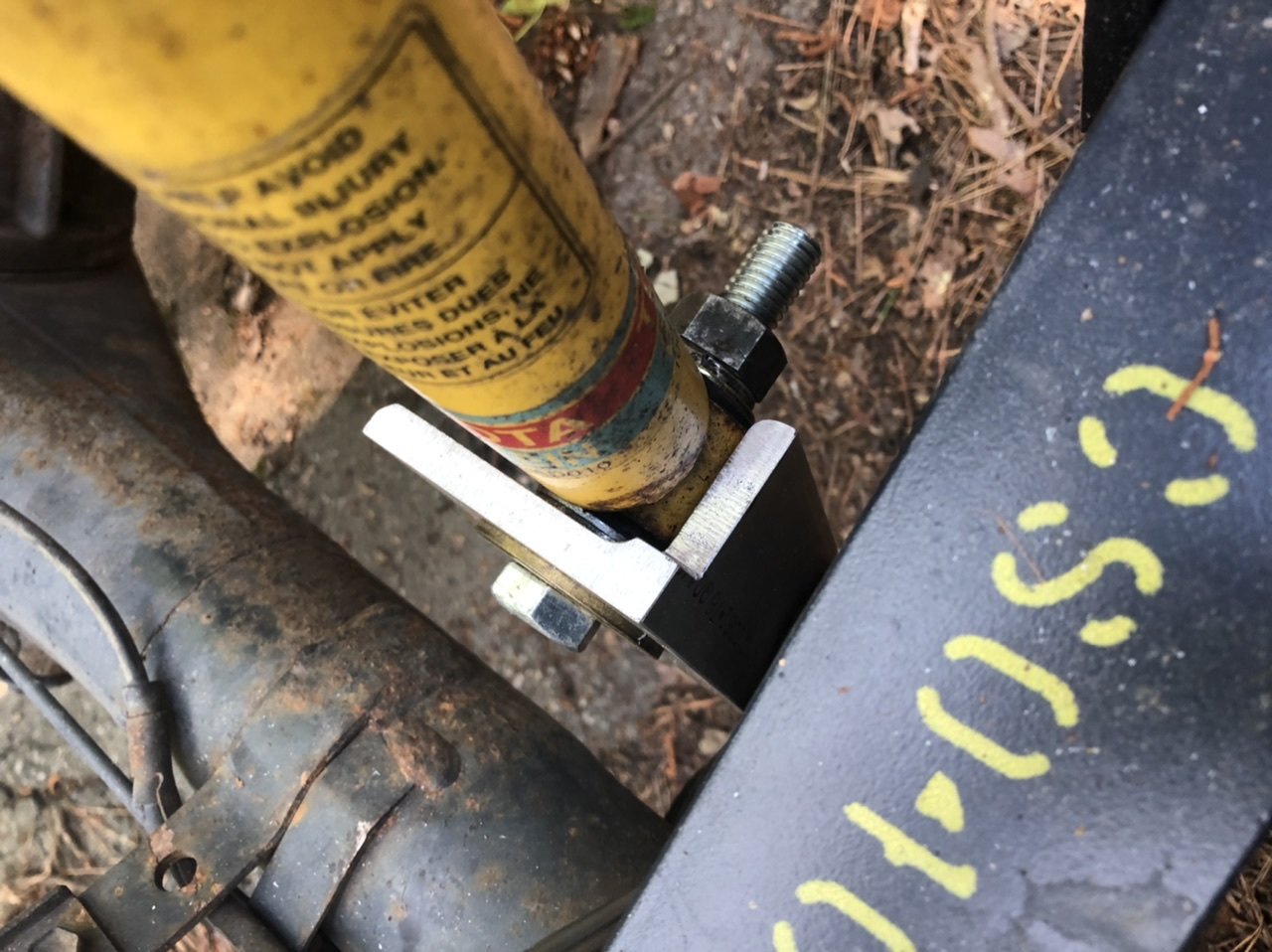

    Originally I had a 3 inch body lift, so the stock Bilsteins were good, but with the OME the lift is 2.5, needless to say the shocks were now too short. So I searched far and wide for shock extensions for the rear shocks, to no avail. I decided to try my hand at fabrication, this is what I came up with:
    It’s not permanent, it’s just there to get me by until I can get the 5100s for the rear.

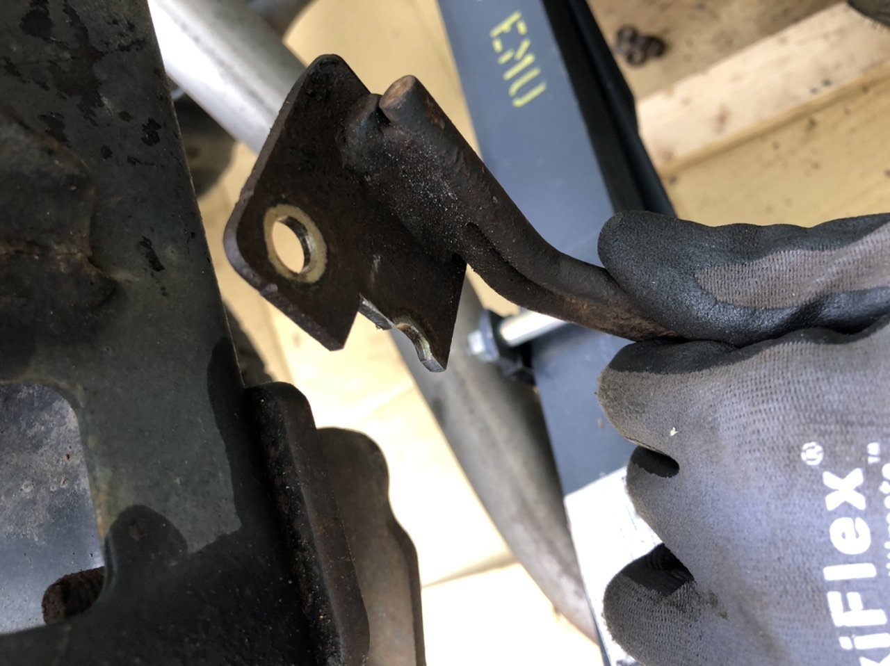

    Lastly, and it’s only minor, but the muffler hanger was too high and the new springs were in danger of smacking the muffler pipe in flexion, so I took the two bolts that were holding it on out and dropped the bracket to just one bolt holding it:

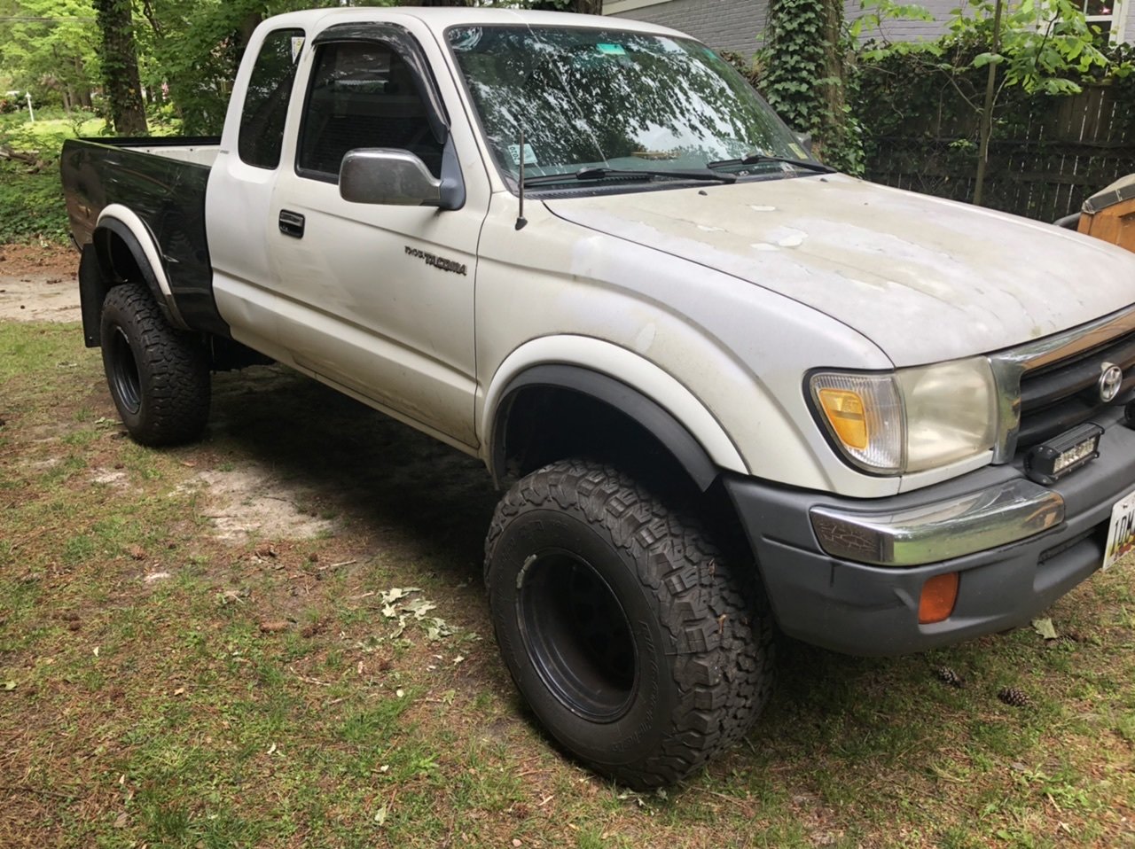

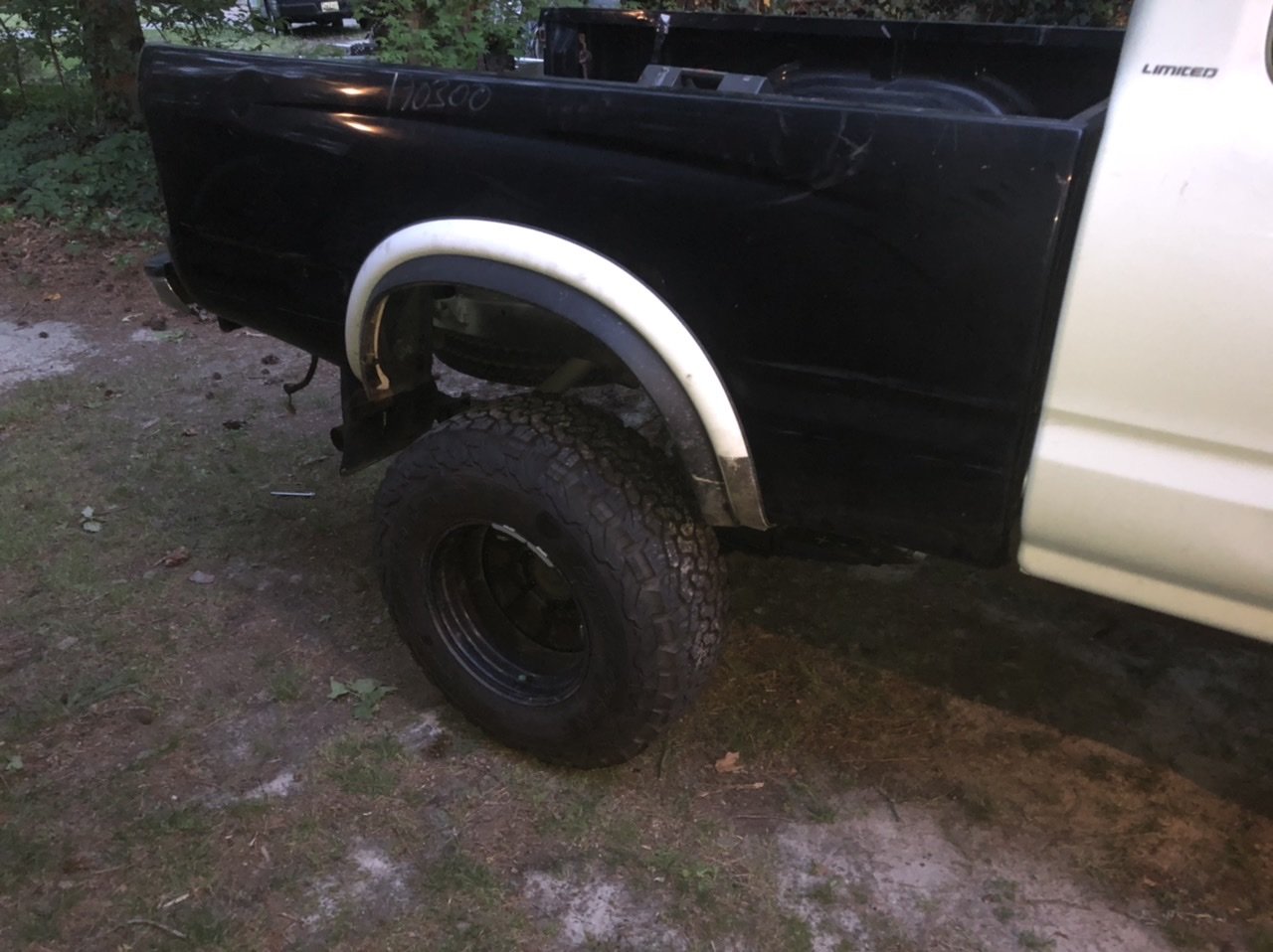

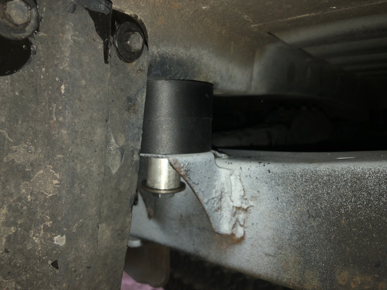

    I pretty much finished all I can do at this point... a buddy came by and we socially distanced putting the bed back on and shortening the gas fill tube... instead of putting the 3 inch body lift blocks back in I decided to go with 2” plus the 2+ inches the OME give me... it looks a little funny with the front being lower than the rear, but it’s good for now:
    I have that extra bit underneath because my bolts are 4” bolts and I needed a way to make up the rest of the length. It’s just a piece of 1” aluminum tube.
    Here’s the ‘finished’ product... ‘cause I’m never really going to be finished...
    it’s around 4” of lift, any lower and the bed wouldn’t match the cab at all and it would just look even more off. It’s a compromise to have it just an inch lower.
    I like the black and white, but I think I’m gonna paint it all black.

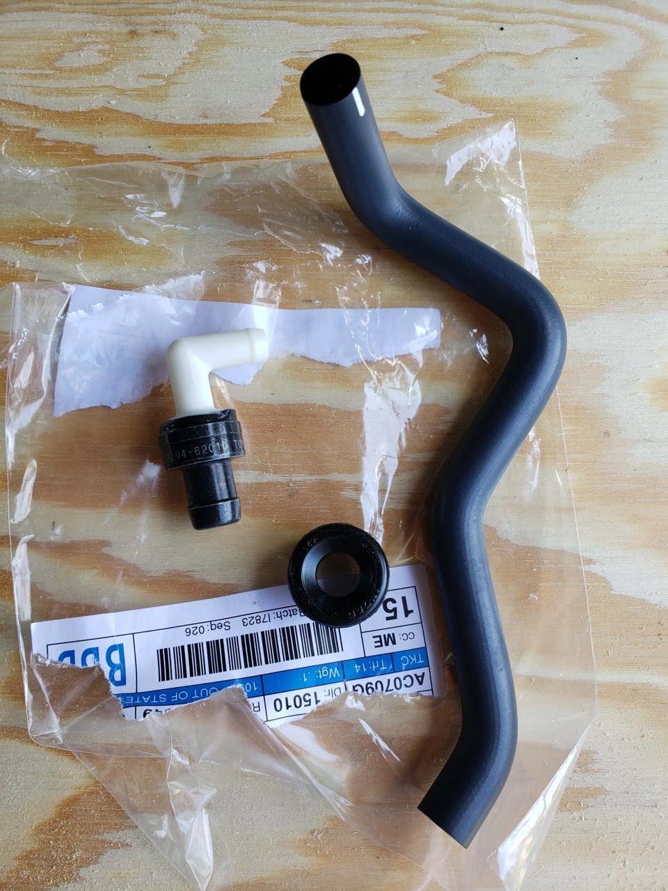

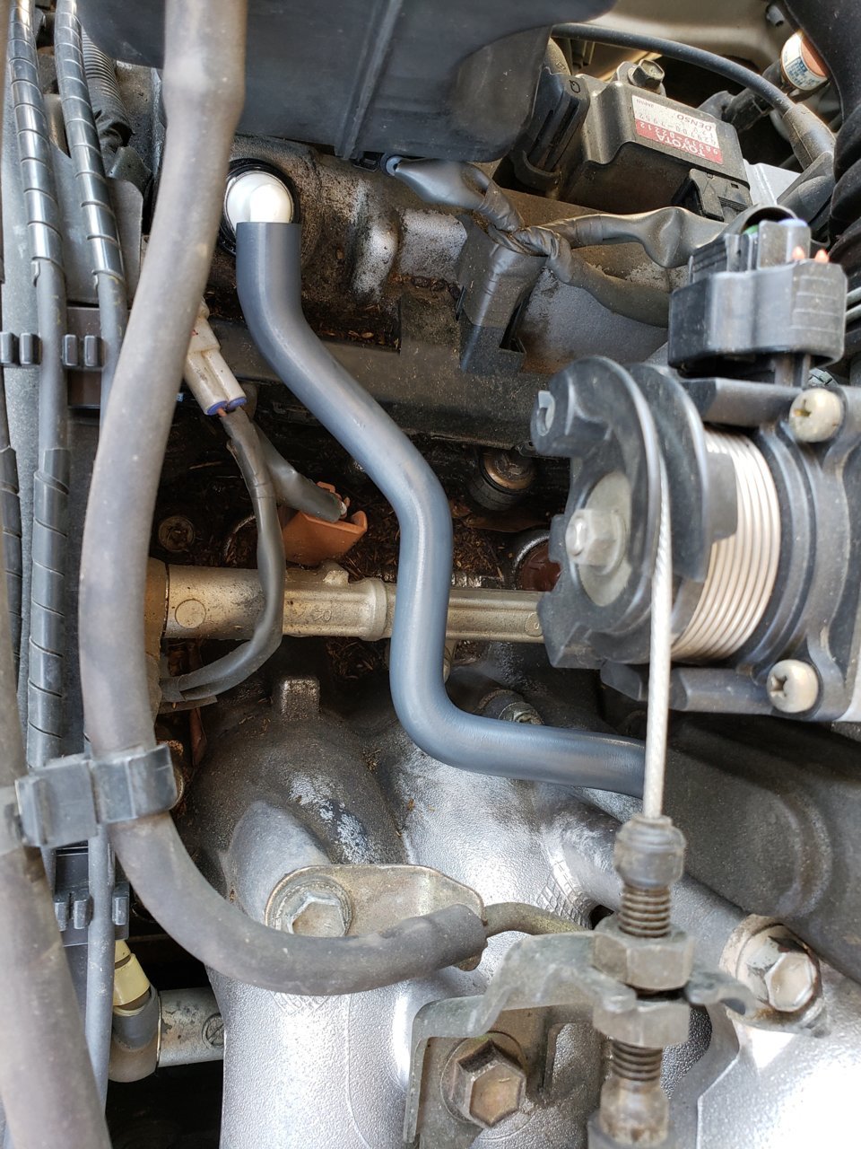

    It's the little things that get ya...
    Before
    After
    Installed
