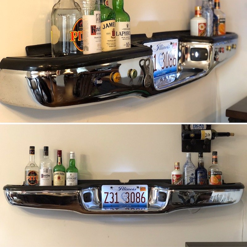

    Finally a good use for a chrome bumper!!!
    Cheers!!!

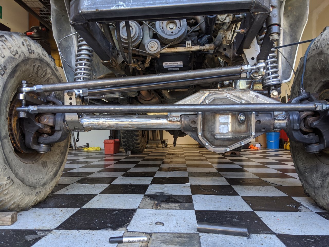

    Steering and panhard!

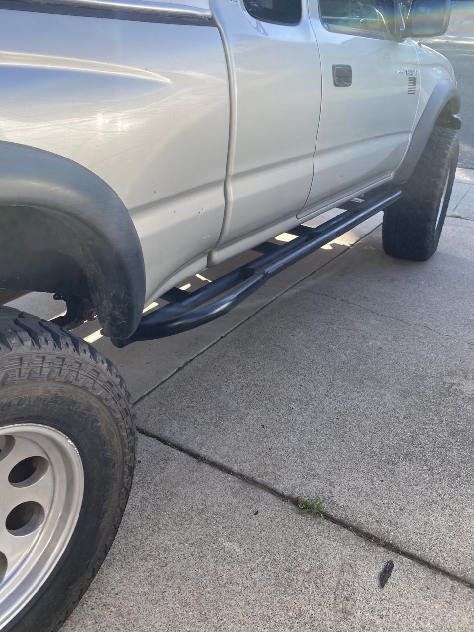

    Hit the rust spots, scraps and scratches with a wire wheel and gave the sliders some fresh paint to scrap back off this year.F7FE1AB7-B75F-4895-B4C3-7B9CAEAD17FD.jpg

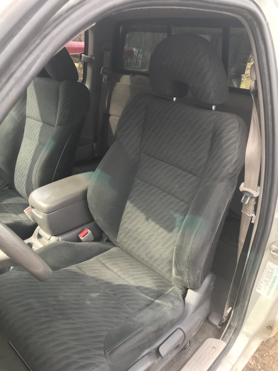

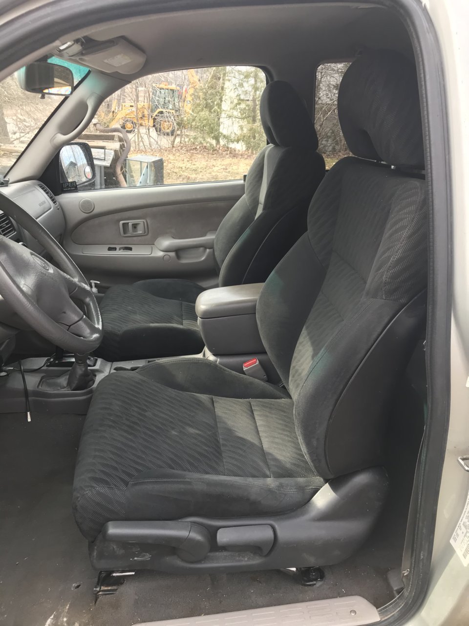

    They’re from an 09 civic coupe I found at the scrap yard. To get them to fit I had to cut the feet off of the old tracks and had a buddy weld them on to the new seat tracks. I think only one of the feet from the civic seats lined up with a stock bolt location.
    They sit a little higher than stock but it’s a night and day difference in comfort. I just spent ~12hrs in it driving and could actually walk afterwards!

    Thats a 400 dollar bumper in hawaii :eek:

    Really?! Damn, the bumper couldn't even get me $80 around here. Should have explored more options.

    Ayy looks wicked good. How's the rear seat access? I figure they don't flip forward as well as stock(?)
    I would love to swap seats. My 60/40 bench is in fine condition (other than a few burn holes:rasta:) but i don't want to lose the folding factor. I remember someone brainstorming on using sienna backseats that totally collapse and I loved that idea. I feel like 2nd gen access cab seats fold flat, and that would be wicked nice to have as I use the backseat a lot.
    Anyways great work!

    When I did my WRX seats I didn't think about that aspect, it makes doing anything in the back area a bitch.

    I think you'd be alright if you use seats from a coupe. They will fold forward so that people can people can climb into the back. I was looking at doing a similar swap with 7th gen Civic seats, but I don't trust myself to weld on seats brackets just yet.

    Good point on coupe seats! Before I go buying anything I want to check out the sienna option, esp if there's one at my mechanic/junkyard. It's a great thing to have a 2 in 1.
